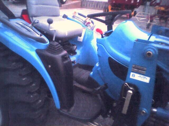

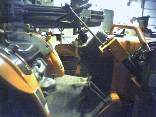

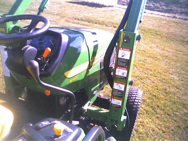

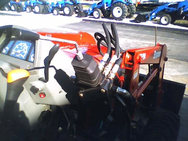

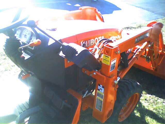

One thing I didn't care for on the Kubotas was the location of the loader control. It seemed more natural to use the controls that were placed on the right side of the driver, rather than on the loader arm. I have never used either, so I guess I will get used to whatever I buy.
Does anyone have any advice on possible advantages/disadvantages of the loader control placement?

I've used both types, and both of the tractors I currently use have loader mount levers (Kubota B2910 and New Holland TC24D). You get used to what you have. But I will say that if you work in the woods with lots of low branches, there are SOME loader controls mounted on the loader frame that have hoses that stick up and those hoses can be caught by a branch.
Photo #1 below shows a Branson tractor control valve, you can clearly see the hoses stick up and are targets for wayward branches.
Photo #2 below shows a Kubota B7800 control valve, you will notice the hoses are not nearly as exposed and are far better protected.
Photo #3 below shows a Kubota B3030 control valve, again the hoses are protected from branches.
Photo #4 below shows a New Holland TC33DA control valve, it is fender mounted, there are absolutely no exposed hoses.
Photo #5 below shows a JD 3410 control valve, as with the above NH, it is fender mounted, there are no exposed hoses as they run pretty tight along the loader frame/arms.

So you can see from the photos that there are some subtle differences. I have no problem with using either type, both of what I use now are loader mounted valves and both have protected hoses. That is the one feature I would really look for because you never know when a tree is going to reach out and grab part of your tractor :) Then again, I have a lot of trees so it is something I am wary of on a daily basis. I also strongly prefer rigid pipe along my loader arms and across the loader cross brace instead of hose. Pipe costs a bit more but is more durable, not subject to rot, not subject to bursting, not subject to snags or tears by thorn trees, etc.
On every tractor there are probably 100 little differences. Some of them make a big difference to some people and absolutely no difference to others. The key is to figure out what is best for you.
