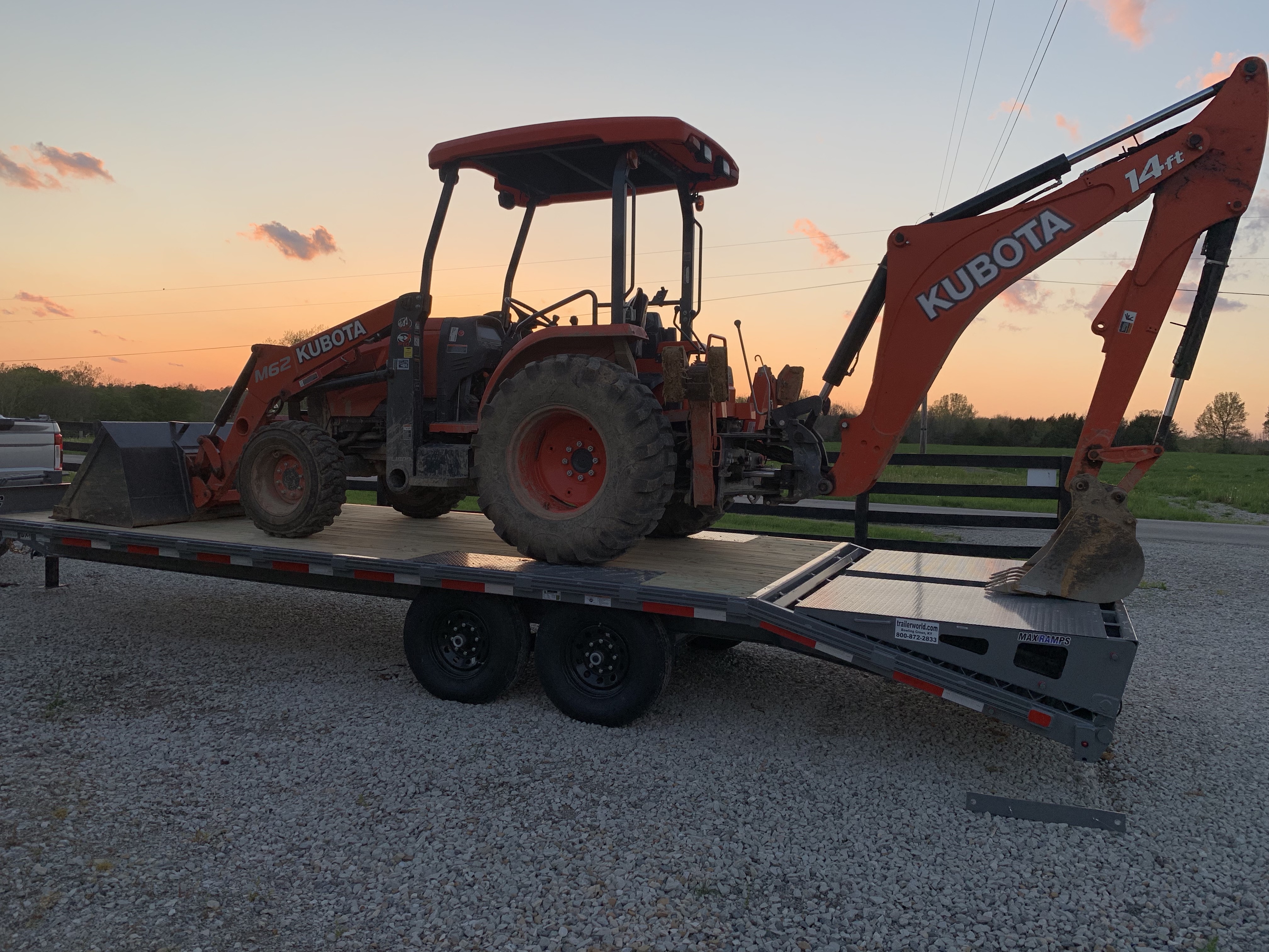

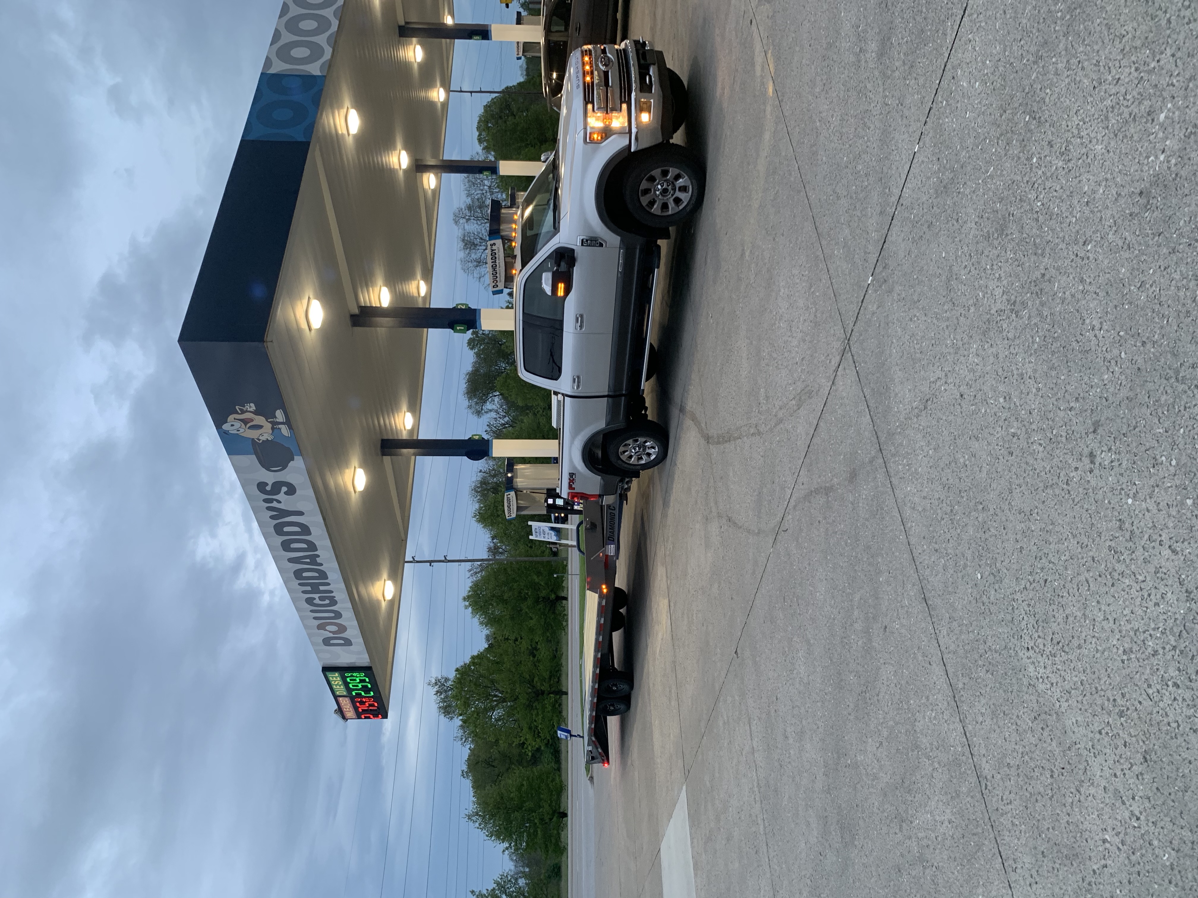

This is what I ended going with. Drug 250 miles home, pulls great, smooth even at 80. Has the equipment style paint, not powder coated. Sealed harness. 14900 payload, getting reduced to 14.5.
Love how this website jumbles up pictures and inserts gibberish characters. I guess pics are oriented correctly if you click on them and open them up.

Good looking rig!
   / Deciding between 14k sure trac 22 tilt vs 15k 25+5 deck over dove tail w/mega ramps #14
So 7k or 8k axles?

Are you only pulling the M62 no loaded tires, no backhoe? I did all the weights on mine and I am at almost 12k with loaded rears and the backhoe.
Personally I would not go under 18k on a trailer with this machine, just in case you need to pull with the BH.
12k?? surely your loaded tires dont weigh 3k.
Even with the m58 I owned and used for construction since 2010 I have never once needed any extra weight.
Ive pulled the m58 and the m62 since 2010 with a 14k trailer... probably more than 50k miles, maybe more. M62 is a 9000lb machine, trailer has payload capacity of 10900.
On a side note, some 16k plus trailers have less payload capacity than some 14k trailers. I thought that was interesting. One of the reasons I went with this trailer instead of one with 8k axles. Some manufactures overbuild trailers absolutely killing payload. Thats where engineering comes in.
What specific trailer do you have?
The bottom of the link has the weight listed.
https://www.kubotausa.com/docs/default-source/product-comparison-pdfs/m62_comps.pdf?sfvrsn=4490a207_2

7k, 10900 payload.
