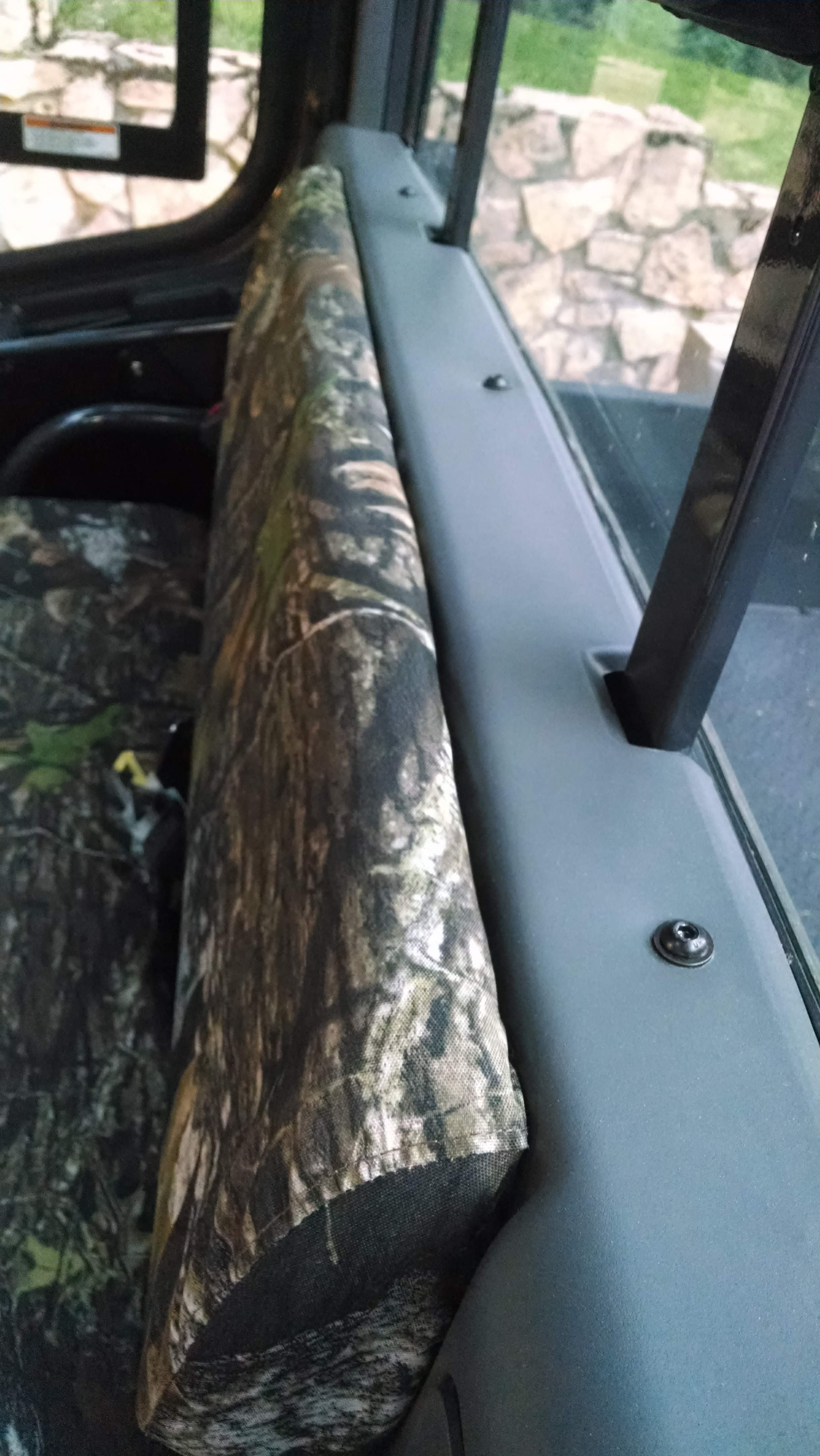

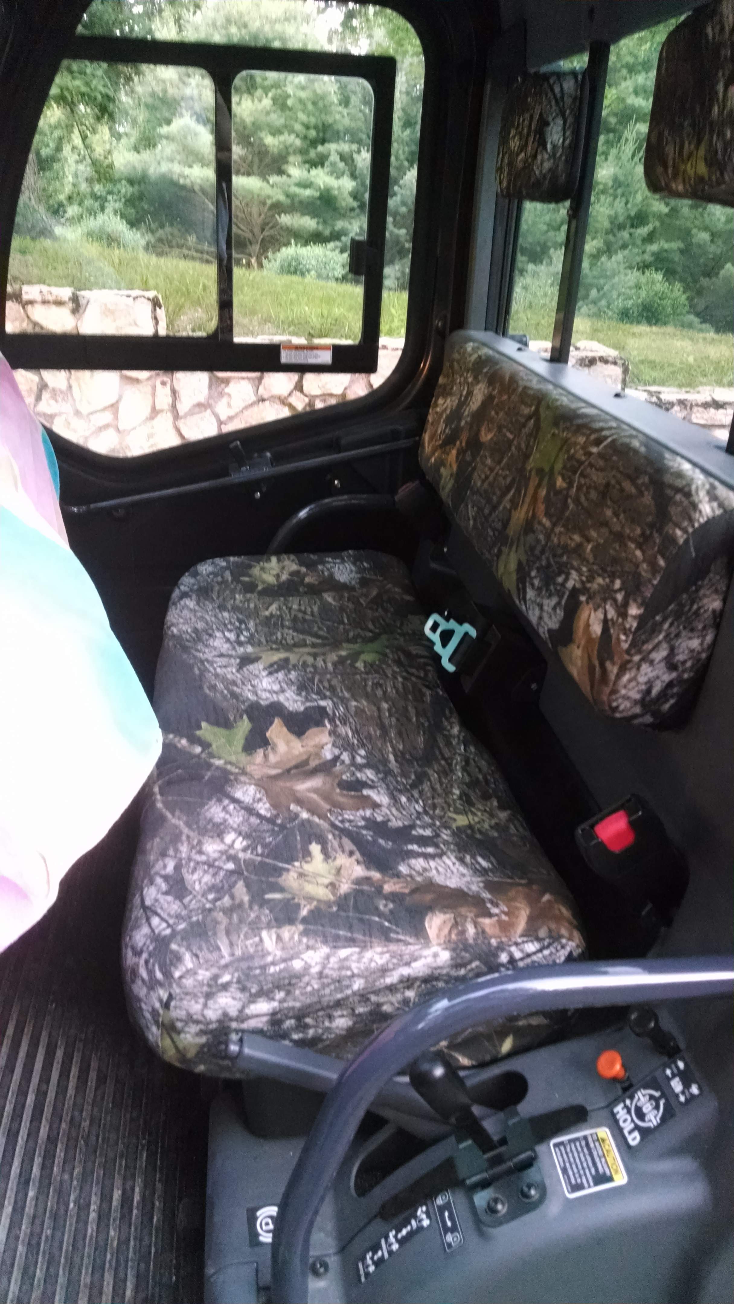

Quick review of the seat covers (I'll post some pics tomorrow).
They are pretty good in terms of fit and quality. The bottom seat cover was pretty easy to install as were the headrests. The back was a little more time consuming. I had to remove the back and install it first then re install the back. Not too bad, removed the Allen head screws at the back and on the sides and then wedged the plastic with a 2x4 scrap to give me access to the three bolts that hold the back in place. The first bolt on the drivers side is accessible thru the fuse access panel; the rest are not accessible from there.
The one thing that I would suggest is to use a pair of pliers to stretch the back cover on (grab it by the edging (piping?) and it will fit pretty well; and use a wide putty knife to stuff the edging down behind the seat to get a tight fit as you tighten the bolts.
Paid $88.50 for the set, so seems worth it to keep them in good shape. Total time to install was about 40 minutes including the "how in the world does this back come off" time, so it's all good here.

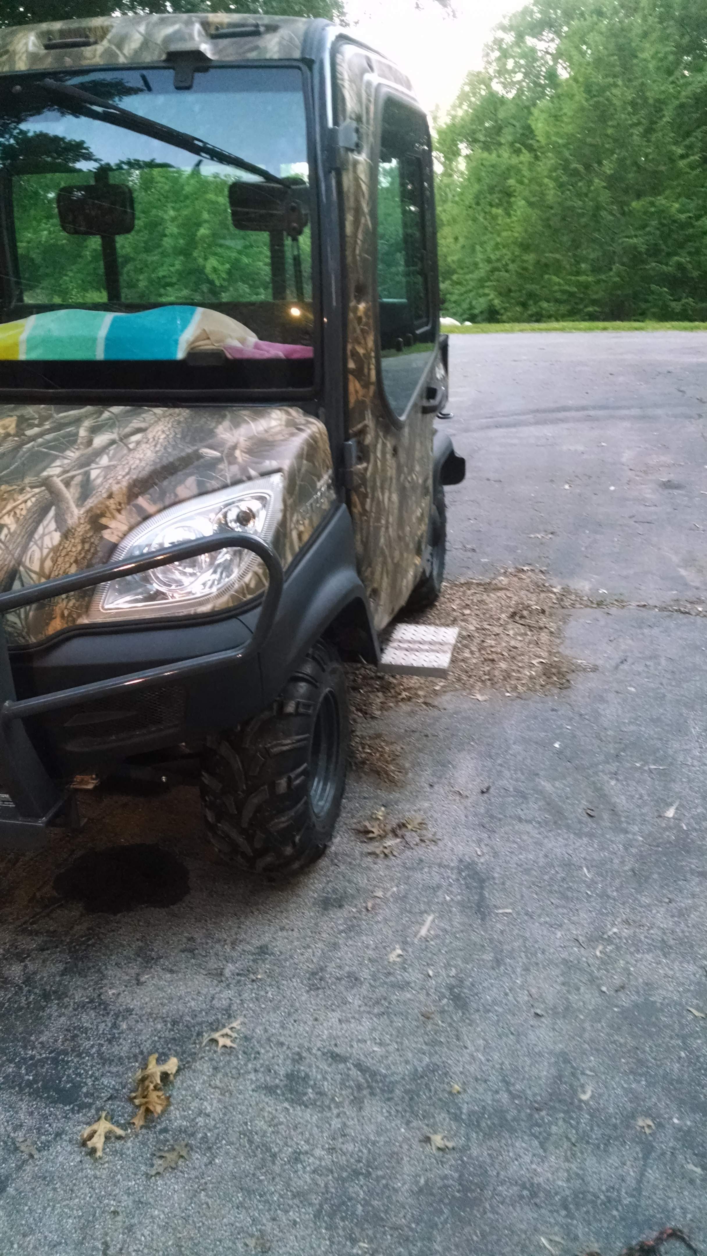

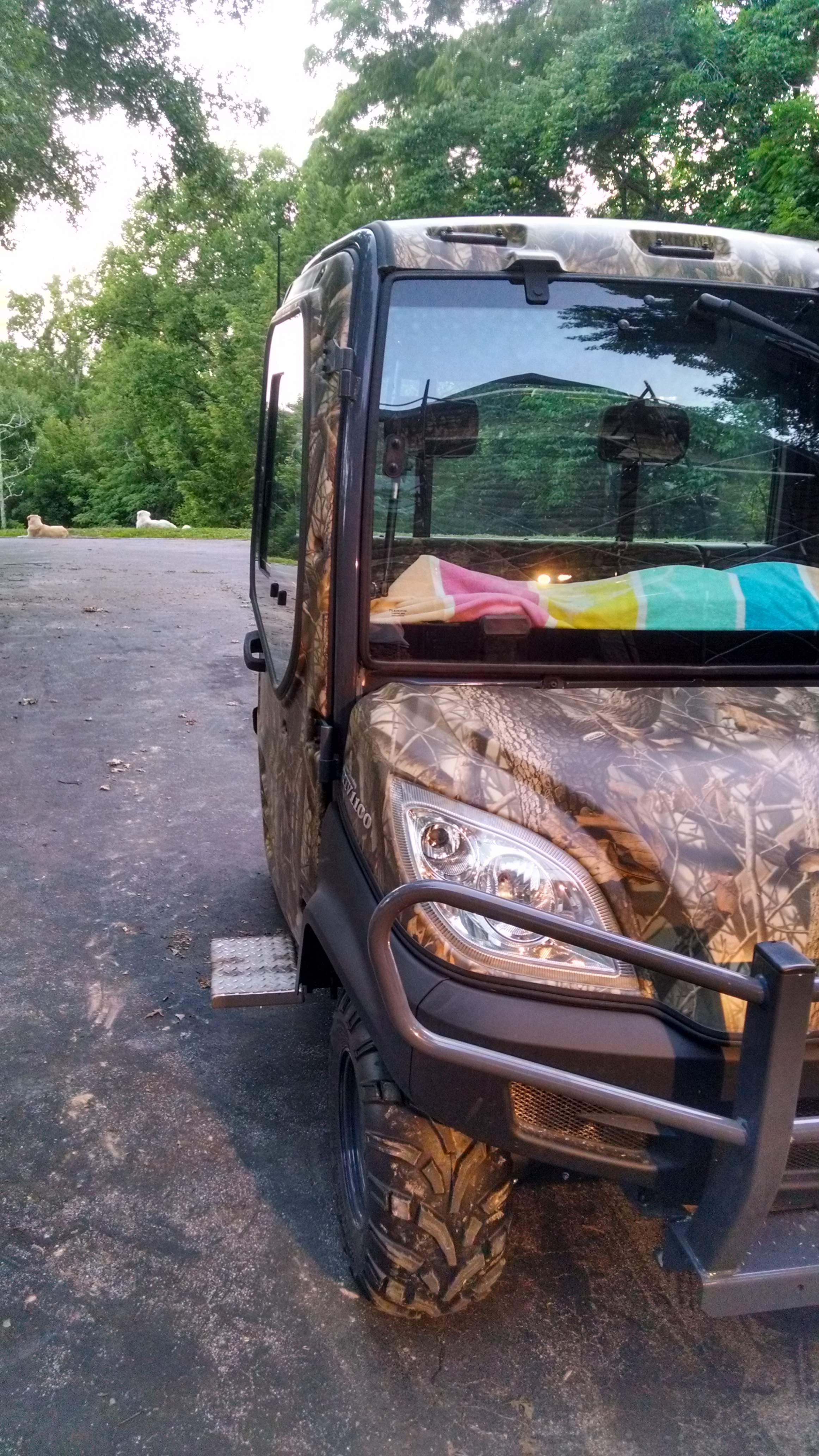

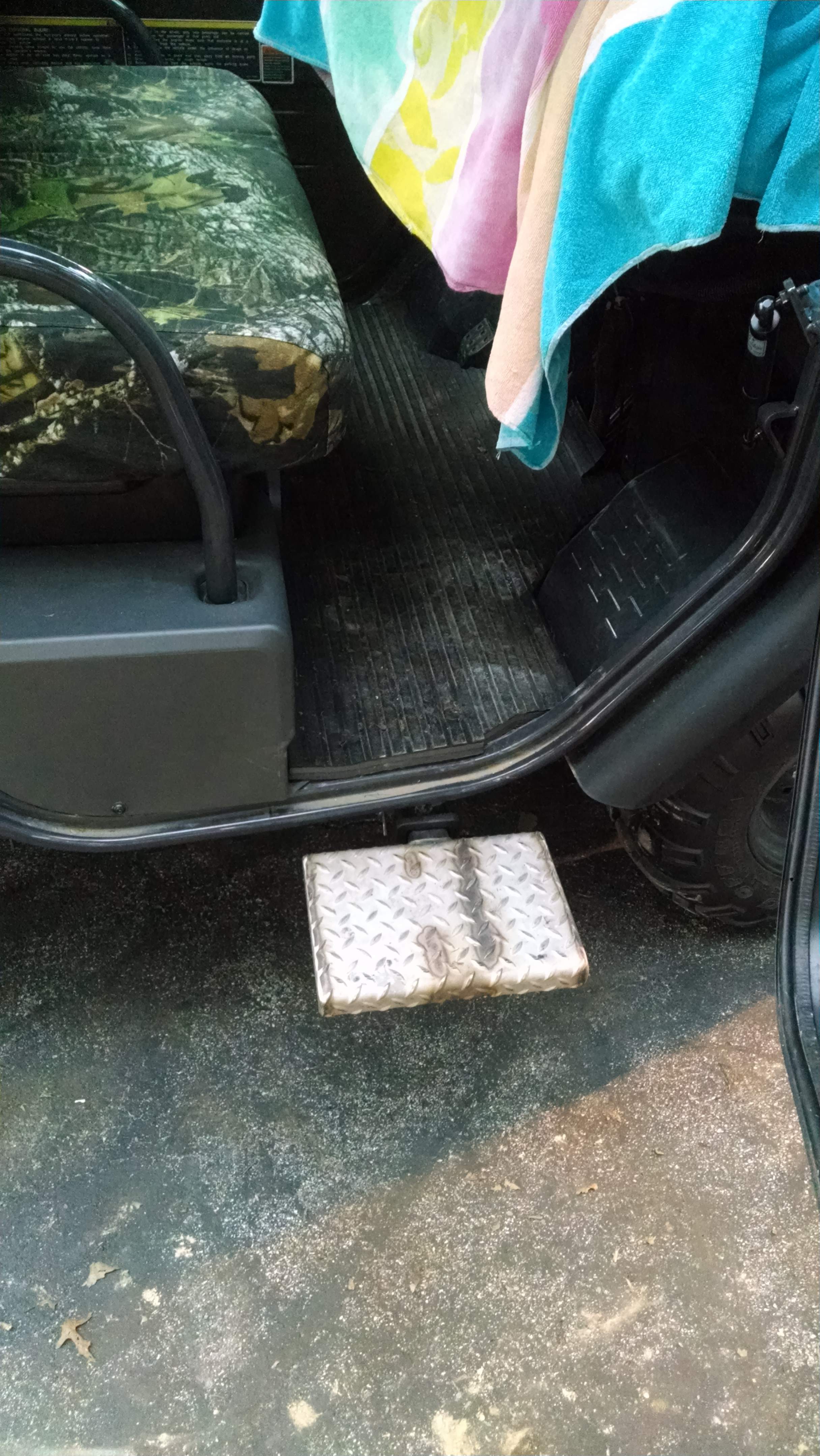

Okay, thought I'd post some picture of the seat covers and the steps I fabricated. So far they are working out great; the one for the Kawasaki fit perfect. Thanks to all for the advice.
