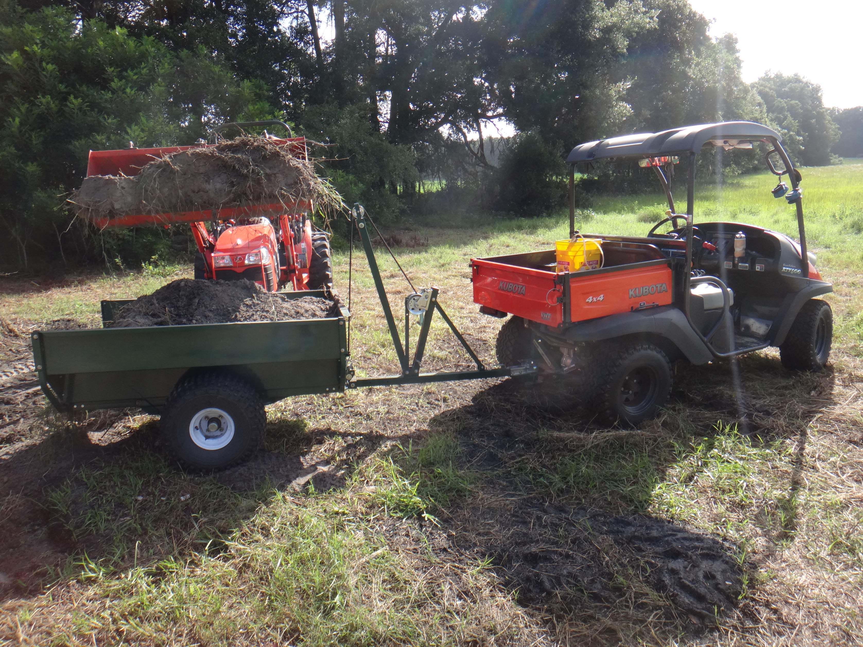

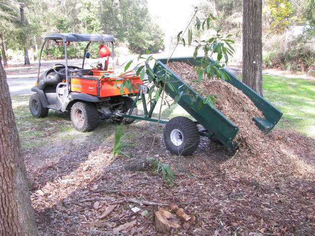

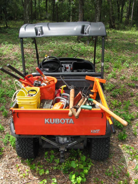

6. Would there be a need for towing a wagon of some sort on or off the farm?
YES. Most of use a utility vehicle for carrying tools and saws and towing utility wagons. Mine is a Kubota RTV500 @ $10,000.
LINK: MUTS - Multi-Use Trailer System for your ATV, Quad and 4 Wheeler

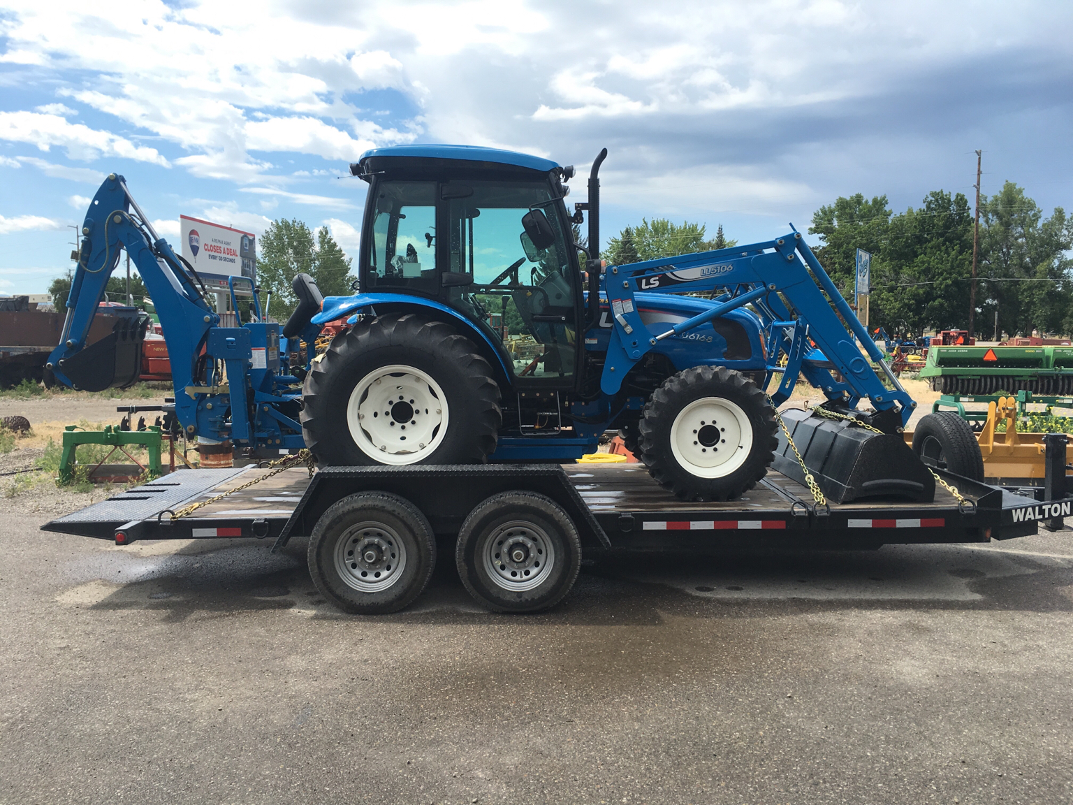

I went through a similar quandary a few months ago. 40 acres of pasture for 15-20 cows.
First the JD dealer didn’t want to talk to me because I wasn’t in the market for a quarter million dollar machine.
I liked the LS tractors, but the two dealers near me had never sold one bigger than a 41 series machine and I wanted 60 to 70 hp. Prices and quality seemed really good.
Kioti were nice, but no cabbed machines to look at and price quoted for a 65ish hp cabbed machine was only a couple grand less than a similar Kubota.
Branson seemed like good machines, but price was about the same as Kioti. Very small dealer didn’t me give me a warm fuzzy feeling.
Mahindra is a lot of machine for the money, but quality doesn’t seem to be as nice as all the others. Price was pretty good, but I had heard stories about problems due to some models being made in different companies in factories around the world. I had read about seemingly tricky/sensitive loader controls.
New Holland were pretty pricey, but the value line Boomers are made by LS, but have less features and more expensive than an actual LS.
Kubotas are very nice, and if money is no object, best bet is just go to the nearest dealer and get the machine you want. If I was rich, I’d have a fleet of them. Their pricing reminds me of Porsche. The base model is good value, but what are standard features on a lot of machines is an optional extra...and a bit spendy. The price I was quoted for three remotes about made me do a spit-take.
After months of looking and a ton of reading here(and elsewhere), and watching a bunch of videos, I was pretty set to order an LS. I got ahold of the district sales rep and asked if there was a cabbed XU6168 anywhere near I could look at. The dealer he put me in touch with was a couple hours away, but he specialized in larger tractors and farm equipment. That dealer didn’t have one in stock either, but had sold one recently and the owner was nice enough to let me drive his machine. Based on the literature and specs, I was pretty sure it would be a good fit, but there is no way i can bring myself to spend that kind of money without making sure it fit me (I’m 6’3” and three bills). It was very comfortable and I liked how smooth the hydraulics and controls worked. I placed my order that day. Couple weeks later I picked it up. 6168CPS $42,500... about $10k less than a similarly equipped Kubota.
I figure saving that kind of money makes up for not having the large Kubota or JD dealer network. Since I do my own maintenance, I don’t think it will be an issue. The reviews on the LS machines are overwhelmingly positive, minus what I suspect are people unfamiliar with tractors or are pushing their machine past its limits.
68 hp (60 PTO) with 84” tiller is a good fit to till the pasture for seeding. I can till (one pass) about 1.25 acres per hour (8” deep).
So far I am very happy with my purchase and have had no problems
Wow I was looking at the Mighty Muts Utility Trailers and in addition to being very stable and agile the uses are endless. This will definitely be something that I intend to get.
