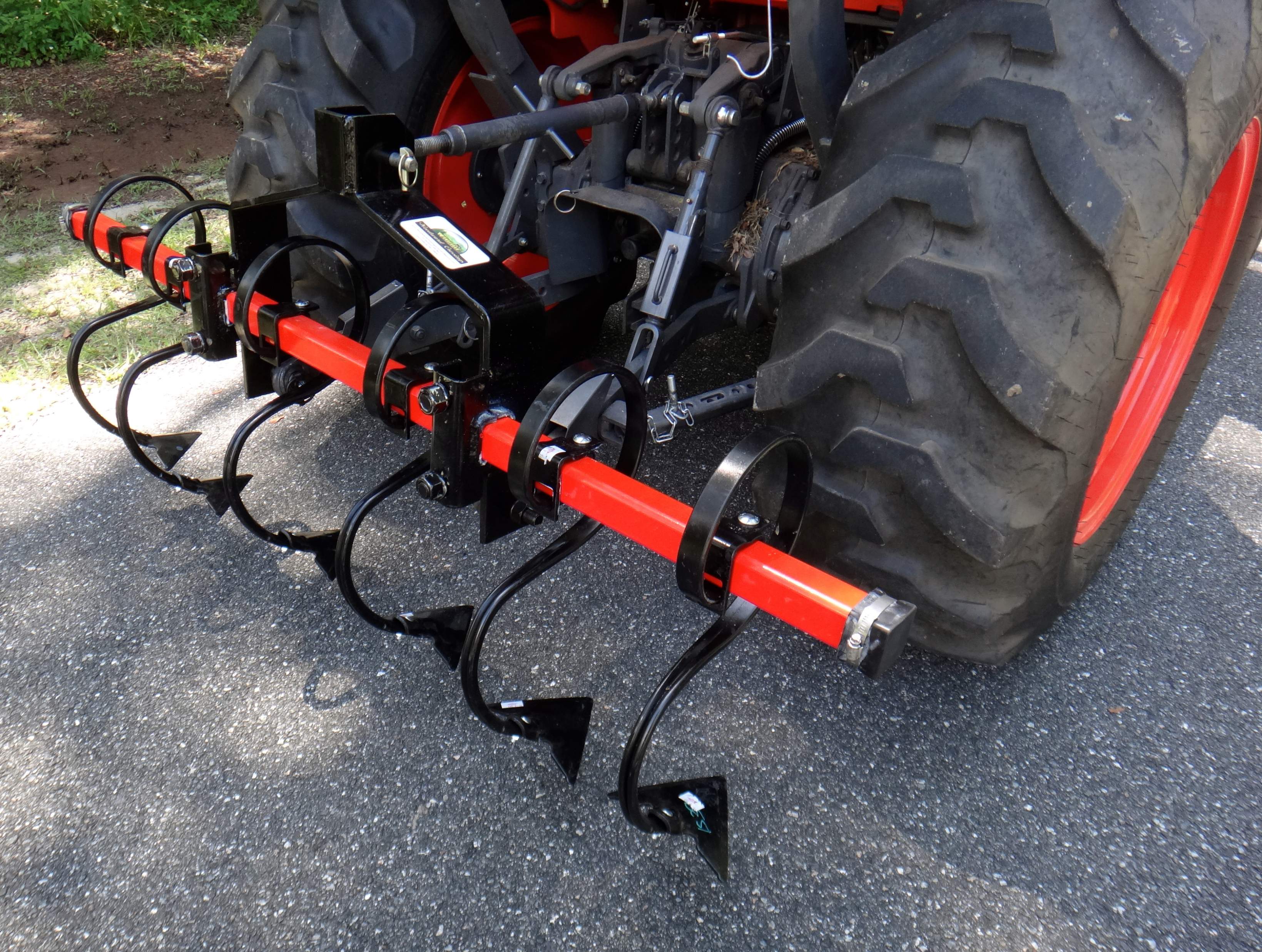

You might want a Three Point Hitch Single Row Cultivator or a Tool Bar Cultivator ~ (Photo #1).
However, a two-wheeled tractor or cultivator is likely optimum. BCS, Gravely, Mantis, etc.

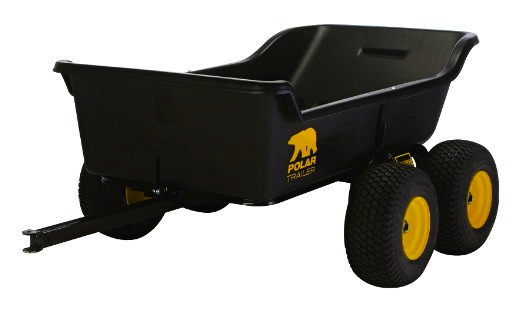

Wow I was looking at the Mighty Muts Utility Trailers. In addition to being stable and agile the uses are endless.

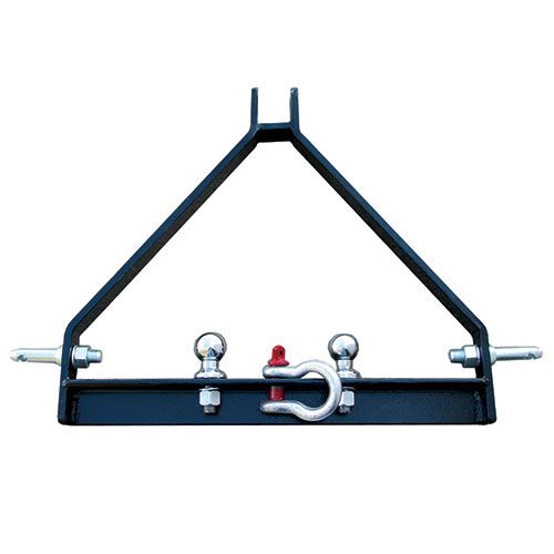

You can pull trailers behind your tractor with a Three Point Hitch A-Frame (Photo #2) but most transport tractor loads in FEL bucket. MUTS is the Gold Standard in manual-dump trailers.
Polar (brand) poly trailer from Home Depot/internet sales is much cheaper ~ Photo #3. Polar does not fully empty.
MORE POLAR: Polar trailer site:tractorbynet.com - Google Search
