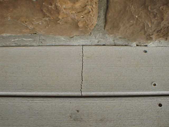

When we built our house, our contractor talked us into Timber Tec composite decking material. It looks nice, and is relatively maintenance free, but there are some things I'm not too fond of.
1. The deck boards are pretty soft and will scratch and gouge easily.
2. When in the direct sunlight, they get pretty hot.
3. We have one board that split across the board in an almost straight line. This board was right next to the house with plenty of protection from the weather. (see attachment)
4. The boards that are exposed to direct sunlight (on the south side of the house) will cup. The boards are fastened with 2 screws at each floor joist about 3/4" in from the edge.
On the plus side, the only maintenance that I have to do, is to pressure wash them each spring (don't really have to, but that's just me).
If I had to do it over again, it would be a toss-up whether I would go with wood or a composite again. /forums/images/graemlins/confused.gif
