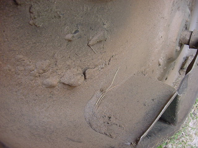

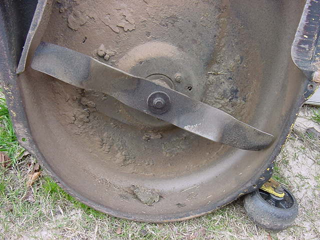

Guys, just an update... I purposly neglected to clean the underside of my deck last year to test the bedliner coating I put on last spring.. Here's a picture of the results.. We had a heavy cutting season, so heavy in fact that I had to buy a sweeper to get the cuttings off the grass, lots of rain and wet grass.. I will need to reapply, and will likely do a more professional job next time.. I didnt like the quality of the arosol can stuff, but a brush on should do better...

The build up was pretty severe the previous year, prompting me to try this... I'm happy with the results and recomend it..

Thanks for the info.
Hard for me to tell from the pictures, did the liner come off in pieces or just wear off? How many cans did you use? How many coats of liner did you put on? Was it the rough or smooth liner? A lot of questions, I know.
Your answers are very much appreciated.
Thanks, Alan
   / Deck Clogging #16
I primed it with an "rust converter" that neutralizes any rust before painting.. I used 3 cans of the arrosol bedliner and yes it did rub off in places, mostly where the front edge of the deck may drag across the gravel drive.. The final product is nowhere near as thick or durable as the professional product.. The rust converter I used may have played a part in the adhesion(sp?) but I still believe the brush on or professional system would give a much better quality finish with more longevity.. Like I said, overall, I'm happy with the results.. I'll just use a different product next time. Hope that helps some.. BTW,clogging was mostly eliminated, the stuff that did build up comes off really easy....
