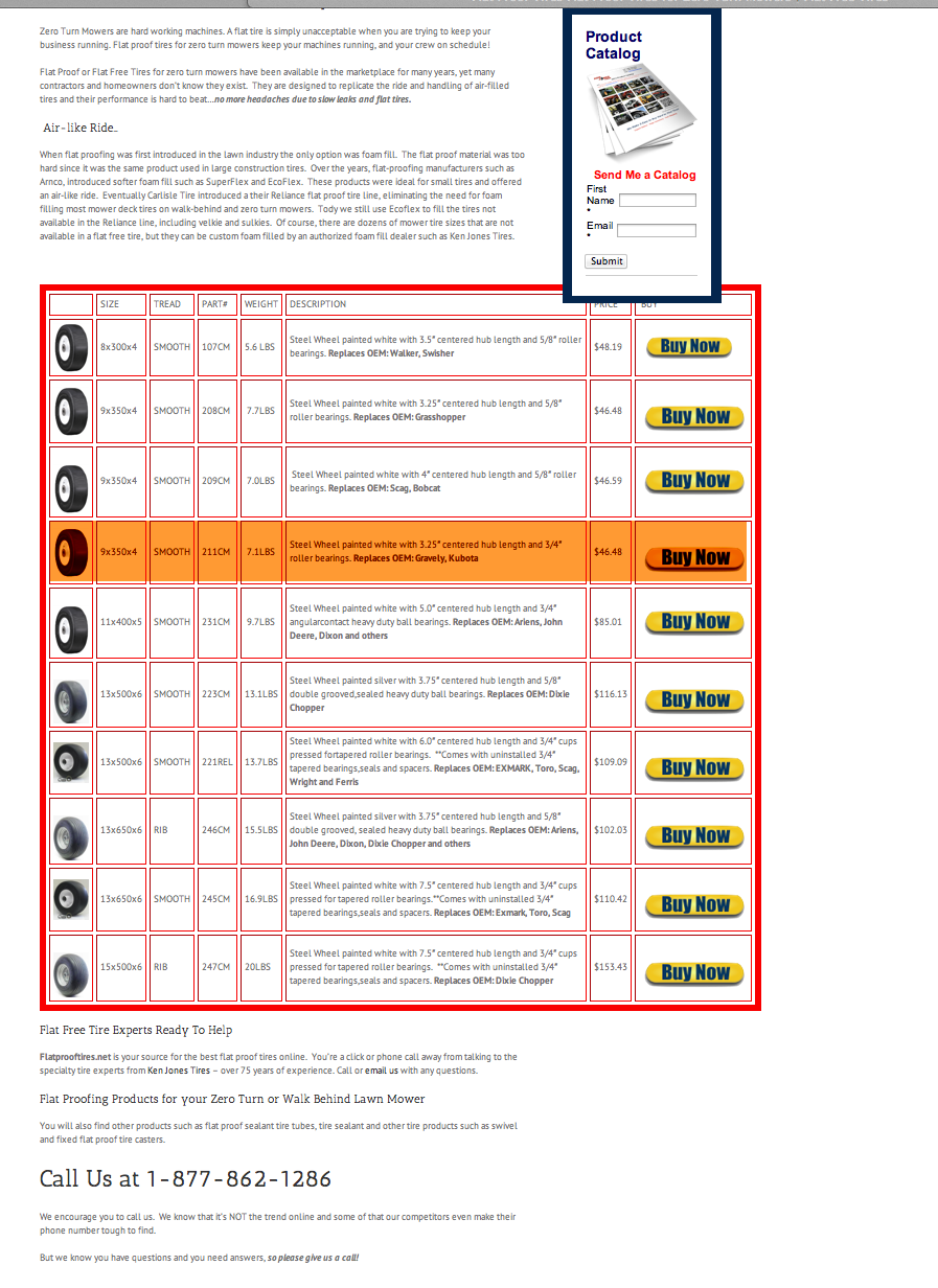

Can you give more details of size, part number and a web site to order from, maybe link to the page. Can't read this paeyou osted. To blurry when Ctrl+ used.

I believe these were the tires I ordered for your Kubota:D
9x350x4 reliance flat proof smooth tire mounted on a white steel wheel with 3.25" centered hub length and 3/4" roller bearings. fitments - gravely, ariens, kubota, carlisle tire co. - Ken Jones Tires
They don't weigh a ton each (and bounce accordingly) and easier on the wallet.
EDIT: found the original link per what I posted. I'm including it because there is a very simple video at the bottom on how to measure for the tires.
Flat Proof Tires Flat Proof Tires for Zero Turn Mowers | Flat Free Tires

They are one piece. Actually, last night, I put a level on the deck and I believe you are correct, they are slightly higher (probably about 1/4"). I've been busy with vacation/work/family, that I never noticed it at first and only when my dad was driving it last night thought it looked "a little off" per front deck height. How long did you get out of the ball bearings?
