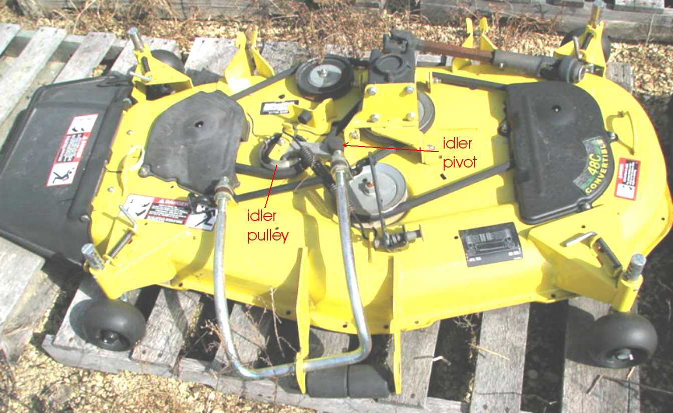

I'm sooooo mad right now...let's just say it's fixed...told you it was something stupid......THE BELT WAS ON WRONG!!! I can't believe I've looked at that thing 100 times in the past month and swore it was on correctly. I finally ordered a manual and just stood there when I realized what it was looking at the manual and the deck....thank god I didn't take it into the dealer....holy crap, I can't believe this.
that is one of the first things everyone suggested, including the dealer, when I talked to him. I finally remembered the belt came off about a month ago when my wife was mowing, and I put it back on without taking the deck off the mower (brilliant I know) so every time I took the belt off I looked at the deck beforehand and sure enough I put it on the same way (i.e. wrong).

Sorry, I didn't read the whole thread, but it sounds like this problem started when you sharpened the blades. If that is the case, is it possible that (like me) you have mounted one or more of the blades upside down. Now I see that you had a belt on wrong - that would have made one or more of the blades turn in the wrong direction and cause the same type of poor cut as having the blade mounted upsode down. Don't feel too bad, everyone can make a mistake !

Here is the best picture of a 48C, that I could find. It shows the belt routing and idler pulley and pivot. I don't know, if they are all shaft driven or both shaft or belt, however the basics should be the same.
Also, when lowering the deck, the guide wheels will be a factor, in how far it can drop
