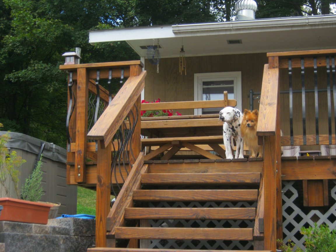

Looks like a spot for some welcome shade in the summer Bird!
