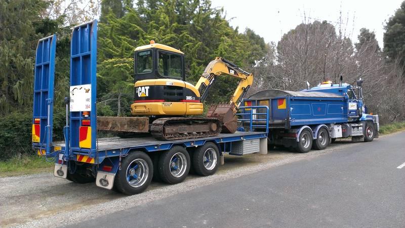

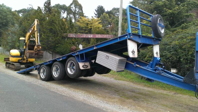

Following on from my post#9 & acknowledging the photo's below of one of our specialised trailers is far larger than probably what the originator of this thread had on mind, conceptually we are also considering building something similar in a smaller c.5T scale dual axle single wheel set up to move our skid steers around - IMO for fast ease of (relatively) safe/stable loading it's hard to beat (by lowering the ramp approach angle, minimising the ramp length & for track machines eliminating the ramp over tilt/balance - this set up lessens/eliminates the highest risk areas of the loading cycle being the source of most accidents/injury when relocating machinery )->
