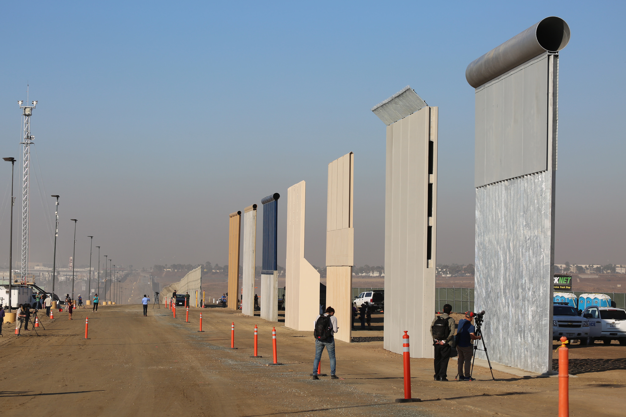

One of these designs MIGHT keep deer out.

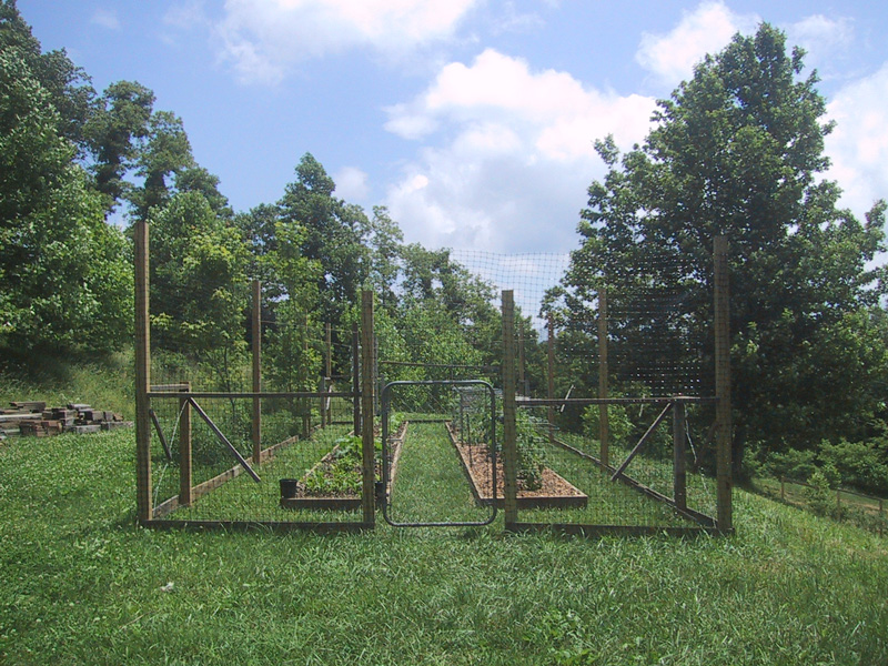

This is what has worked for us for seven years on our garden, after the deer drove us out of our un-fenced garden:
That's a seven-foot plastic deer netting on 4x4 braced posts. I think it's successful because there is nothing visible at the top, so the deer can't see well where the top is. There is only a black plastic-coated wire along the top. The raised beds inside probably help as they don't provide a good landing spot. I suspect they might jump it if it were clear inside.
Since this photo was taken we've added a two-foot chicken wire band around the bottom and sealed the bottom of the gate with wood to keep the rabbits out. They think the plastic deer wire is an appetizer.
