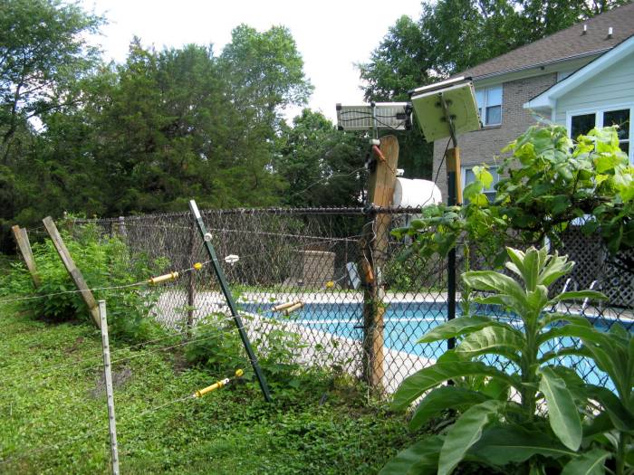

Hereç—´ a picture of my current 2 wire row system. Online, they say you can use 2 wires and then a single wire 18 (roughly) out front. I already had the 3-wire system that absolutely was not working to keep deer out of the raspberry rows. However, the dual rows are effective. You can see in the picture where the canes had been nibbled more where the deer were able to gain access when I had only the single line of fence.
Itç—´ hard to see, but there is a knife edge switch just above the cyclone fence. This is used to deactivate the fence for inside garden maintenance. If you look very carefully, you might see a red screwdriver handle which I use to keep from getting zapped by a wet knife edge.

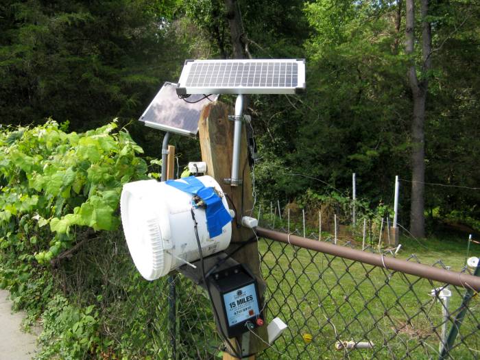

Hereç—´ a picture from the other side. You can see the knife edge around the back side.
Note the 2 solar panels. Even 2 will not maintain the battery in other than high summer periods. So, I really question whether the tiny panels in the all-in-one systems will do the job. The wiring underneath the blue tape is a battery tender off the bigger panel (around 20v). The other panel is only 15 v and is connected directly to the battery. Notice the ?5 Miles charger. DO NOT drop your charger! Mine was dropped, and it lost its audio and blinking light output. However, it still works.
I have another knife edge down below supplying that little garden you see to the right below. It is mounted on a metal pole. It regularly sparks from the knife to a screw holding it in place on the pole when the battery is still ç*¥p? When it quits sparking, the battery needs a recharge.

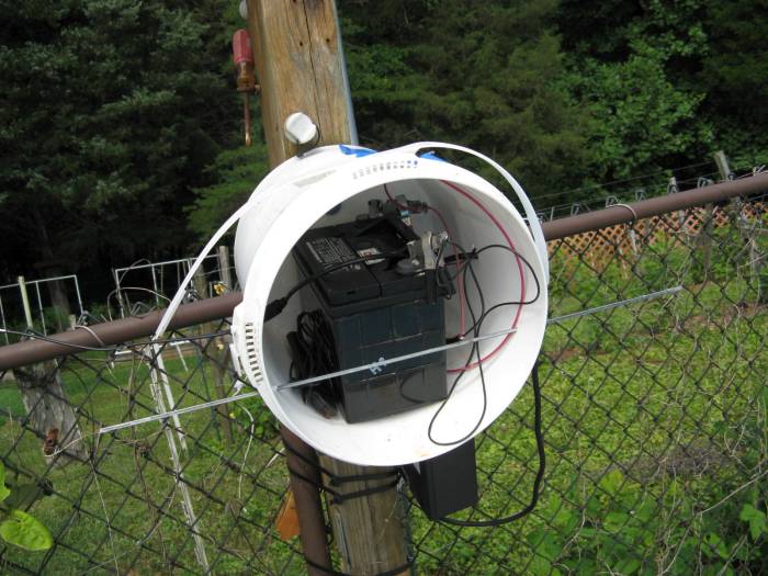

Hereç—´ a picture of what is inside that old chlorine container: the battery!
Itç—´ an inexpensive utility battery which now costs more than $50. That bar is to keep it from sliding out if the lid pops off. Thereç—´ a fence tester coiled up just to the left of the battery. Itç—´ scary to use. It makes a loud ZAP when the fence sets off its multiple LEDs and makes you feel almost like YOUæ*ŽE been zapped. Don稚 use your volt ohm meter on the fence. Itç—´ 5,000 volts which is necessary to deter deer..
