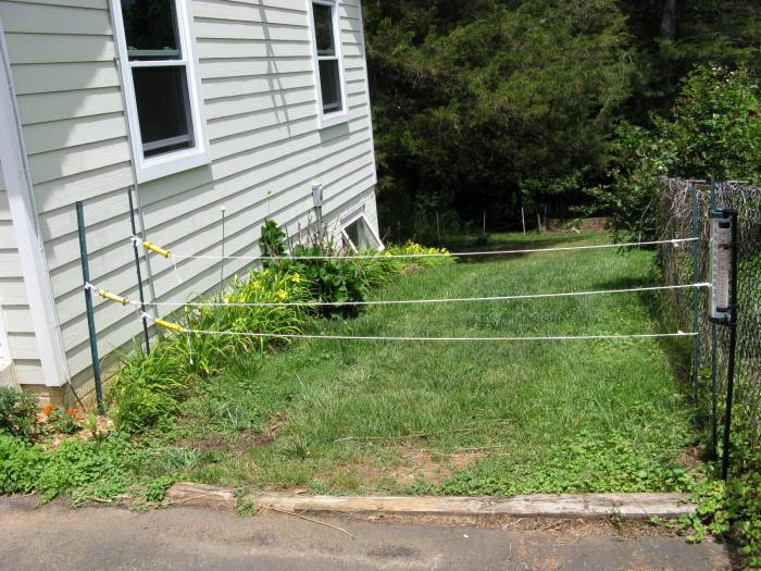

A simple 2 deep fence works to keep "hooved rats" out. Attached is a picture of the rope fence I have between my carriage house and little garden behind the garage. It's just 2 ropes on one fence and a single rope on the front one. Could probably do it with 2 ropes at different heights 18 to 24 inches apart. Hooved rats have very poor depth perception.
All you need are the step-on teflon posts from TSC/Lowes/Home Depot. Don't need them that close, maybe 20-25 ft spread between posts.
The pictured rope fence is the top part of the back yard fencing. I've the rest fenced in wire instead of rope. Used to have it electrified, but works fine without.
Got daylillys right behind that rope fence and 3 camellia just down the slope. These are both hooved rat candy.
In the past, I've racked up over 30 kills using a kill permit to control these pests. As long as the carcass is out in the open, buzzards will have it down to bones in 48 hours.
