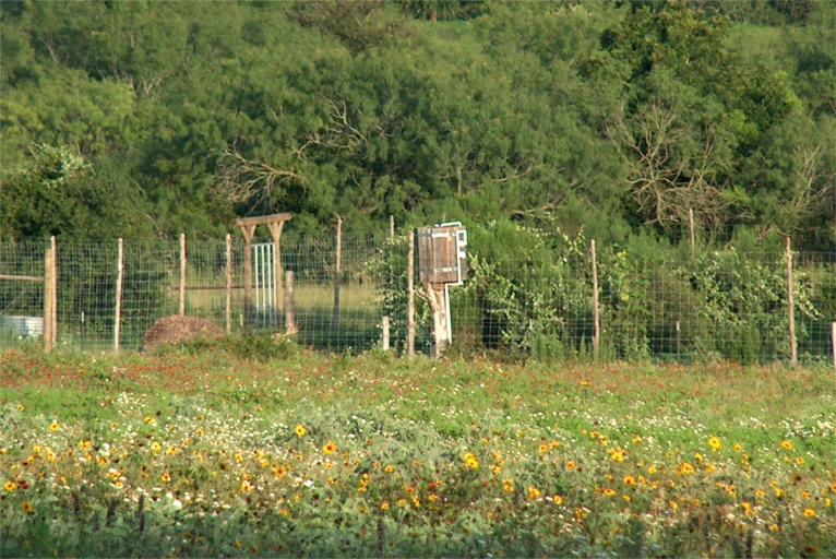

Dwight44, Attached is my 2-year old 8' deer fence. For a gate I used a 8' gate sideways with the fencing attached. I used cedar post. I now have to get an electric fence to keep the raccoons out.
