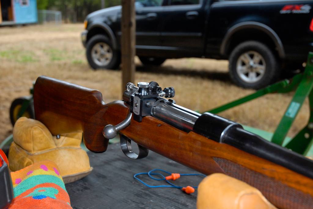

Got the Lyman 57 sight on Thursday. Pulled the action out of the stock to mount the sight. Found that the holes in the sight did not line up perfectly with the ones in the receiver but was finally able to get it on tight.
Yesterday went down to my cabin to sight it in along with several other guns. There was misty rain off and on all day so I had to start out shooting from under my tractor shed. Here is a pic of the sight on the gun:

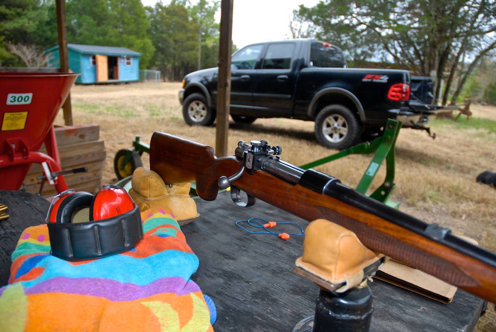

Here is another under the shed:

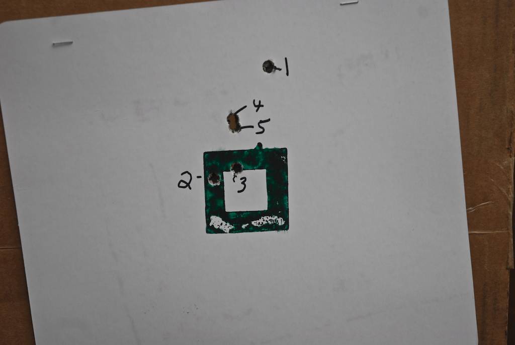

I bore sighted it then started shooting at 25 yards. Below is a picture of the first 5 shots. Made an adjustment after the 1st shot. Made 2nd and 3rd shots and wanted it to shoot a little higher and made a final adjustment to get shots 4 and 5.
At 50 yards a 3 shot group was under 2 inches, hitting about an inch high, pretty well centered. I tried two offhand shots, standing, at 50 yards. They hit about 1.5 inches high and about 1.5 inches to the right.....the two holes were touching. Not sure why they were a little to the right when the bench shots were centered but I did not mess with it again. From the first shot to the last all of them would have killed a deer at 50 yards, probably all but the first one at 100 yards.
