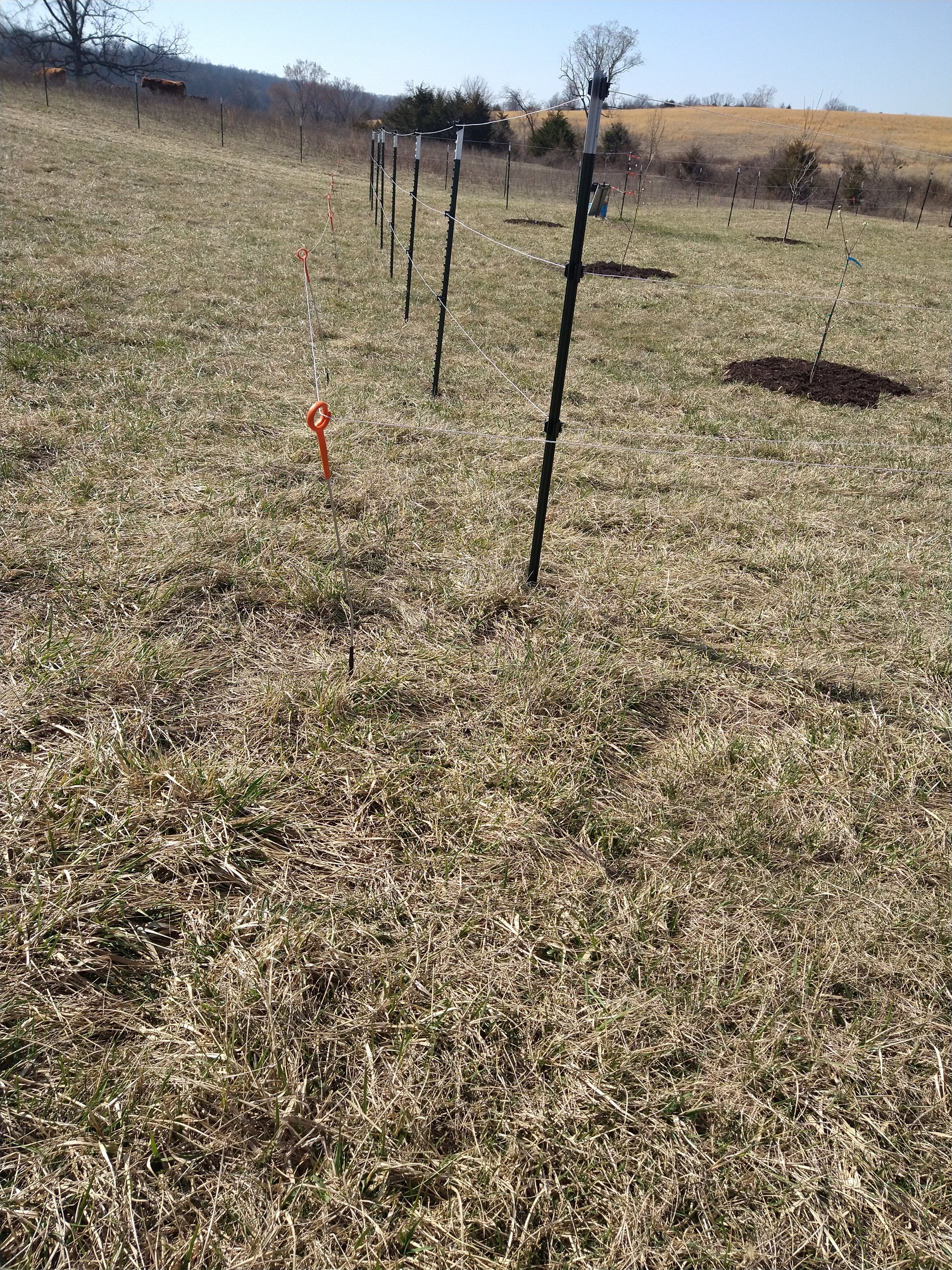

Deer easily hop over electric fences.
Depends on how you build them ... Look into to "3D fence" if you want to keep them out ...
Mine works! 😁
I put it up this spring, no more problems on my trees! IIRC wires on T-Post is at 22", 40", 54", then the fourth wire is set 30" away, and at 30" high off the ground ...
Mine works! 😁
I have heard about and even tried the multi-dimensional fencing before on my garden. It works. Unfortunately, my pig pen is about a quarter acre and is already fenced with 4 ft high field fencing. I tried deer netting above the field fencing, and they just dove through it and made a mess of things. I may have to run another layer of field fencing above the existing one. Thank you for the response
