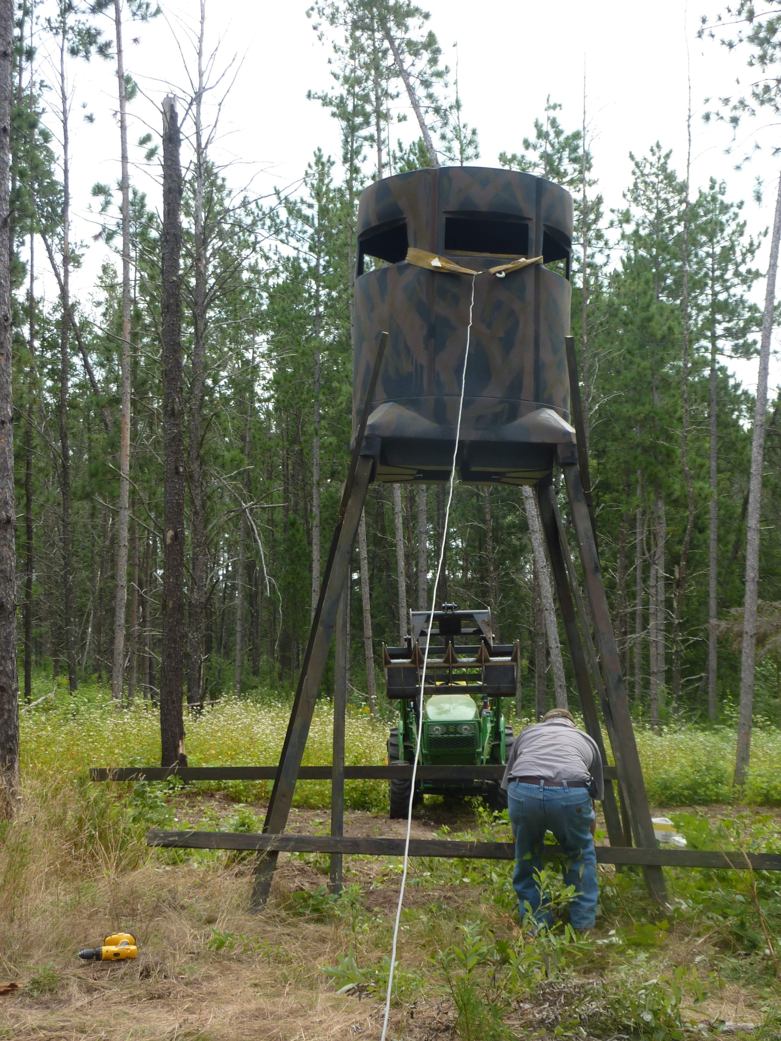

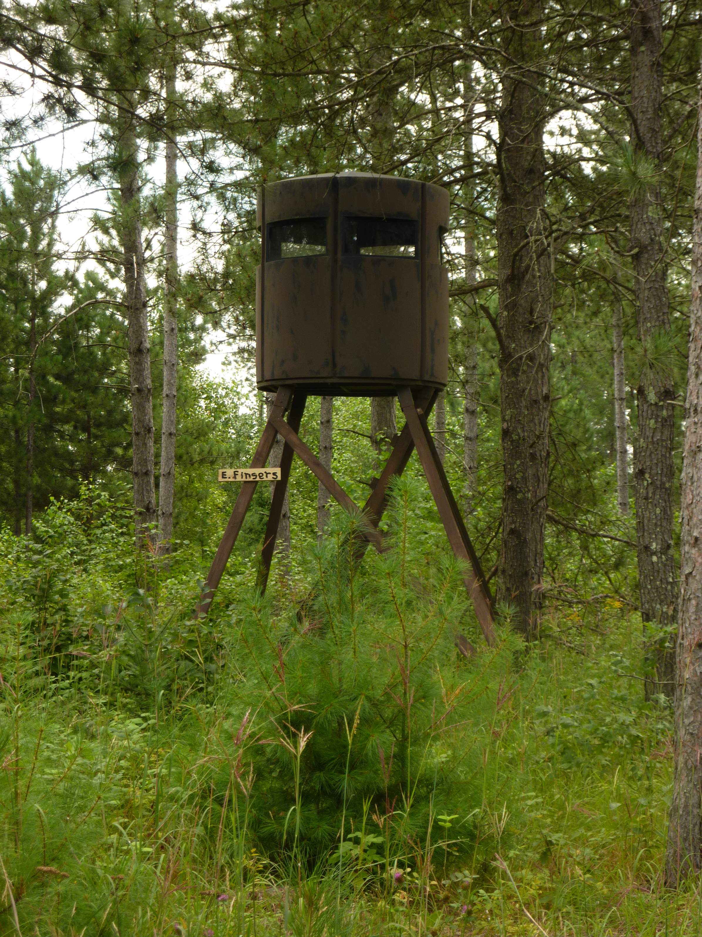

My two big ones still in progress, took awhile to get the aluminum welder lined up.

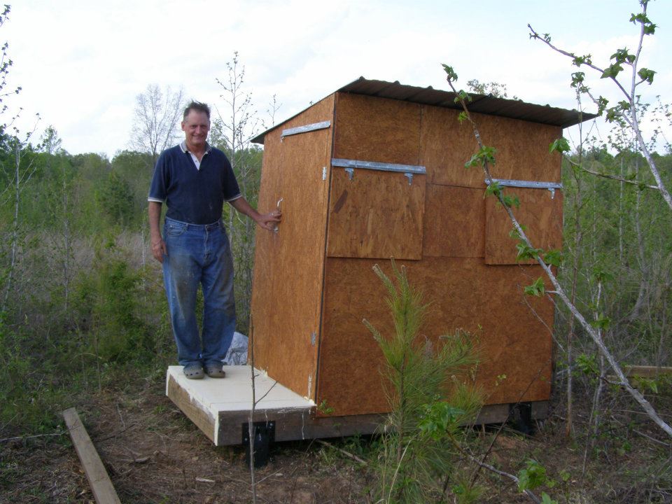

Son and I built this 4X6 (with a 2' "porch") on the ground and then pulled up into position. Finished with guidewires and ground anchors. Overlooks a 75'X100' food plot. Took two nice bucks during blackpowder (rut season) from it. Seats two but it's a little tight.

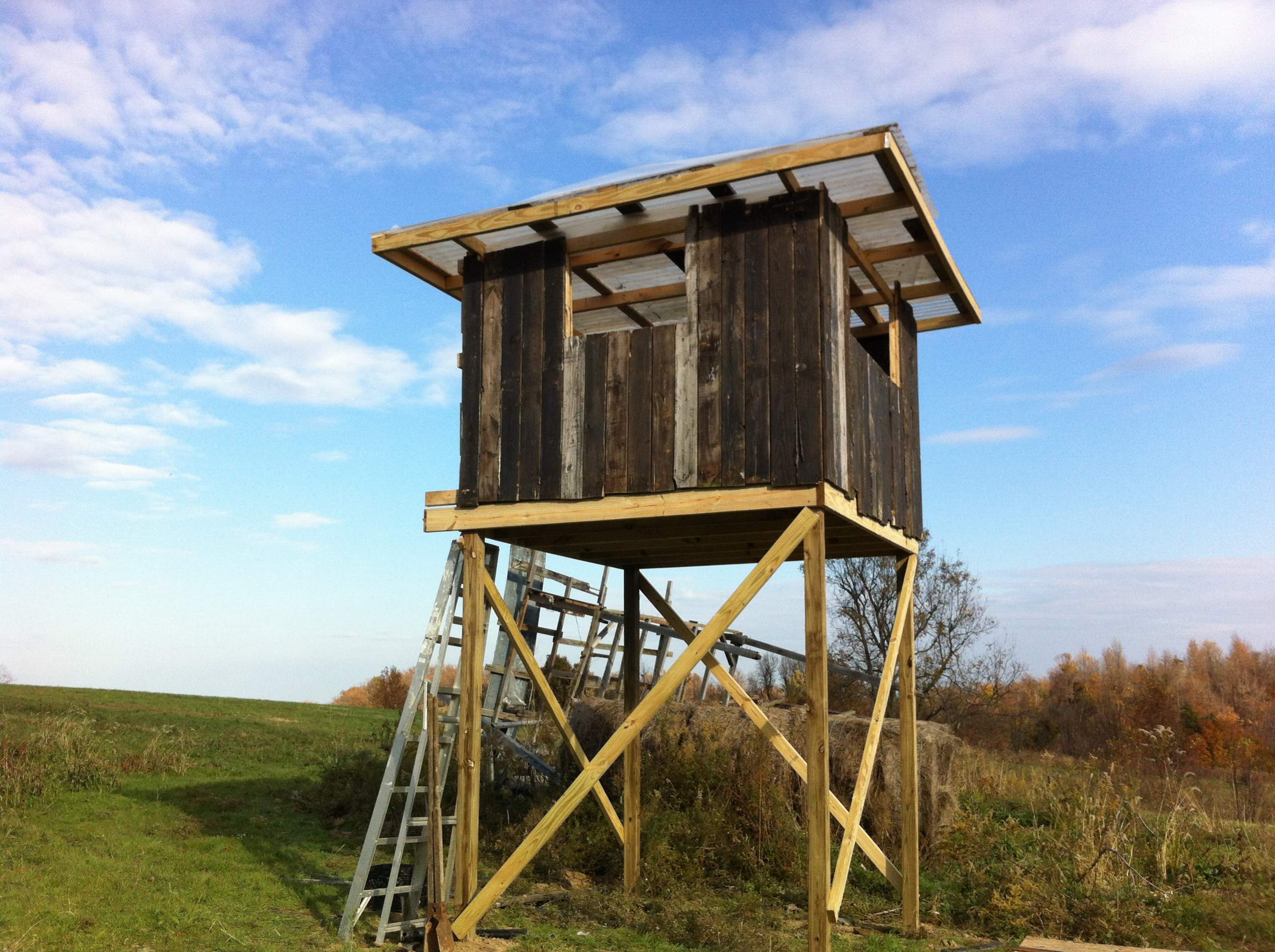

Here is one of mine. It overlooks a hedge between two bean fields and also has a food plot beside the main fields. The Mrs got a nice doe from it in it's first year of operation.
