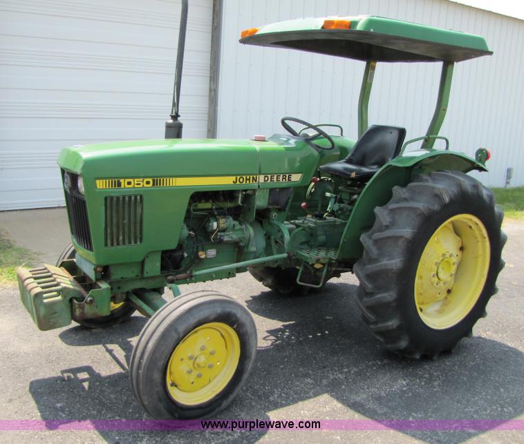

My parts manual for a JD 850/950/1050 shows the frames and axles and stuff to be swapable. Just that the engine for the 850 is a 3T80 and the 950/1050 is the 3T90 engine. The 1050 gets the turbo.
The JD1050 in the Yanmar is the rare YM4300. There are several here in the USA and Canada, but much more popular in Australia.
