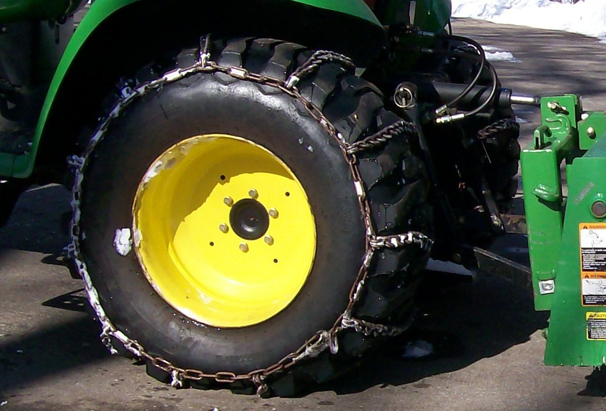

Do you know what the cross-link length is that you want for the front tires? i.e. how far down the sidewall do you want the side chain? Also, what would be the length of the side chain?
If you can decide on those lengths, then I'd look for the availability of the cross chains and then make a set of chains for the front tires.
Apparently you have not kept any of the chains used on previous tractors. I have bought used car and truck chains for my front tires. With some cutting and fitting, get them to work well for me.
Made the rear chains for the JD 4300 because there was very little room between the fender and the R4 tires and didn't want the side chains to run far down on the tire sidewall.

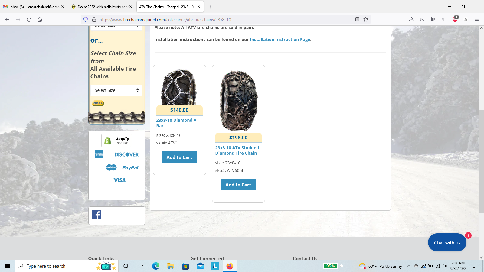

Aqualine chains are a good choice as are TRYGG and OFA.
As far as the fronts;
200/60-15 (Diameter = 23 inches, tread width = 7.5 in, sidewall height = 4 in). so 7.50 x 23,
I would use ATV chains,
These patterns and similar will get you the most traction along with keeping the bumping and bouncing out of the front.
