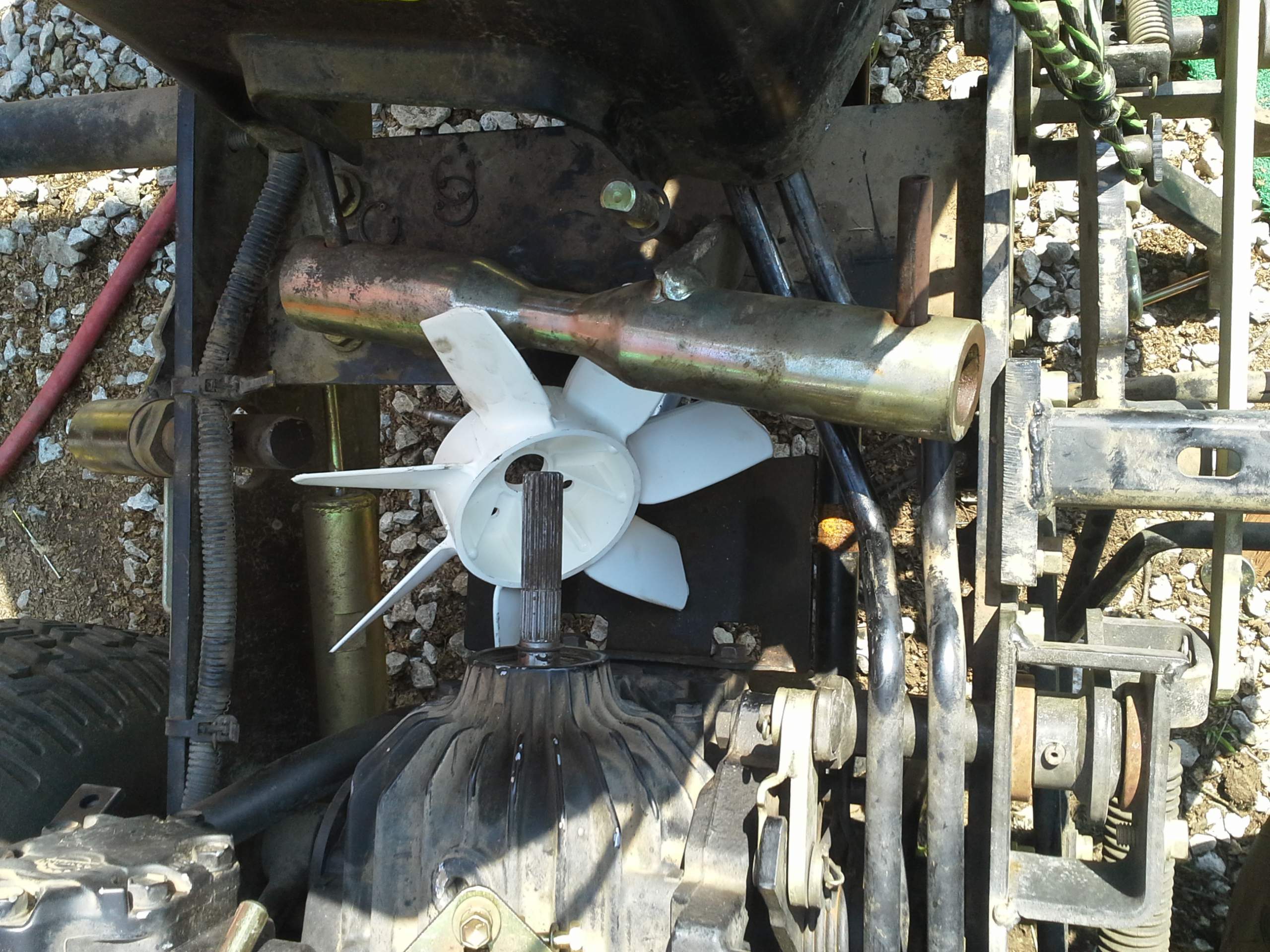

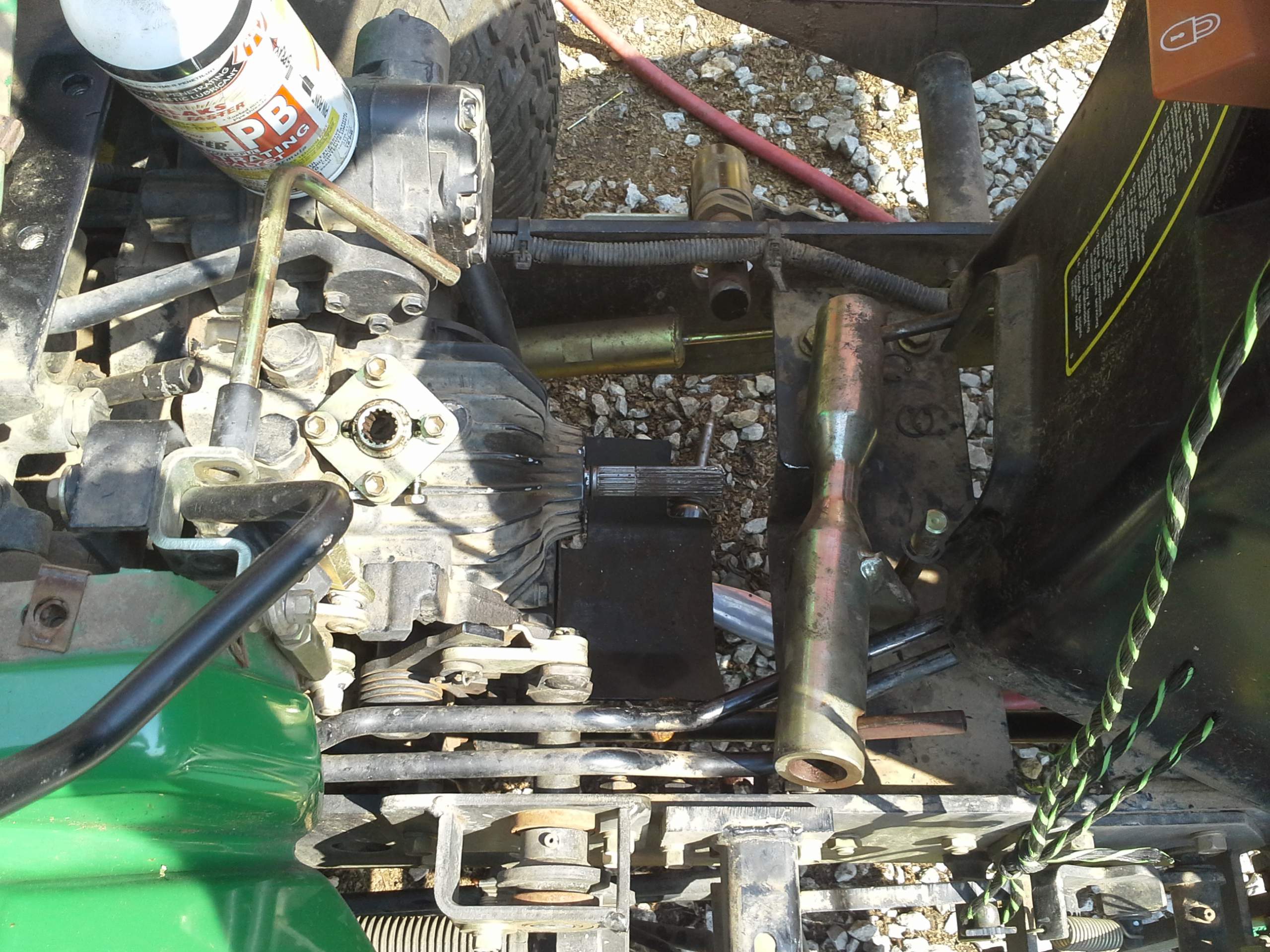

Good afternoon all. I would like to first thank all of those who have contributed to the 2210 repair threads. Great information, pics, part numbers and descriptions. I have learned a lot from your previous experience. Unfortunately I still had to replace my transmission cooling fan and did not want to split the tractor or pull the transmission out the back to get a $27 fan installed. After a bit of head scratching, I think I found the perfect solution: 20130816_111843.jpg20130816_111907.jpg
Just tap out the 2 pins from the bottom and the bar comes right out! If you already have the ROPS, floor and such already out, it seems pretty easy and now I don't have to worry about welding plastic or cutting up a perfect new fan!
I welcome any and all feedback!

"It looks like you have the drive shaft off. Did you remove front faring to get to the front coupling of the drive shaft?"
   / Deere 2210 transmission fan replacement (no cutting no splitting)
Yes, my drive shaft was trashed. There is a cover on the right side of the tractor behind the faring that reveals the front of the drive shaft. I found that a good set of snap ring pliers made it much easier to get the shaft out.. Not the easiest job to do, but I would certainly remove the drive shaft again to replace the fan if it was damaged. (when it gets damaged)
