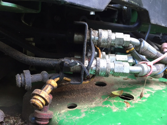

Show picture of your FEL valve.

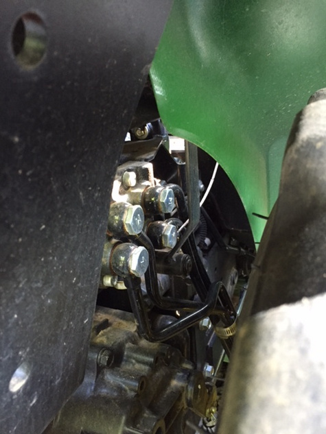

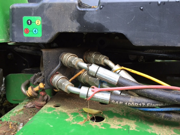

J.J. - here are some pics.
This is where the loader lines plug into the tractor hydraulics via the quick:
Then, the quick connect lines run back to this manifold behind the right rear tire:
View attachment 423802 View attachment 423803
