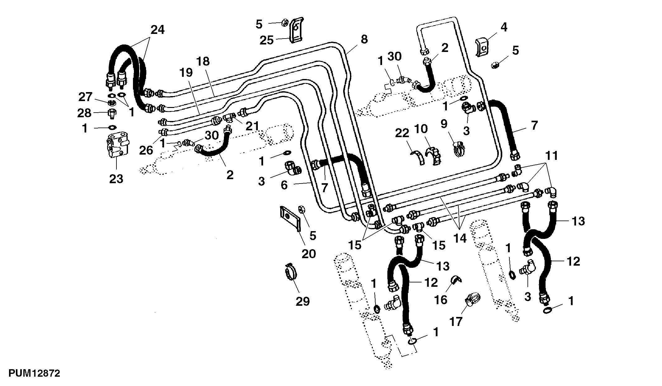

Does your 2940 have the correct mounting frames that go from side mount to rear axle?? If not you may end up with a cracked/broken clutch housing. The utility tractor hyd schematic in the 260 parts cat. shows no relief valve for self leveling that you refer to.

Yes, I do have the mounts that go back to the rear axle.
You do have the return line in your post, but the relief isn't visable because its mounted on the loader frame. See attachment. Item 23 is what I'm looking for.260.gif
   / Deere 260 loader on a 2940 #13
You do have the return line in your post, but the relief isn't visable because its mounted on the loader frame. See attachment. Item 23 is what I'm looking for.View attachment 344703
My JD 245 loader has the same valve. I had trouble with the tubing (not shown) used for the return to sump line getting pulled out of the fittings so I replaced it with 1/4" hydraulic hose.

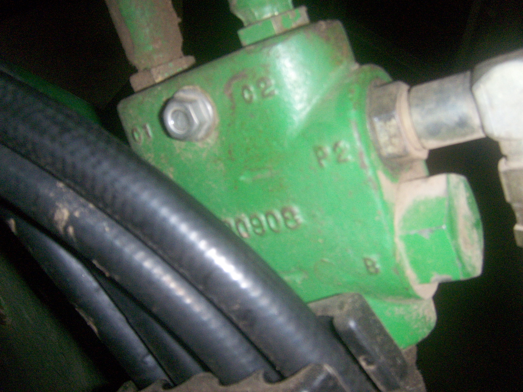

Zebrafive, could you please take a look at your valve to see if you can find a manufacture or a part number on it? Thanks!
   / Deere 260 loader on a 2940 #15
Will do next time out to the barn (6 miles away)

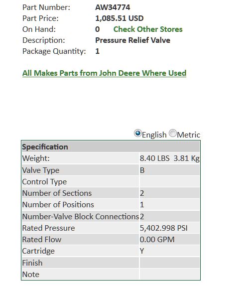

Sorry I left JD dealership about the time 260's were introduced.
Here's parts key #23
AW34774 Pressure Relief Valve 1 (SUB FOR AW20908)
AW25329 Pressure Relief Valve 1 008001 - (USE WHEN LOADER IS EQUIPPED WITH SPECIAL ROLL-BACK LINKAGE)

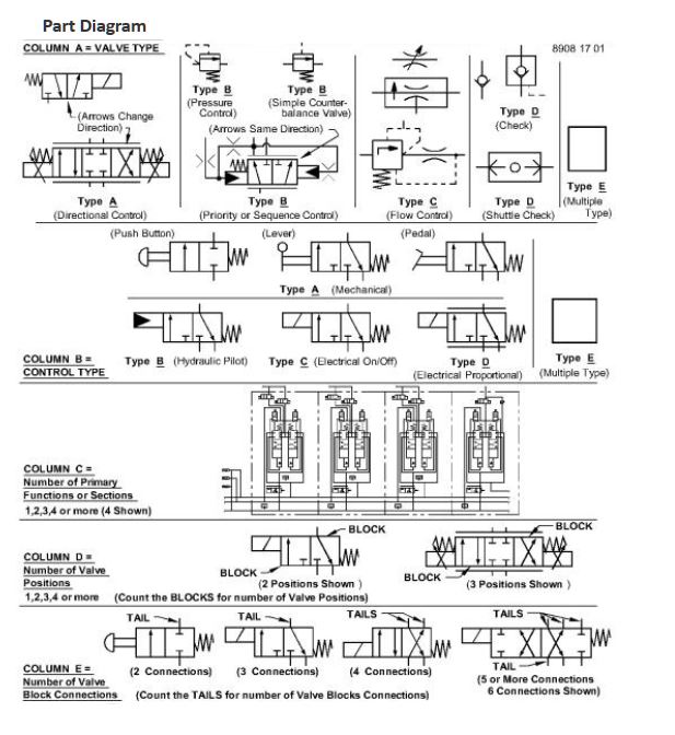

Here's the spec's on one valve
Try this schematic for plumbing using remotes..

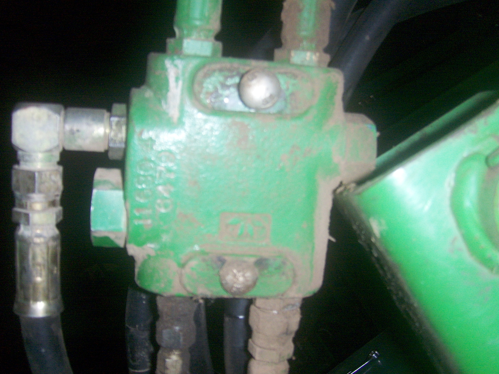

On my valve cast on the front is AW20908 (must be an old one) On the back are two rows of numbers
116804
6479
Also cast on the back is a small rectangle box. Inside the box are four leaves? fanned out. Maybe this is a trade mark of the maker?

   / Deere 260 loader on a 2940 #19
AW20908 subs to AW34774 Pressure Relief Valve ADD 1,085.51 USD
   / Deere 260 loader on a 2940 #20
Saw that in your post #17, that's what makes me think I have an early loader.
