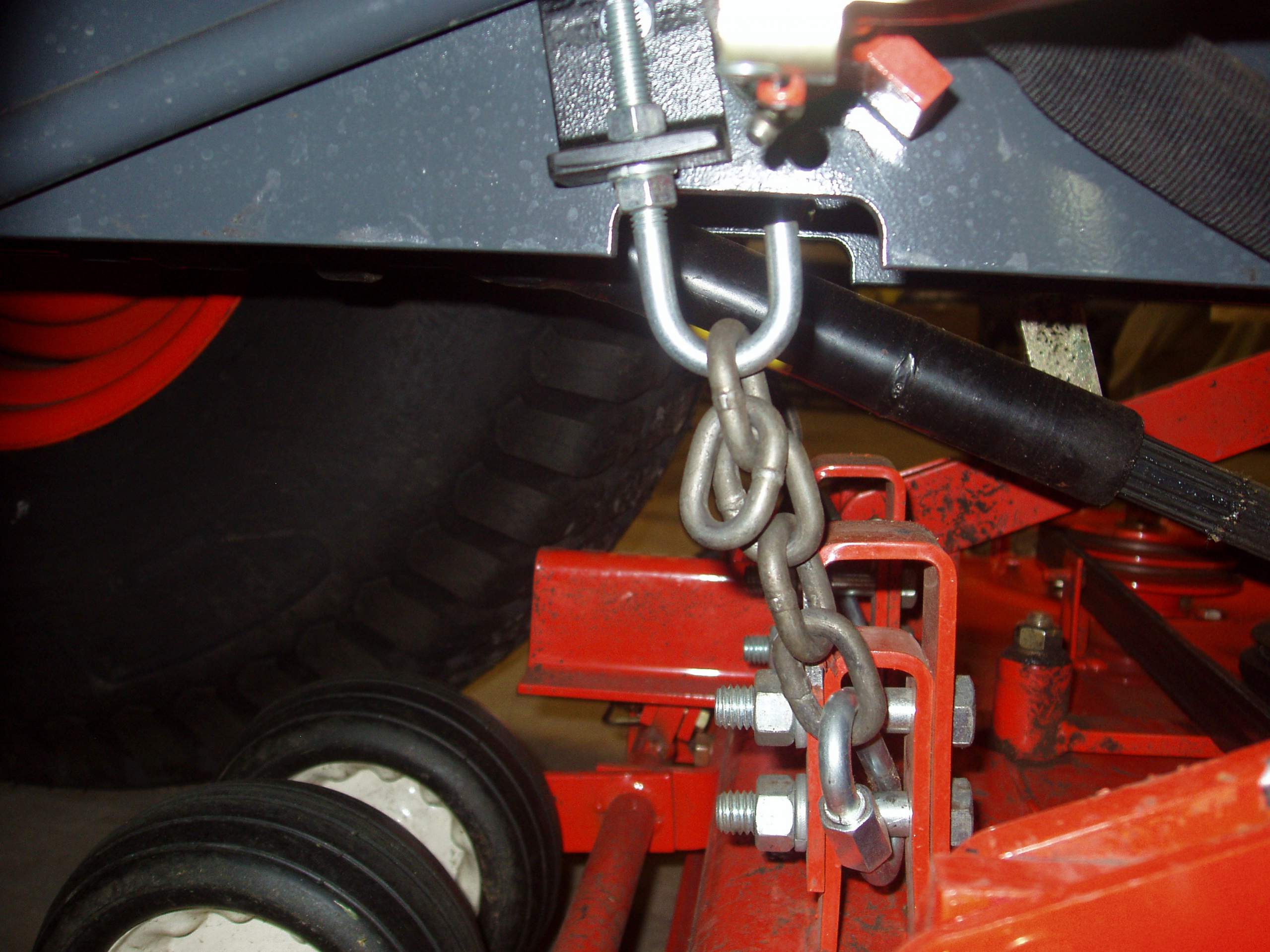

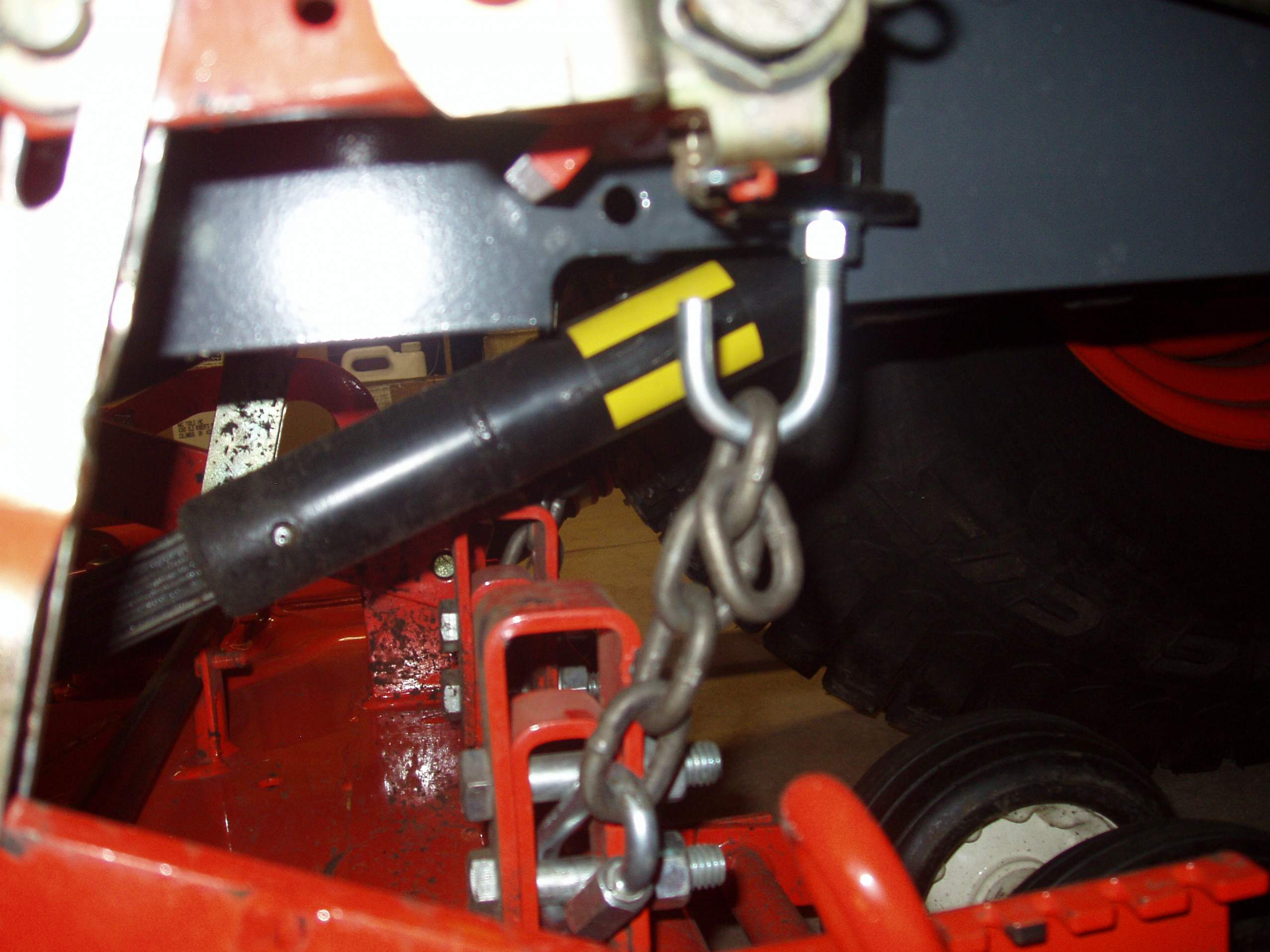

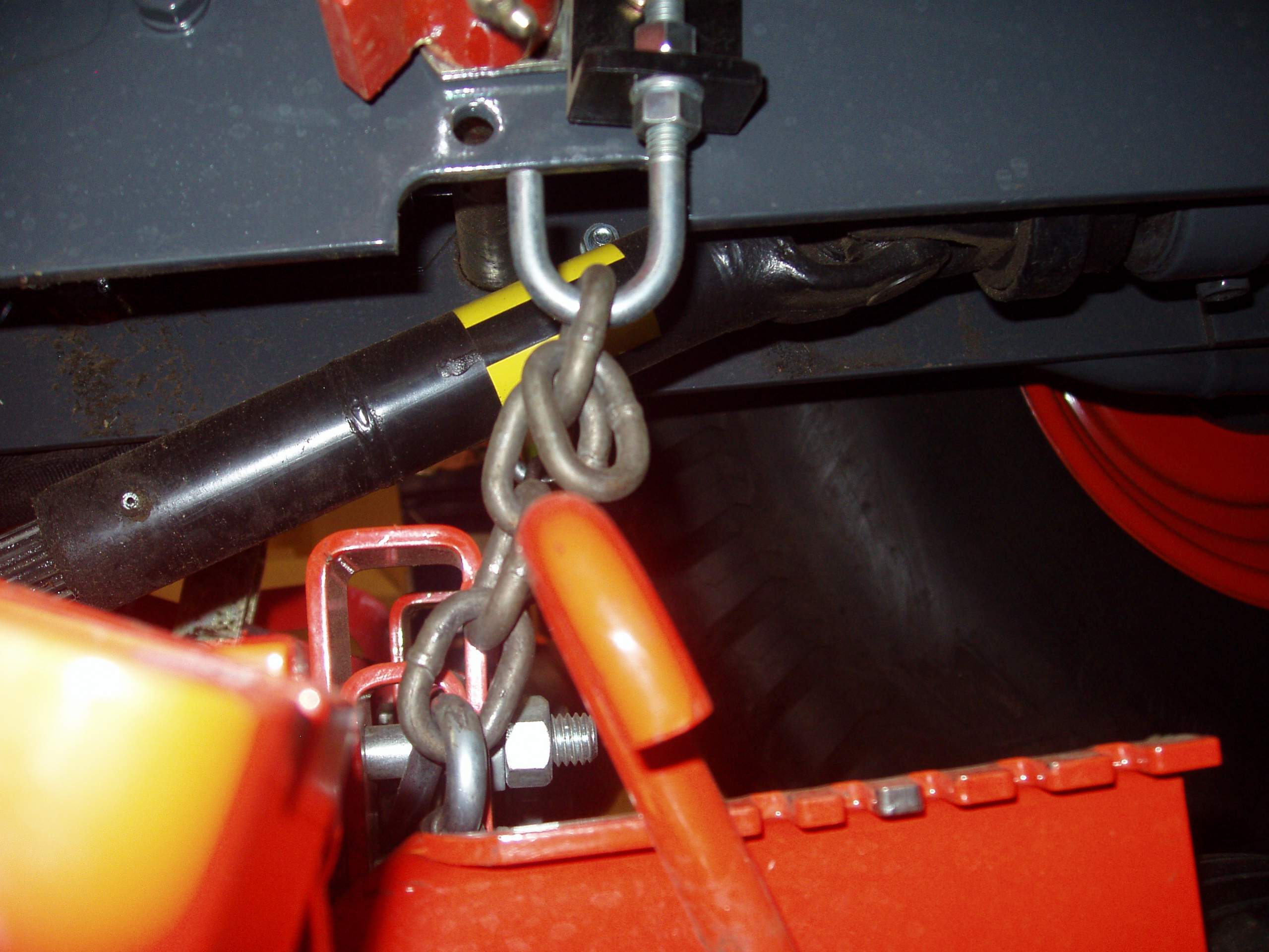

The Kubota 3 speed is worth more than any advantage the JD has. I have a B3030 and have a 60" MMM mower that I easily converted to a semi-suspended deck. I eliminated the two center wheels and use chains to hold the deck up. I fabricated some hooks and brackets under the frame to attach the chains to. See the pictures below.
The 3 speed HST allows me to mow in "M" range. AT WOT and full hydro pedal it is about 5 mph according to my GPS. It is the perfect speed when the ground is smooth. Very easy to hold the speed steady as all you have to do is push the pedal all the way down. The B2630 and B3030 also have the best power steering I have ever used. One finger steering in any conditions. Makes turning corners a breeze. I, too, have owned JDs and like them but, between the JD2520-2720 and the Kubota B2630-B3030 the Kubota is the clear winner IMO.
Since the pictures were taken I have removed the rear center wheels and the extra link on the chain. I adjust the chain length so that on a level surface the front wheels just barely touch the ground. That way they act as anti scalp wheels. I really like how much better the cut looks without the tracks the center wheels leave. That is the main reason I used the chains to carry the rear of the deck. If you get a 72" MMM then the standard wheels should be OK. Good luck.

It is easy to suspend the deck the way I did. I used inch and a half by 1/4 angle iron to make the brackets that bolt to the tractor frame. The holes in the frame were already there. I used 3/8" J-hooks from a hardware store and 5/16" chain. The chain is attached to the deck with 3/8" quick links. That is all it takes. Park on a hard level surface and adjust the chains to the height you want to cut. I set mine to 3 to 3 1/4" inches. I have used the chains for 4 full seasons and they have held up well. They do wear some so every year I re-adjust the hooks to take up the wear. The deck is built very heavy duty and does a great cutting job. I think you will really enjoy owning a B2630. I test drove one at the dealership where I bought my B3030. The B3030 never lacks for power. I am sure the B2630 has more than enough. I like the turf tires. They are more aggressive than one would think. Great traction on dry ground and snow.
