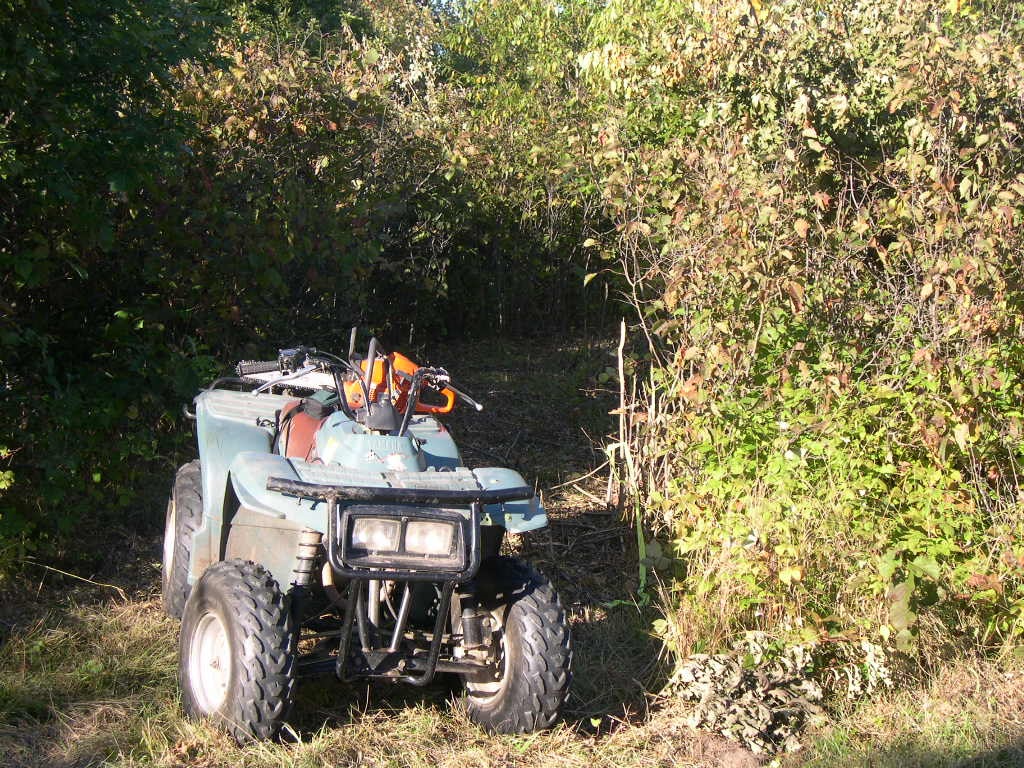

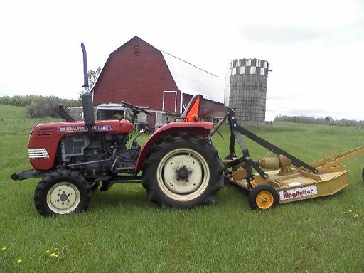

I cut through 8' brush with a 15 hp Shibara and a 4' rotary cutter. No real hills though. Just be careful on sidehills because these tractors can be pretty narrow. You will like that diesel power and the flexibility of a tractor.
   / Deere 318 vs Yanmar YM240 #5
   / Deere 318 vs Yanmar YM240 #6
Between the uneven ground and the short wheelbase, the front of the mower would often dig into the ground. I put a pair of guide wheels from a baler pick up on the front of the mower, and no more gouging.
By the way, I would literally drive right through that 8' brush with that little tractor and mower. There were no trails, just solid brush. I would walk it first to flag stumps and cut any stems over 1 1/2". It made quite a clatter, but it was amazing what that little tractor would do.
