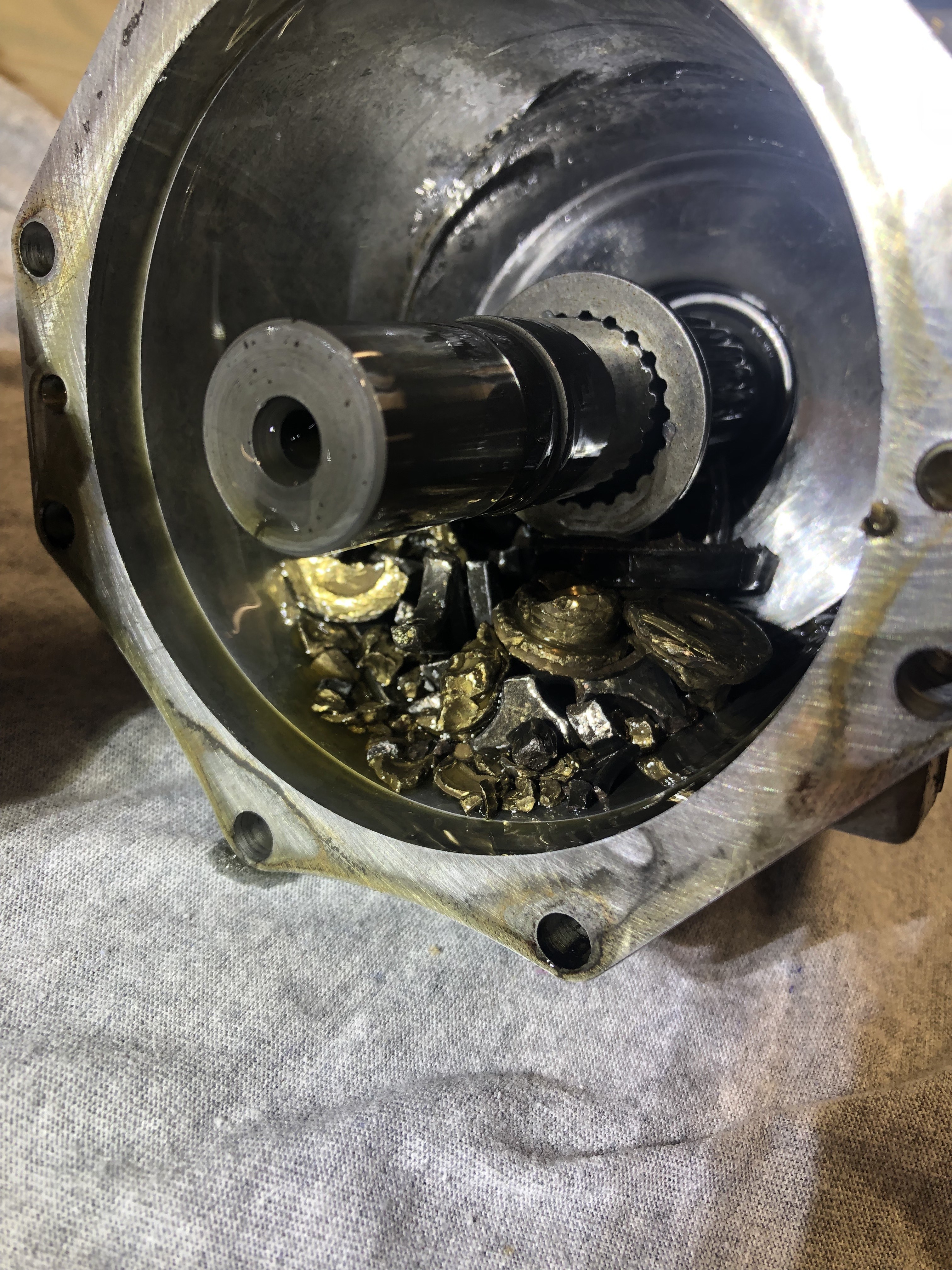

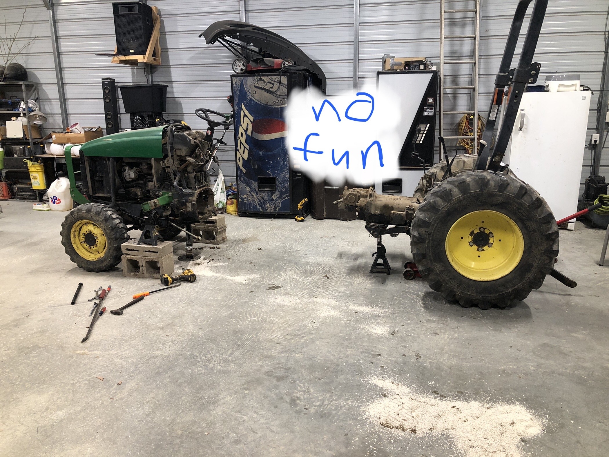

Guys I am so sorry for not getting back to you. This forum was sending me updates to my email when I got replies but I never got any emails so I thought the thread died. But I came back here to update everybody on the fix. Apparently the guy we loaned this out to finally told us it came off the trailer while he was driving it and the back wheels touched the ground which made the hydrostat motor grenade on the inside.
The little brass shoes at the end of the pump just broke into pieces and score the housing up and damaged a couple other things up in there. I split the tractor and found the issue pretty quick. There was some brass pieces and steel in the tunnel of the tractor but they never did make it to the screen or else I would have found the problem faster.
Found a used hydrostat motor for $1200 shipped online. Installed it, all is well. Currently has about 10 hours on it since I fixed it. Thanks to everybody with your helpful suggestions, wish I would have known it fell off the trailer instead of just being driven off. The "buddy" is going to pay for all parts and etc for this.
For anybody scared to split the tractor, it was actually very easy being my first time. It was just time consuming but not complicated at all.

Thanks so much for the follow-up post on this. Assuming the tractor was parked in neutral, curious why rear wheels moving would grenade the hydro motor. Was it the sudden jolt or excessive speed?

I'm going to assume it was in gear. He wasn't going far with it so he didn't strap it.
But yeah I don't see how it moved in gear unless there's more to the story, Can't believe anything the guy says anymore. Needless to say he wont be borrowing the tractor again!
   / Deere 4400 low charge pressure, won't move #26
This response is based on the assumption that the hi low range selector was not in neutral when tractor rolled off the trailer when trailer was being towed.
If range selector was in gear them the HST motor is connected to the drive train and would act like a pump. The motor now pump would then try to drive the HST pump like a motor. The motor would be at full displacement and pump at minimum displacement so motor would see high pressure but no charge pressure so there would be no “return” flow to motor inlet causing the piston slippers to lift off and self destruct like in the pictures.
Like others said thanks for posting the problem and solution.

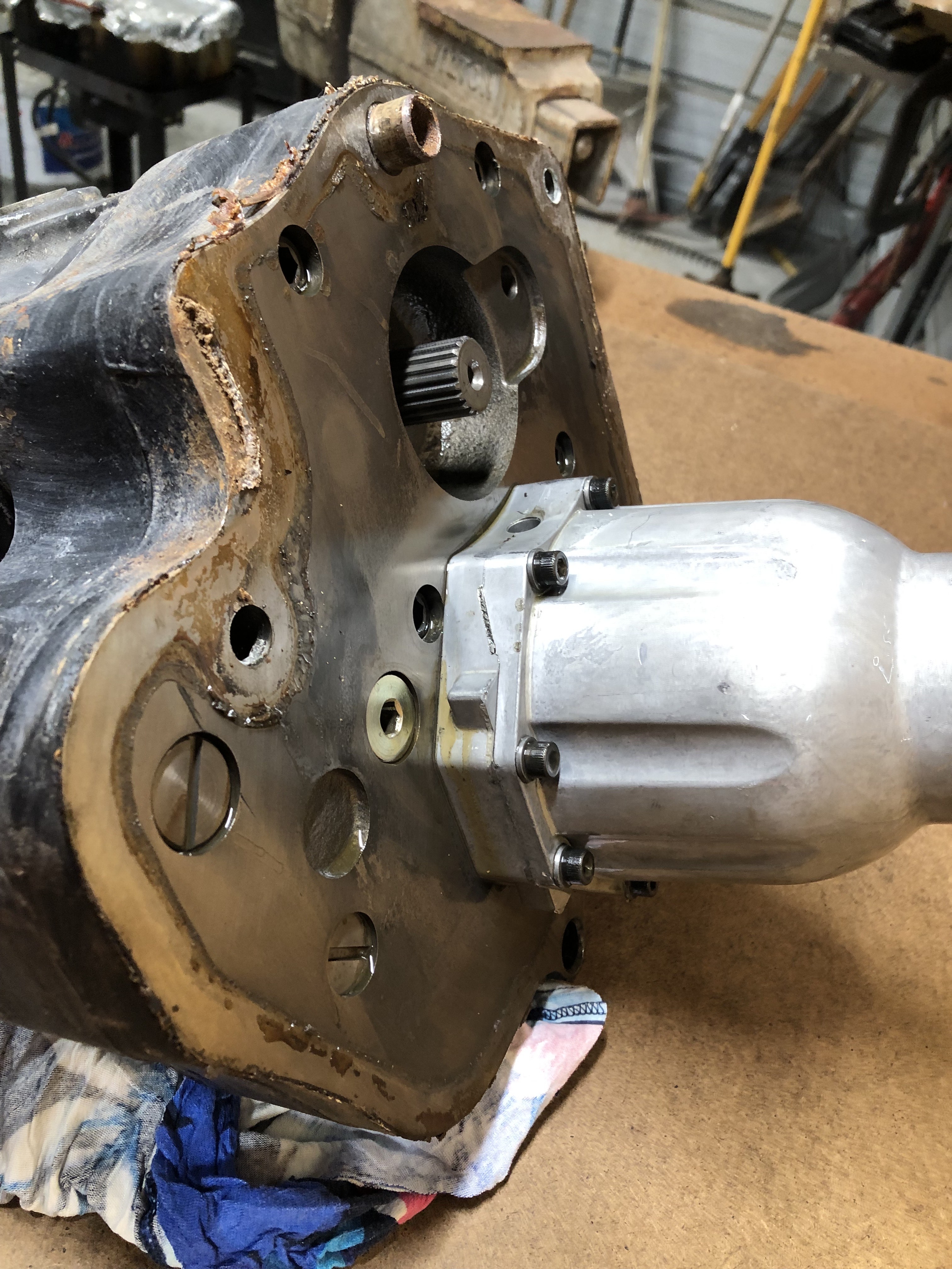

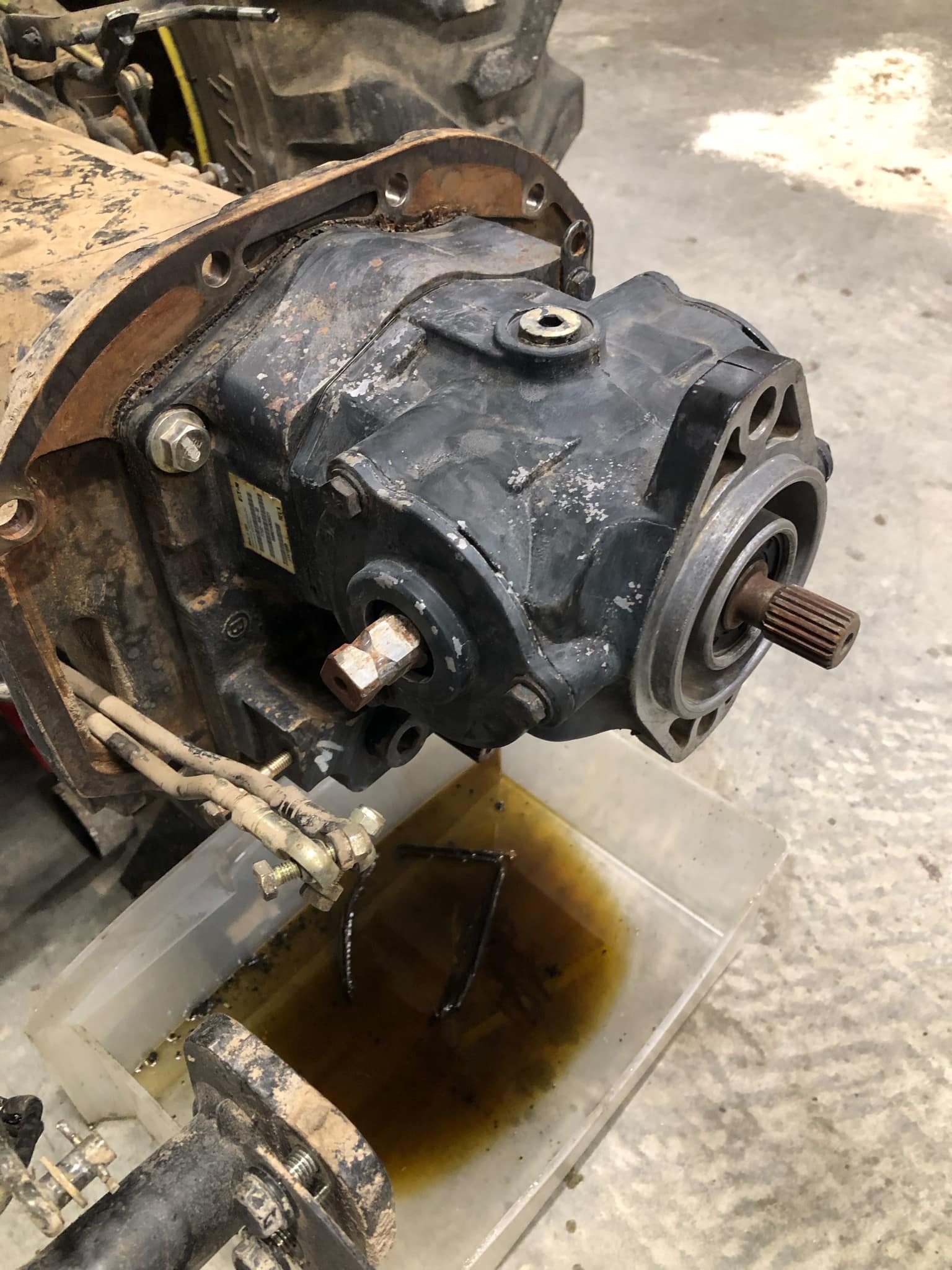

Lemme post some more pics in case years from now somebody stumbles upon my thread and this helps them out. Also anybody needing the manual dm me or cheapest I could find is $20 on google.

Thanks for posting those additional pictures of that damaged motor.
