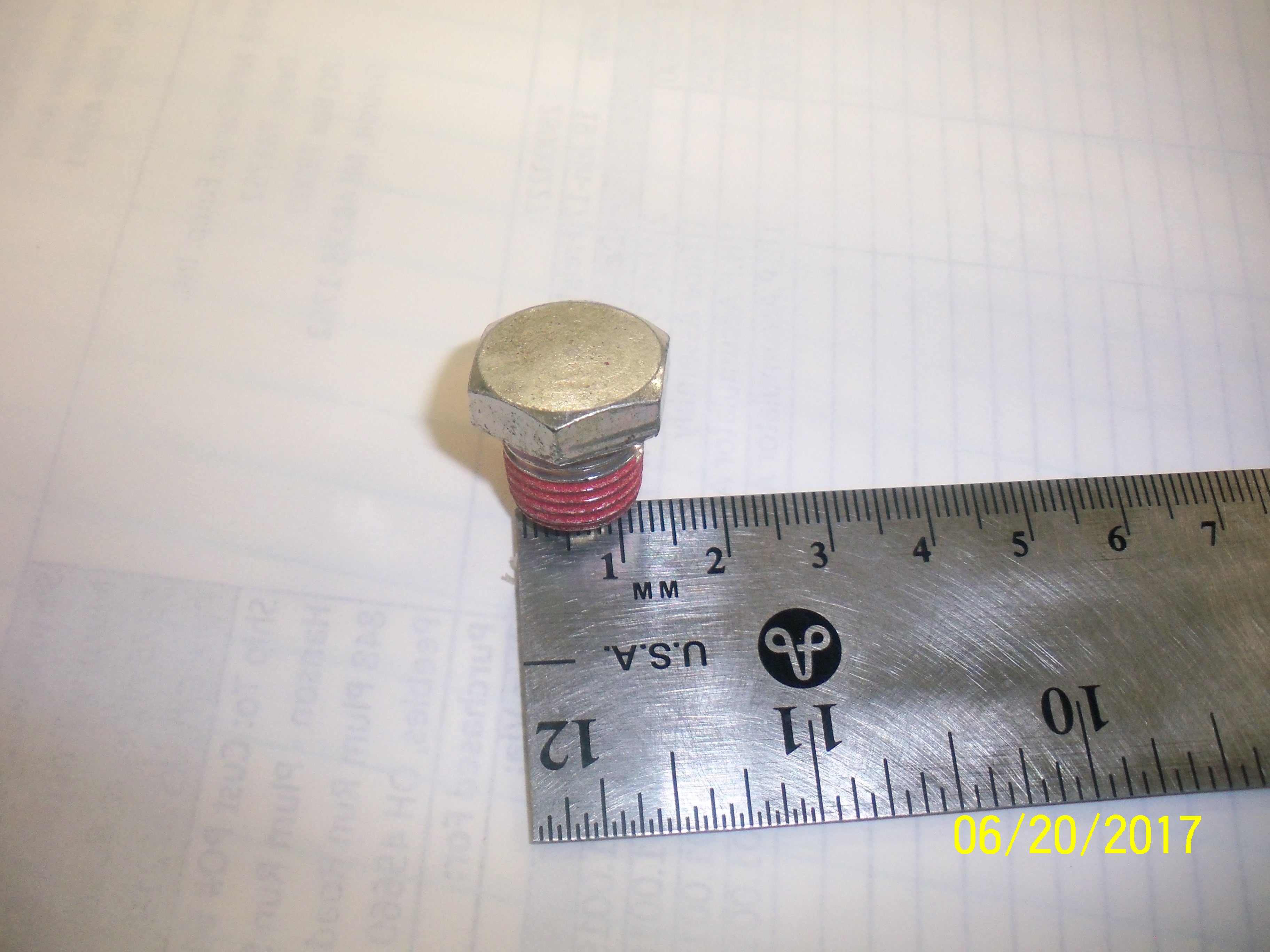

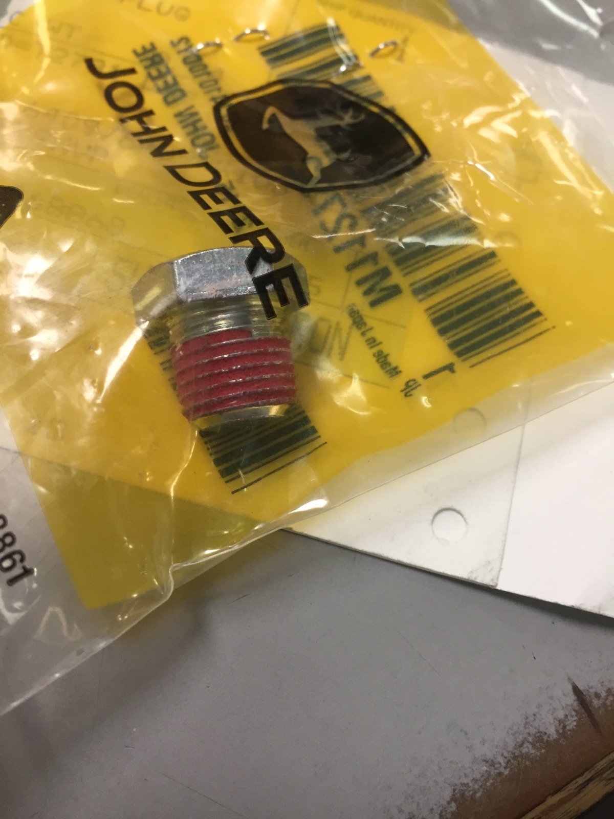

You should be able to find a petcock with the correct size thread. My best guess it metric pipe thread, since it's called a plug and after looking at the pictures. Take your ruler and check out the hardware and auto parts stores.

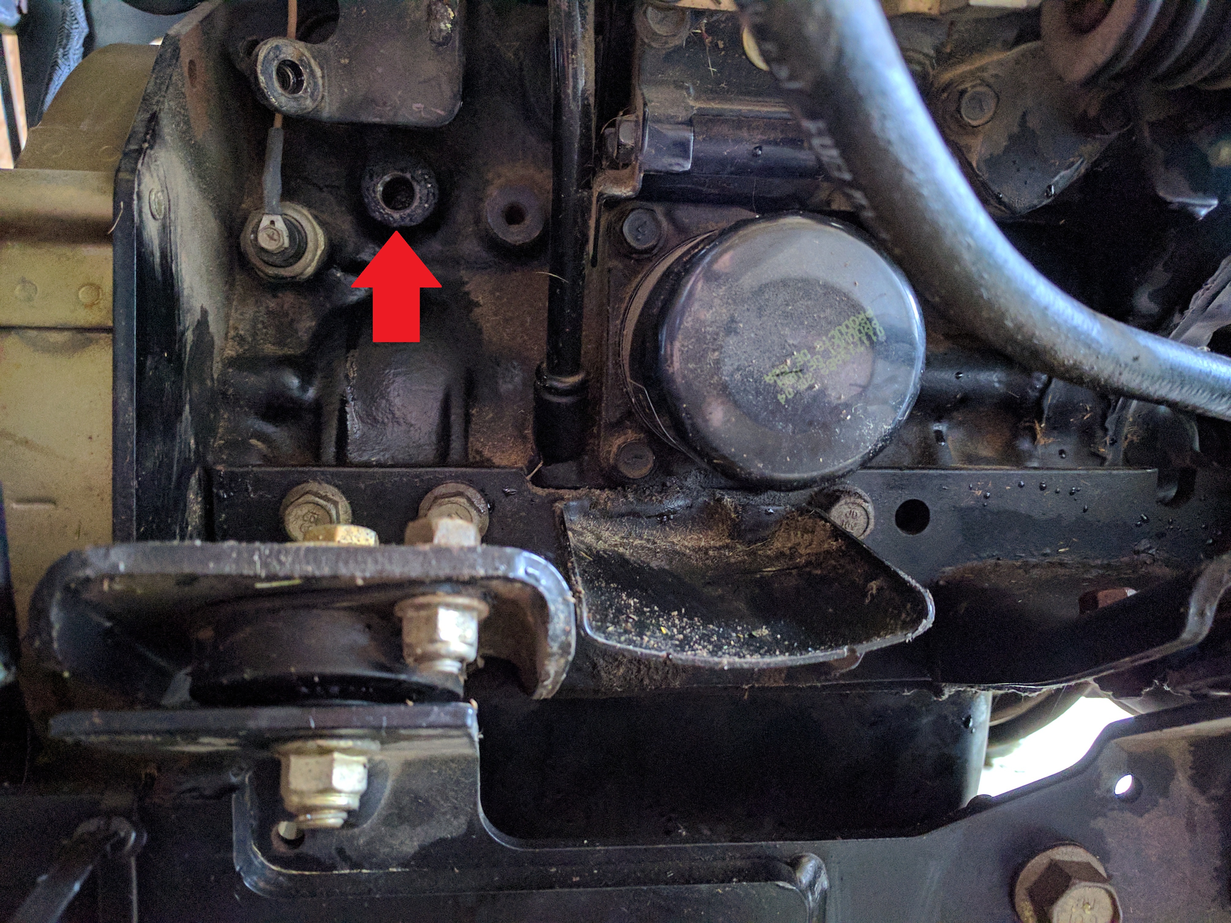

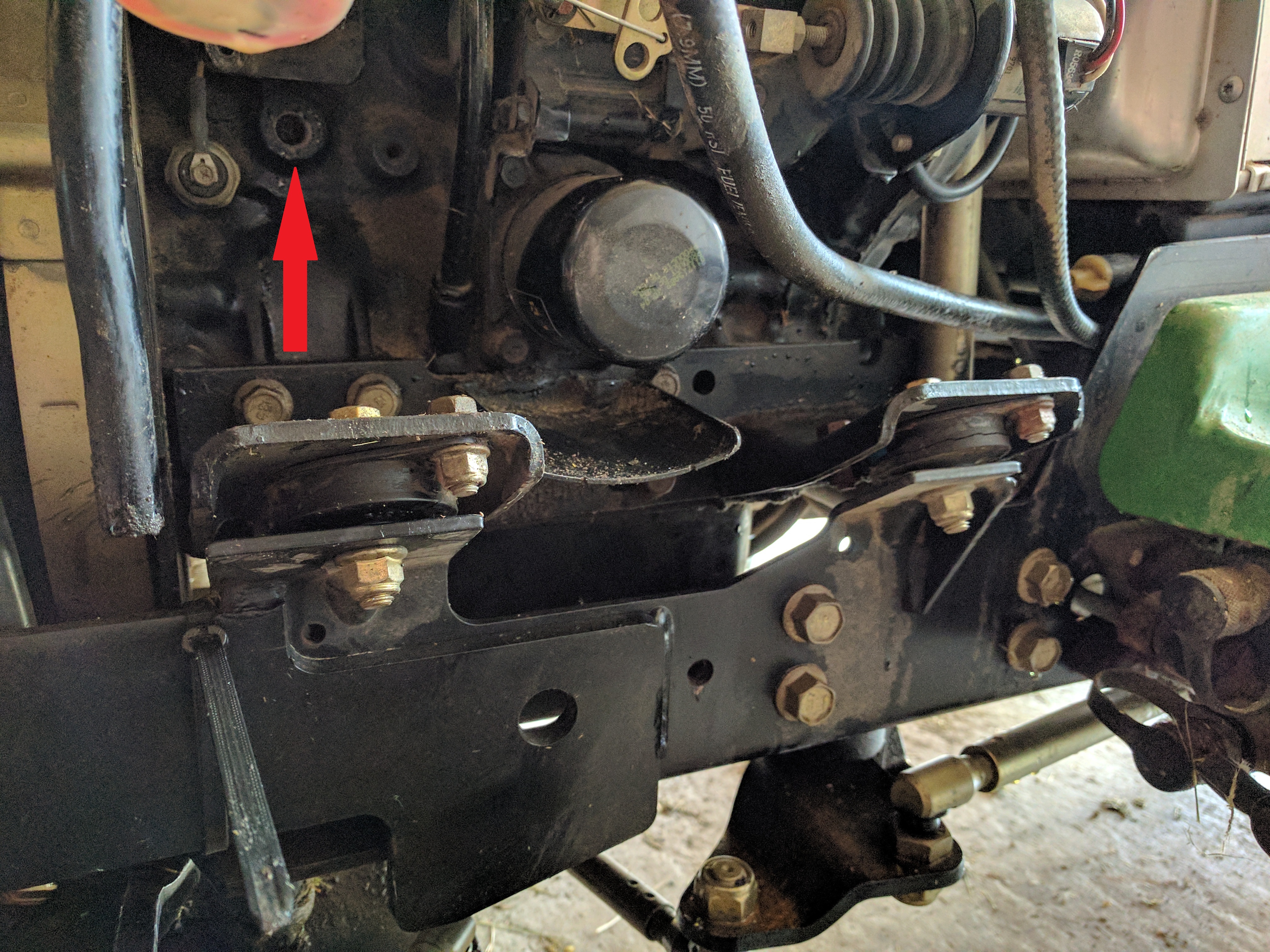

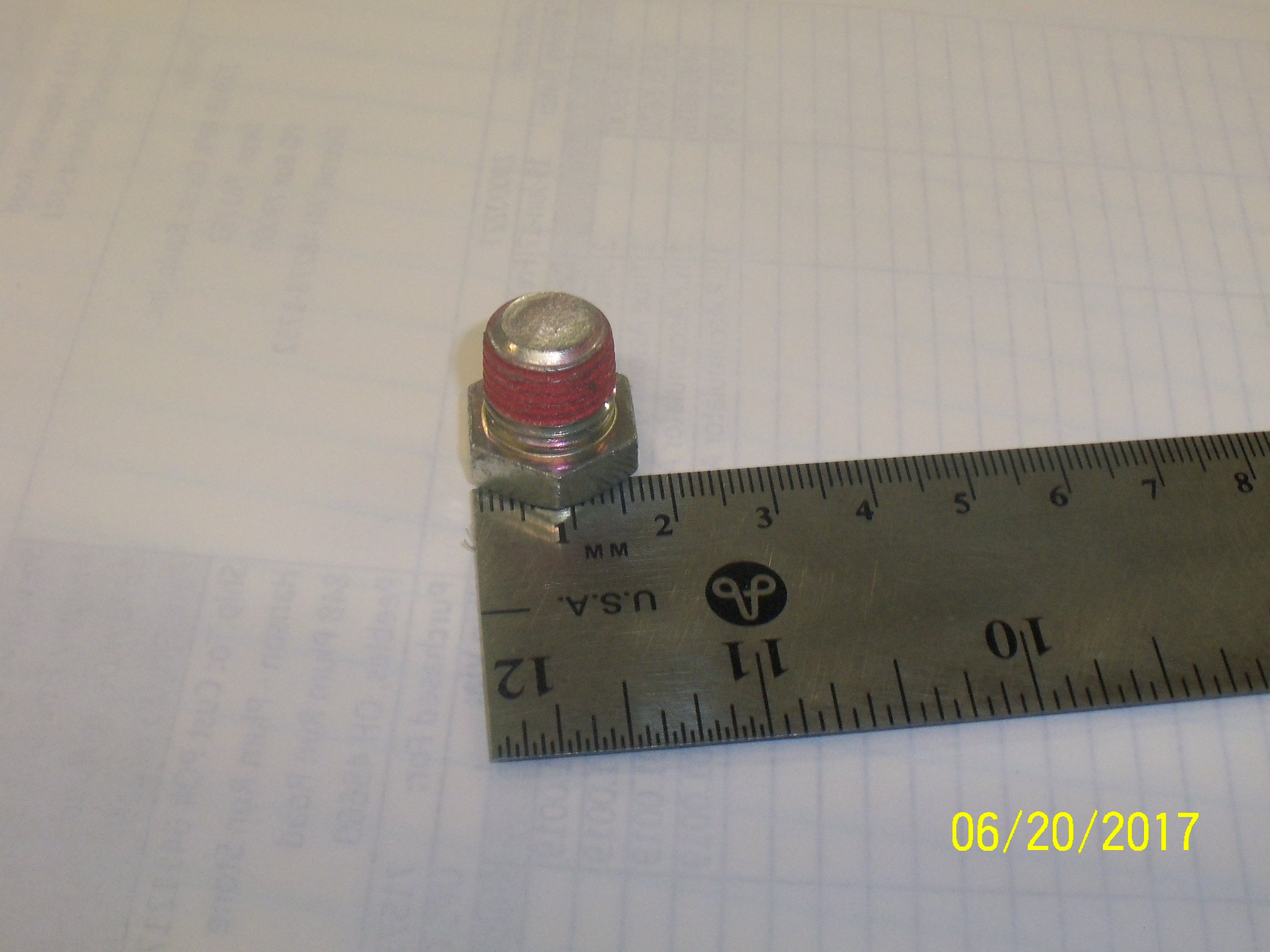

I drained all the coolant on my Deere 455 tonight. Unfortunately, the metal coolant drain plug bolt on the engine has been lost.Any suggestions or advice would be greatly appreciated.Mike
Mike, You did check the container into which you drained the old antifreeze I hope? For that kind of price I would look harder for the original plug.

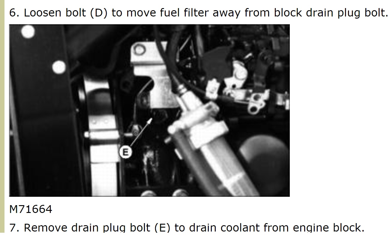

That plug sits directly behind the fuel filter unit, so suspect no extra room for a petcock.
I'd be getting one from the Deere dealer.. if were me and I was the one that lost it.. the price to pay :D

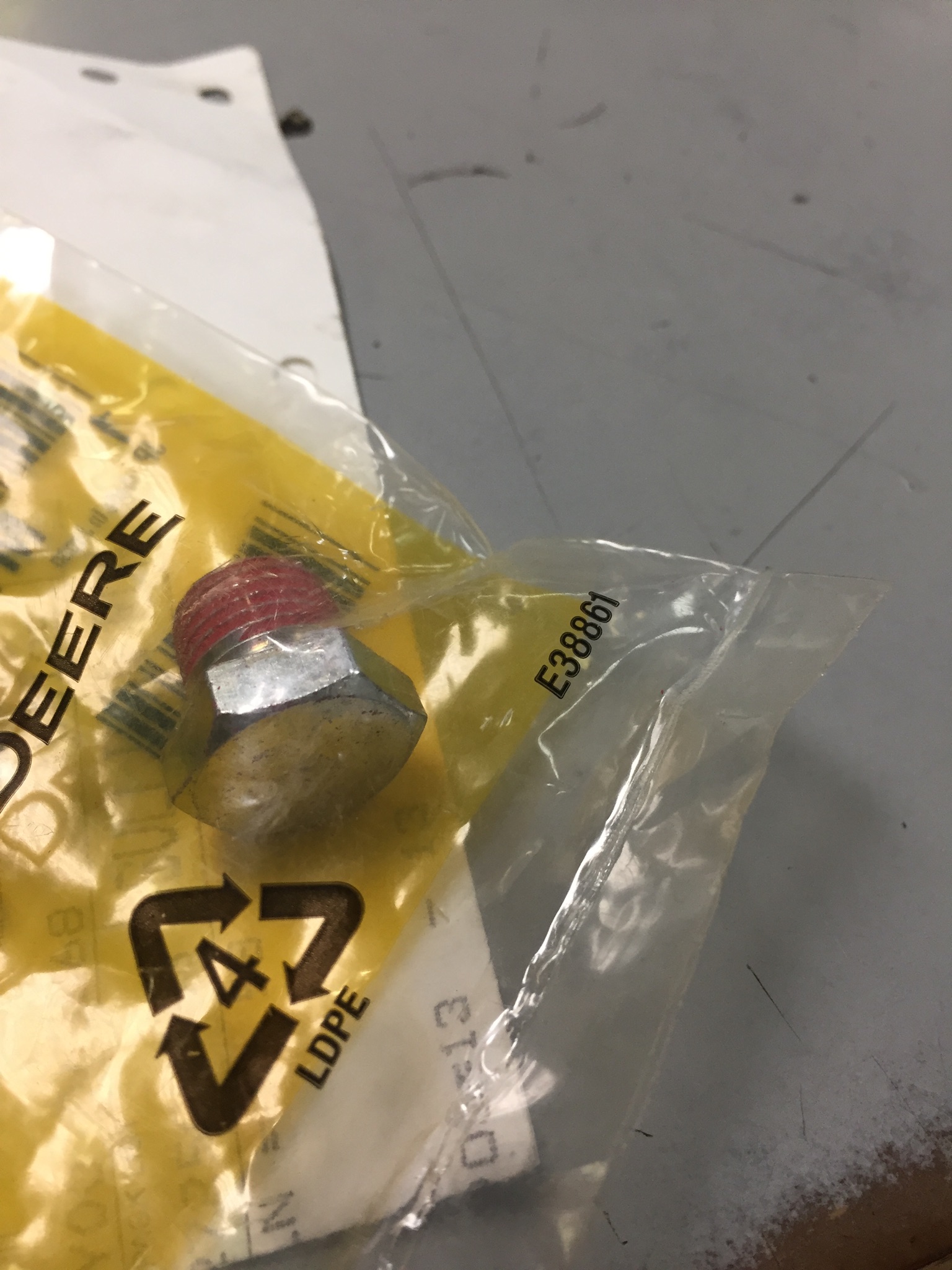

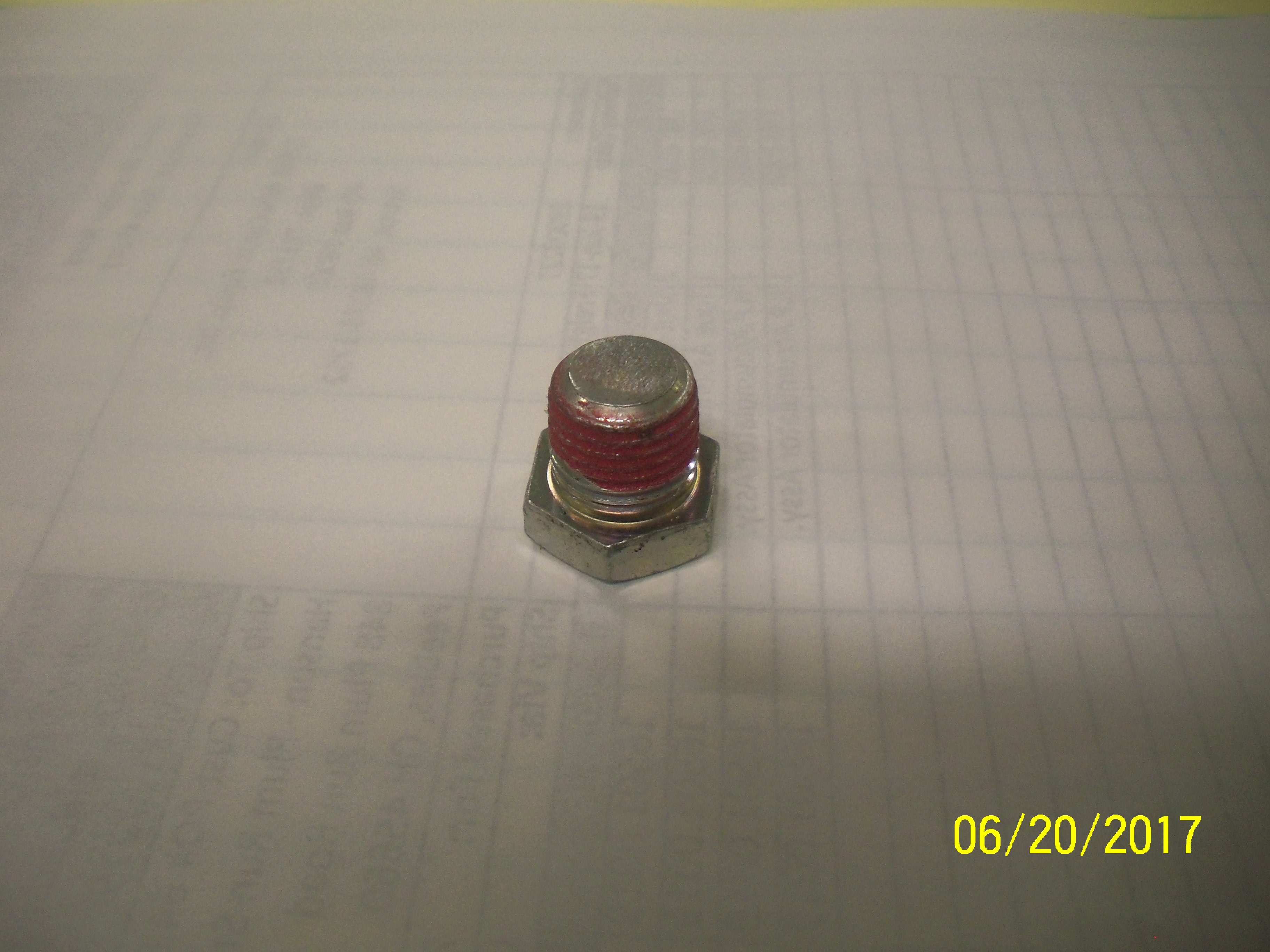

Yes, I did look in the drain pain. No luck. If anyone has any advice I am all ears. Also, I updated my original post with photos of the original bolt.
