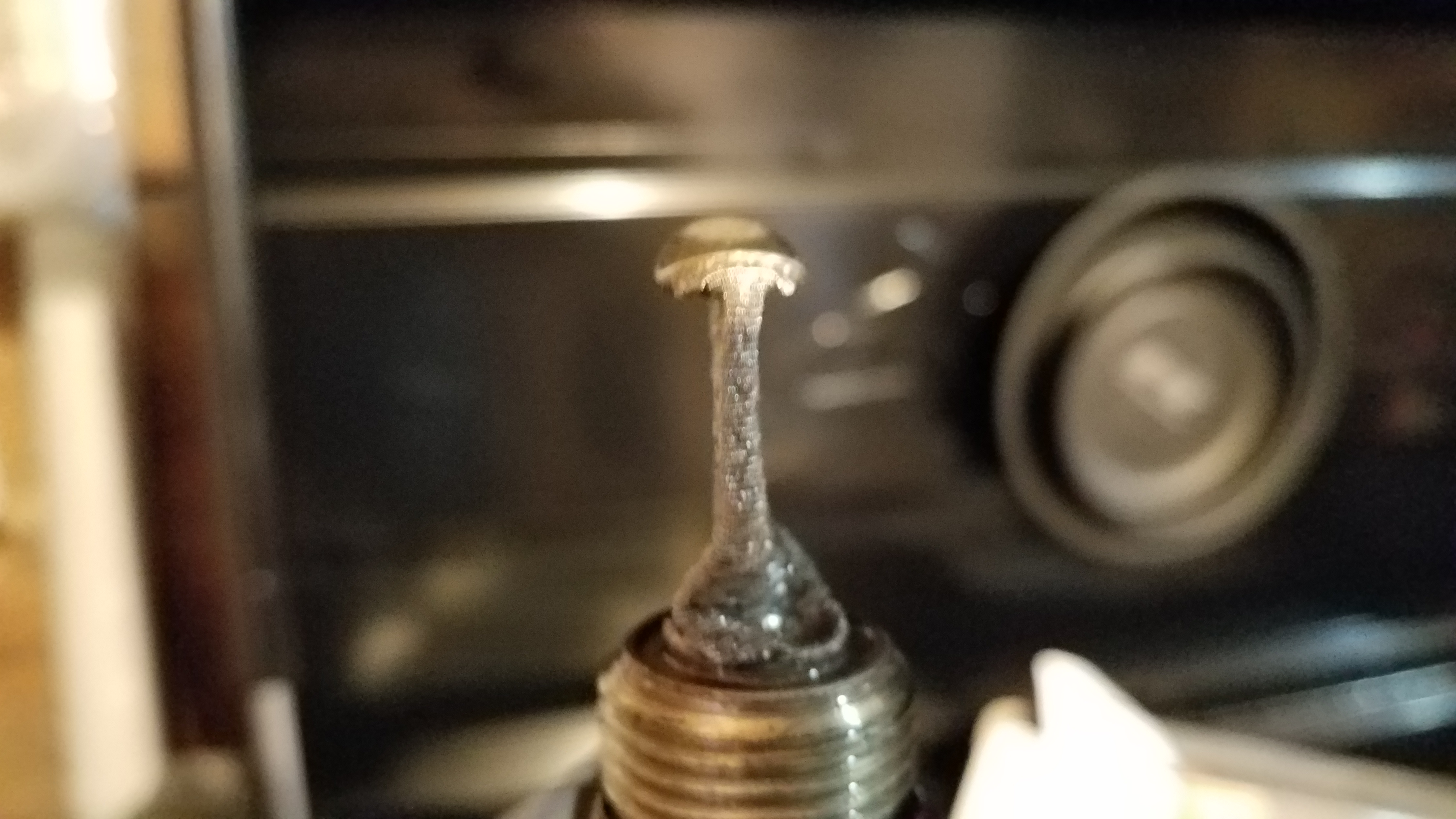

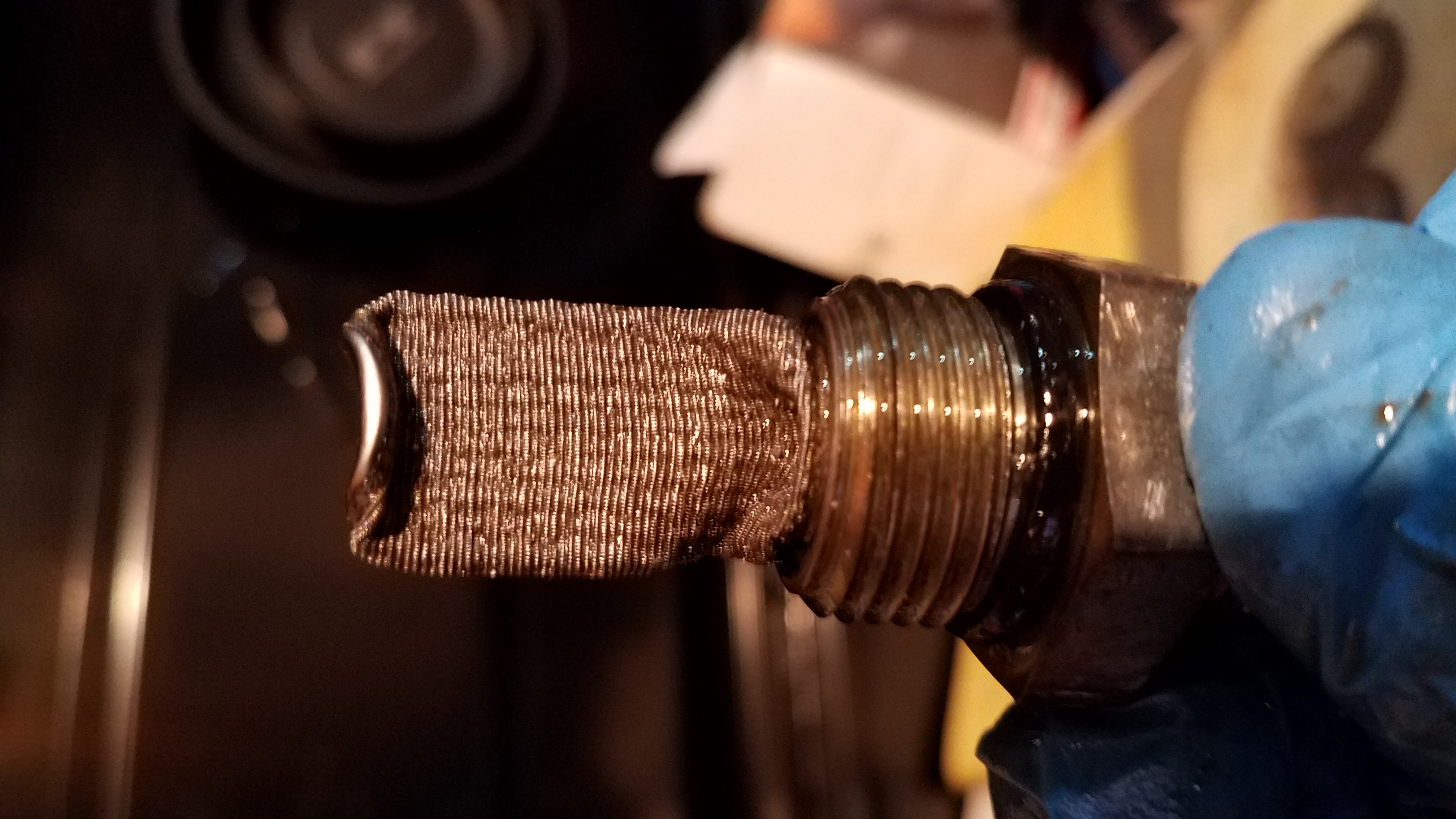

Somehow the inline filter screen was flattened on itself inside the hex housing. It did not look dirty. I have a new one one the way. No idea why 5his happened.

Yes, me too but why did it fold in on itself?
   / Deere 4720 Hydraulic Drive Probelm?? #20
Good question. Unless it was physically damaged, only pressure or vacuum could act on it or both. It it got clogged the pressure differential probably did it in. You need to look at it under a microscope for what might have clogged it.
Hate to tell you this, but if your oil got really, really hot, you might want to change it. Not sure if there is a "smell" test or anything to make sure it is good. I'll let the hydraulics guys chime in here.
