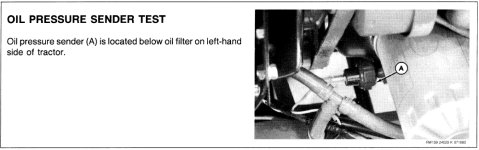

New to me John deere 750, just checking things over and my oil light is not coming on, got to checking and someone had the oil light connected to the temp sender, I grounded my extra wire and the water temp light came on, grounded the other wire and my oil light came on, between me and these bi-focals cannot find the oil pressure sending unit, have a manual ordered. Any help appreciated,

From the 750 maintenance manual. Located under the oil filter.

Finally found it, its right behind the alt. on the front of the engine, thanks Fot the help.
