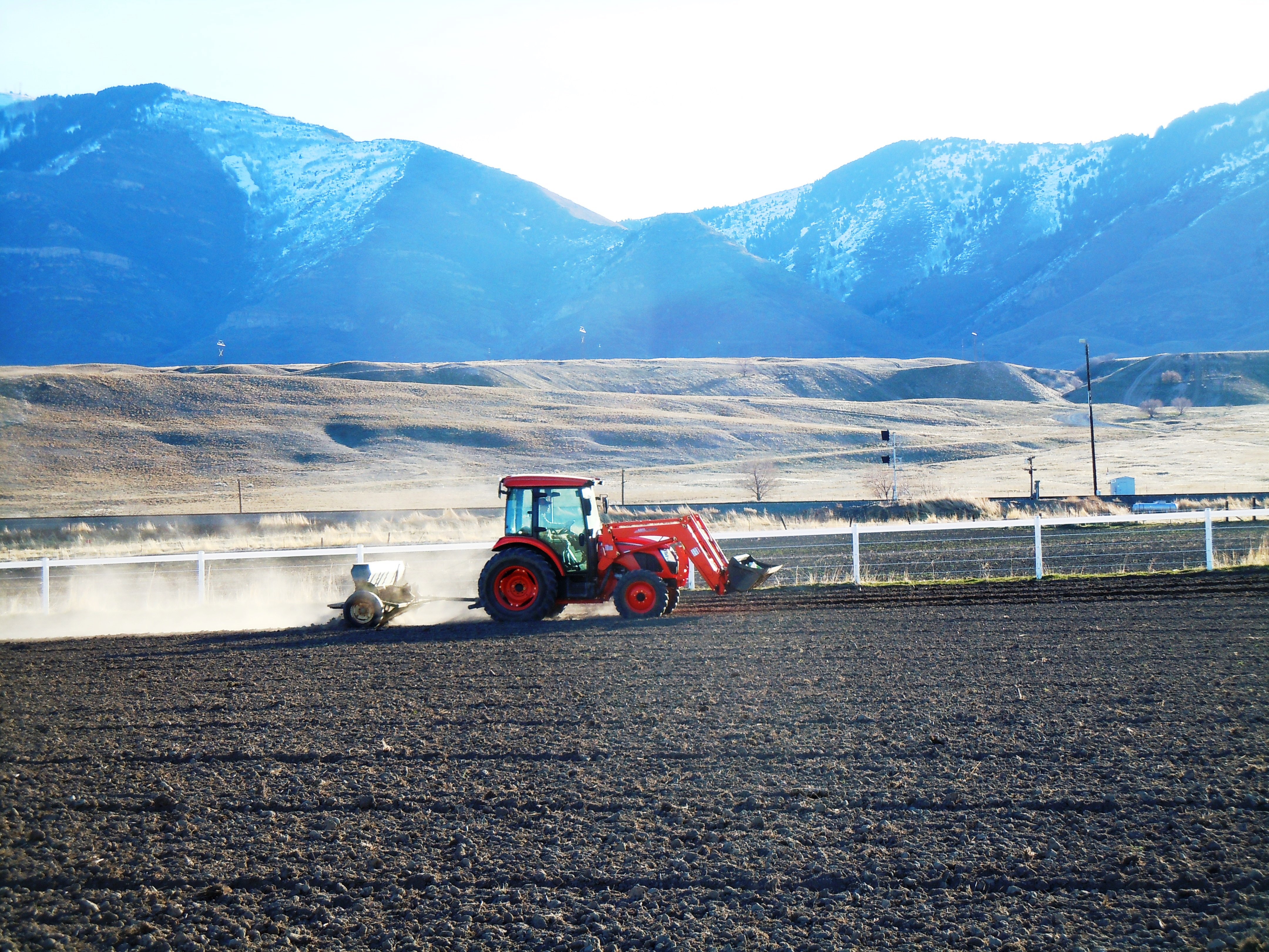

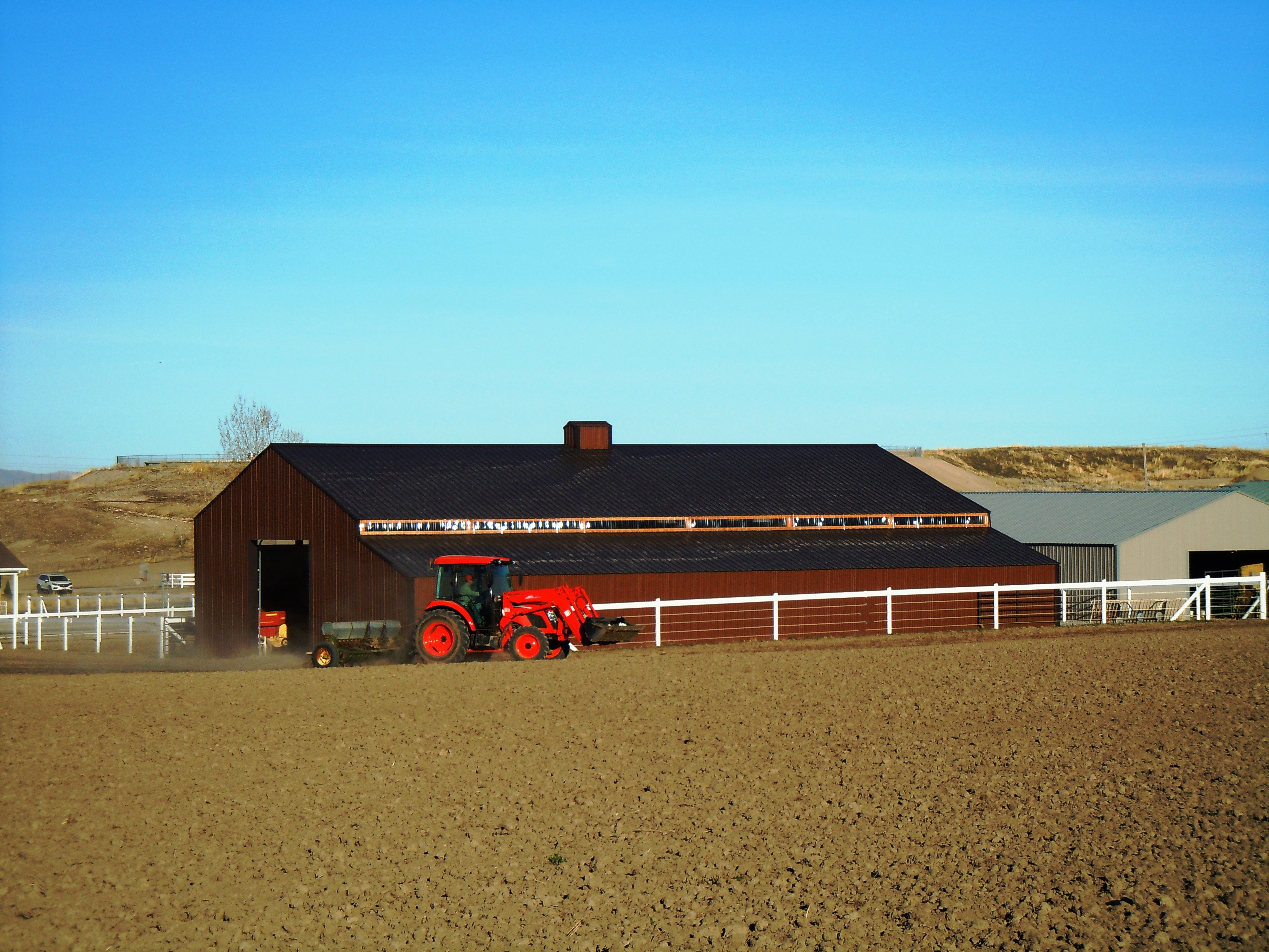

Price for that drill seems OK considering it's pretty good condition.
I paid $270 in 2006 for two old steel wheel Minneapolis Moline P3-6 drills (10 ft wide, 20 drops, single disc openers, with the additional boxes for small seeds). Used parts from both to make one working drill and one lawn ornament.
Pulled it with my 2008 Mahindra 5525 (overkill) and used it to plant about 7 acres of Kanota oats.

Stunning pics, Cat! You seem to have some photographic composition experience.
/ Deere B drill.. Your thoughts #8
Trust me, it's all luck. I have the cheapest Nikon "point and shoot" camera made.:laughing:
PS, most of the time it's my wife taking the pictures. You can see me in the tractor. The only thing I tell her is make sure the background looks good.

Nice drill cat fever. I've got it's brother in the barn. I have no idea how many acres my dad used it on. We used it for over 25 years planting soybeans and wheat. Those drills are stone cold reliable. I had to get a spring for the right side trip gear and Deere shipped it to me. Sorta dumbfounded that they still have limited parts support for those.
/ Deere B drill.. Your thoughts #11
I bought mine last year from the original owner complete with the owner's manual. This was the first crop I planted with it.
