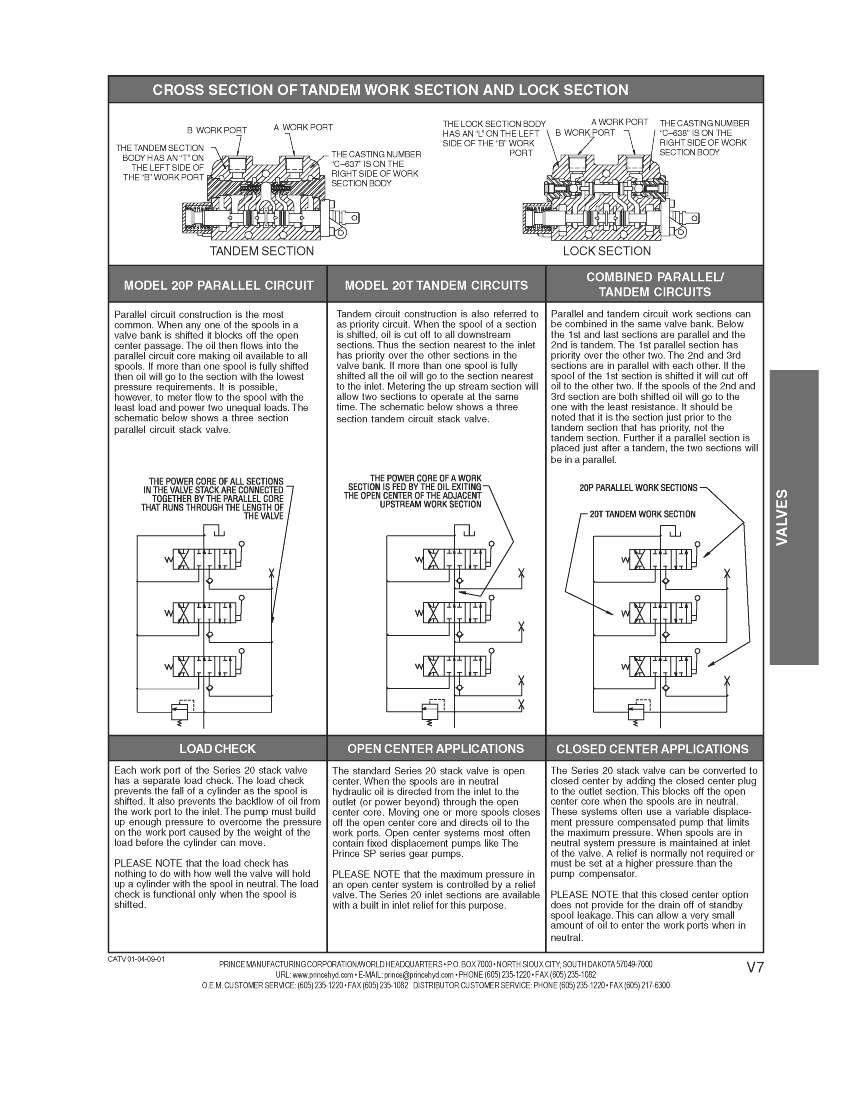

I think we are saying the same thing?
Mobile "parallel sections" have a distinct parallel passage.
If they did not, when more than one function was simultaneously activated, only the spool nearest the inlet would have any flow.
You are correct that to convert between a power beyond and non power beyond section a plug is usually installed or not installed in the outlet, that allows flow from the parallel passage to the tank passage.
When the plug is in place such that the parallel pasage can not drain into the tank passage, the valve is "power beyond" and whatever the power beyond port gets hooked to must have a path to tank.
I attached page 7 from the prince valve catalog that has a nice description of open center parallel passage.
JT
