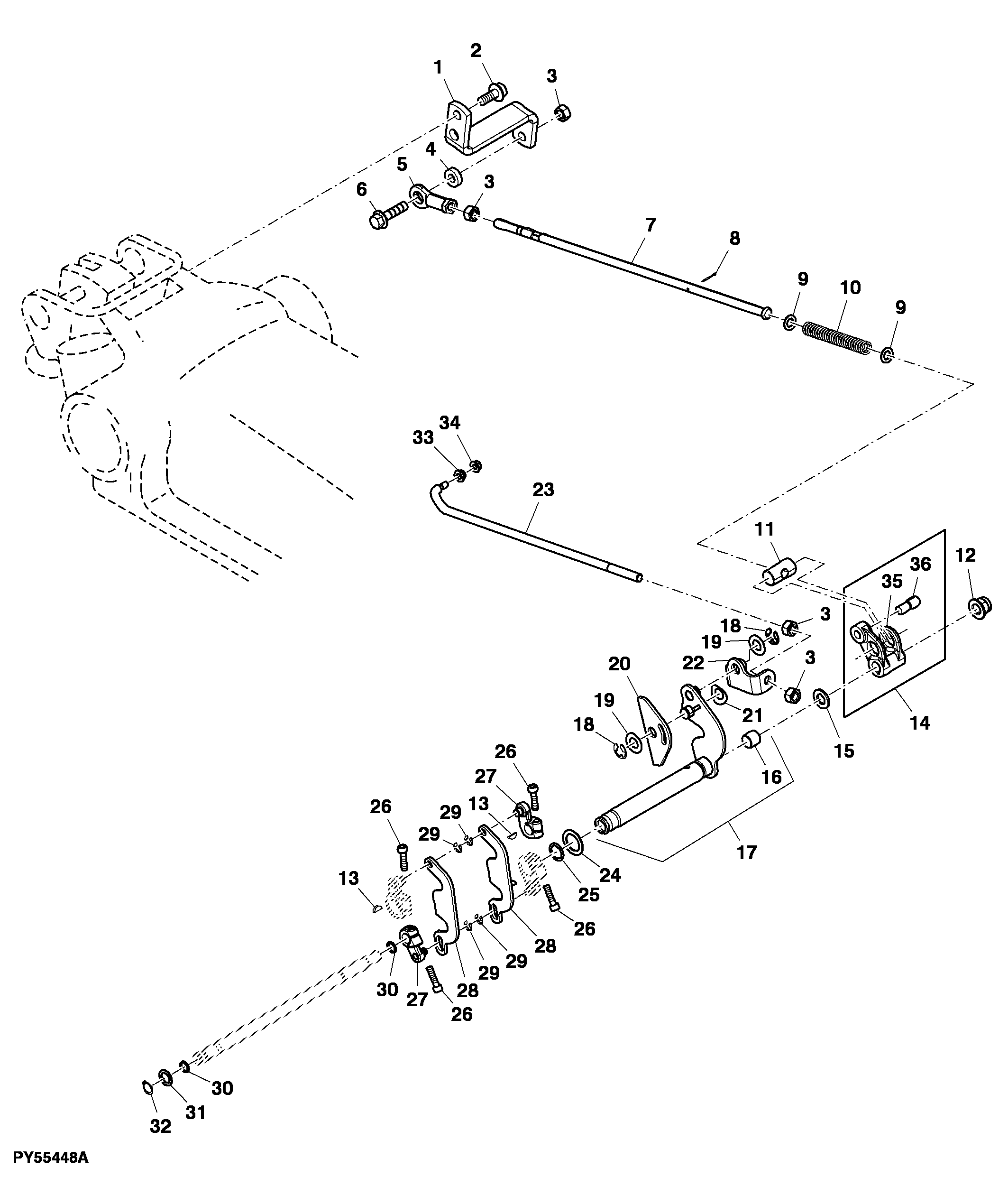

John Deere did pay around $800 in parts, but wouldn't pay for the dealer's labor. The dealer says he can't make the tractor get hot. He said he had replaced the rockshaft valve the first time, but it didn't fix the problem. The tractor has always made a hissing noise when the 3-point is fully raised.
If hissing noise is present when 3 pt is fully raised then the control linkage needs adjusting to allow control valve to neutralize in fully raised position. I'm guessing the feedback rod needs adjusting.
My 5303 does this. I can bump the lift lever down and it quits. I have had it do it in other than full lift locations in the range of movement.
