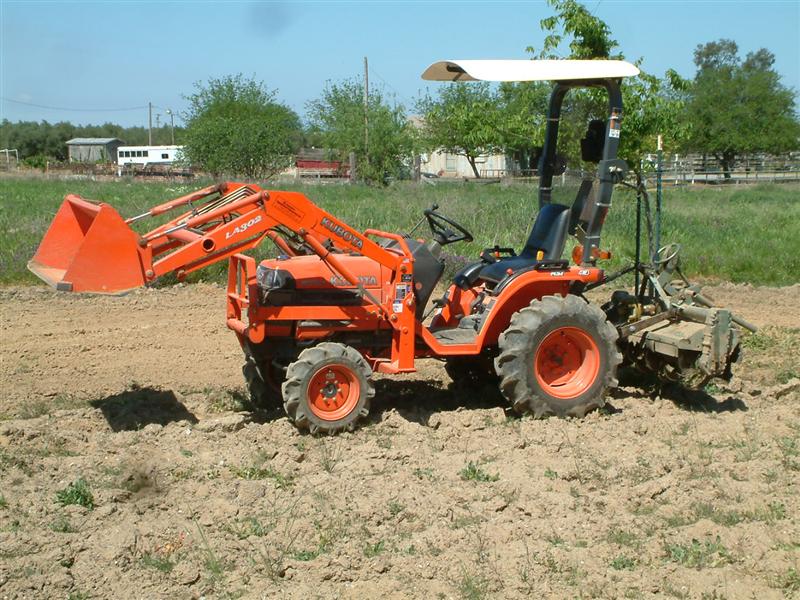

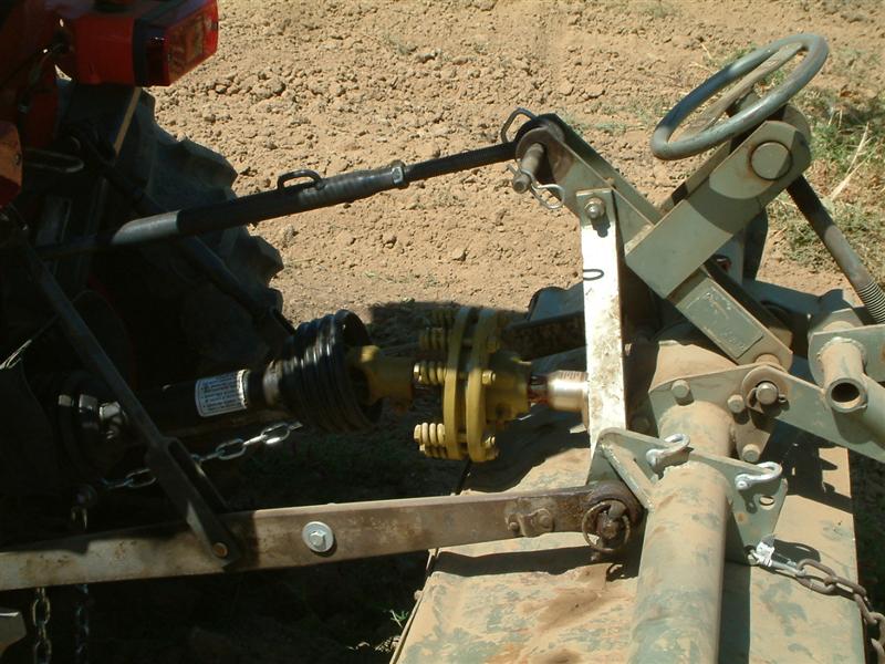

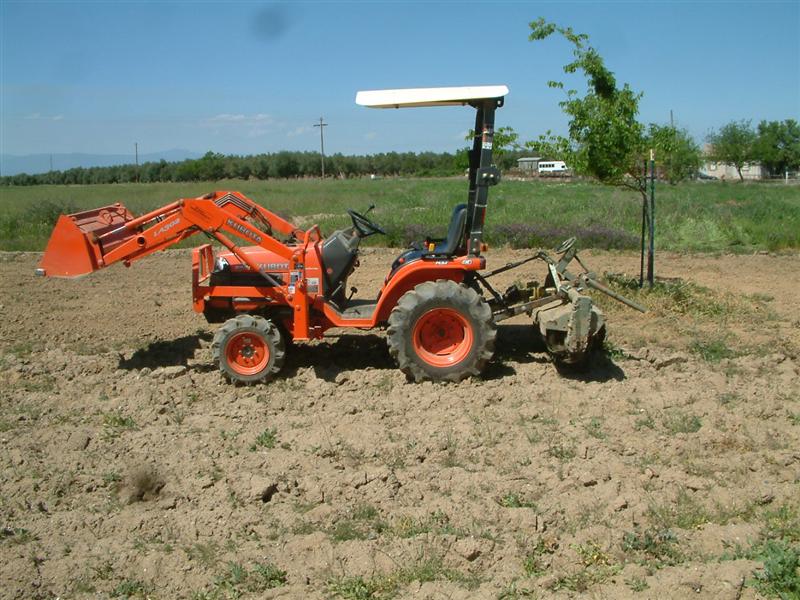

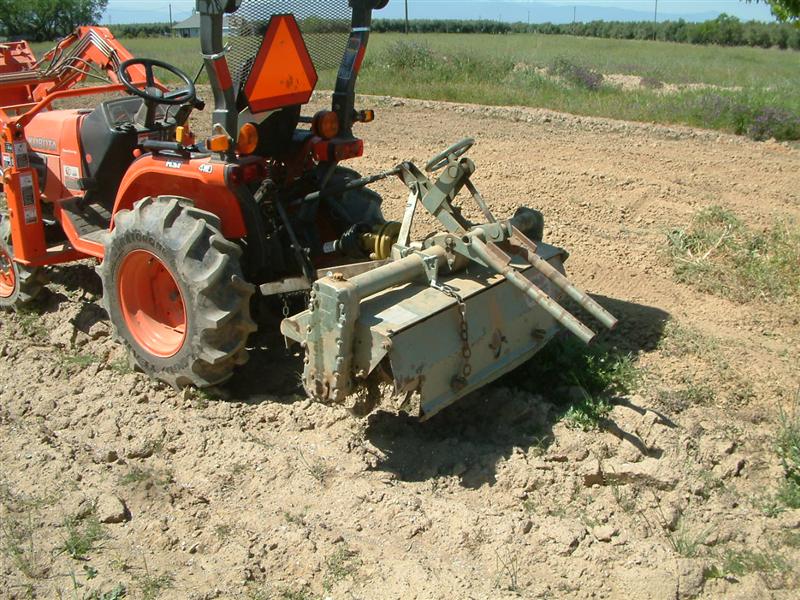

I had a similar situation. Bought a new Kubota B7510HST in May05 and later bought a used 4-ft Yanmar RS-1200 rototiller ($300 from my local grey market tractor dealer).
The tiller didn't have any shear pins so I had to get a slip clutch (the yellow thing in the 4th photo). To make room for the slip clutch, I had to use the 35" long lower lift arms from my MF-135 in place of the shorter 26" Kubota arms. Then I had to add a pto shaft extender on the rototiller so the slip clutch wouldn't rub on the tiller's sheet metal. The pto shaft that came with the tiller had bad U-joints so I had to buy a short pto shaft from Tractor Supply and then cut it to fit. Ended up paying about $170 for these new components.
With these mods the rototiller works fine. Tilled the veg garden and the new lawn areas around the house with no trouble.
I mention these things to give you an idea of some of the little problems you might run into when you want to use "foreign" attachments on your tractor.
