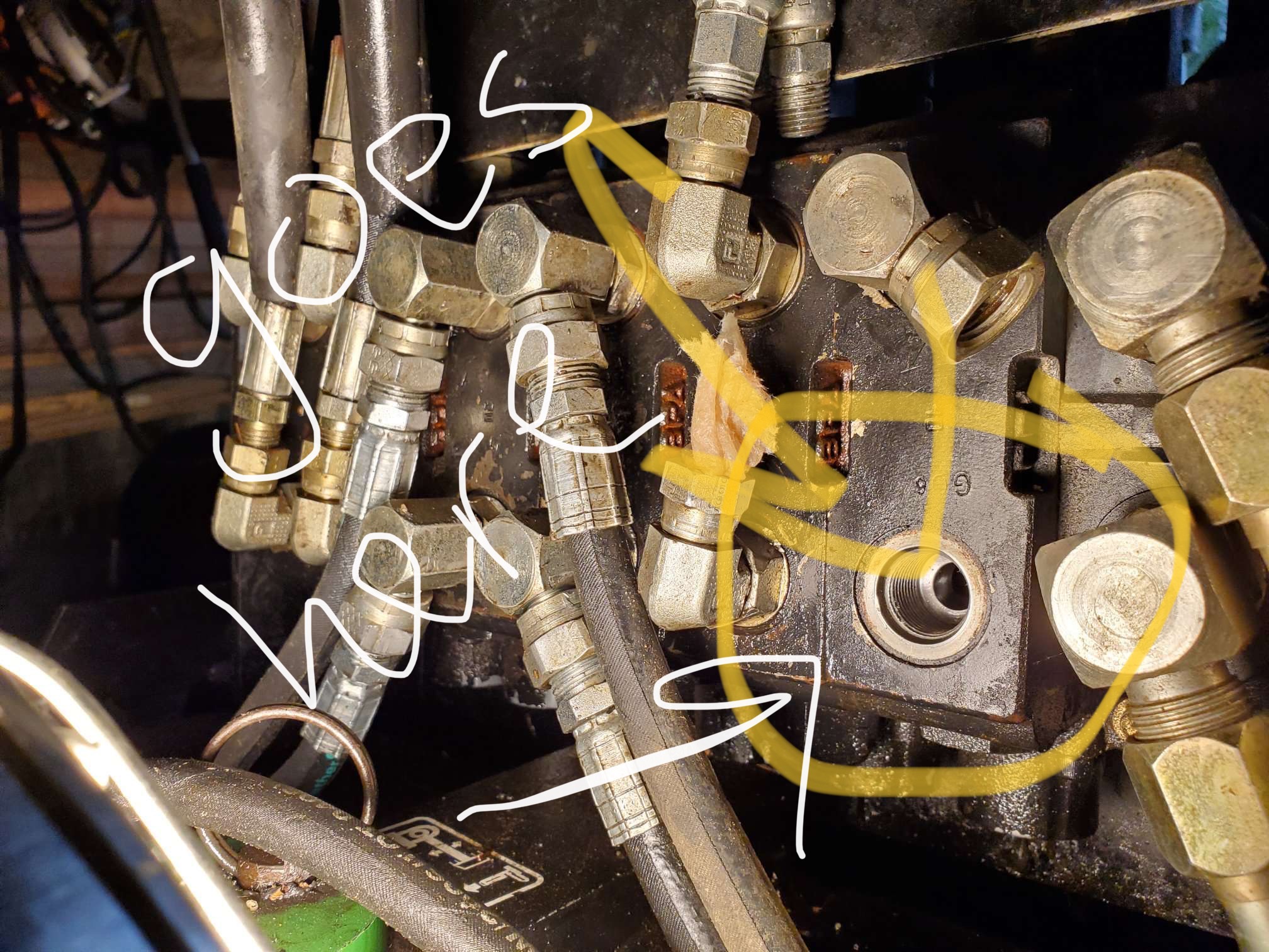

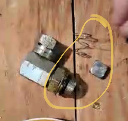

Hello all, I have a 2520 JD with the 46 backhoe and I am trying to find either the part name or part number for piece of the hydraulic block that allows the backhoe to swing left and right. Before I took it apart the backhoe would only swing one way and not the other. So I started tinkering... and I found the valve piece and it was in rough shape and now I just need the part to put it back in running order. The part is attached. I also need to know the order they back together in. Thank you 64D31310-236F-4F16-9841-BB315225882D.jpeg4D126173-6315-4E7D-9CD0-C3BBBE573759.jpeg

The part number for the elbow is AM123132. The spring & square piece do not show in the parts catalog.
Could those parts have been added later to slow the swing speed?

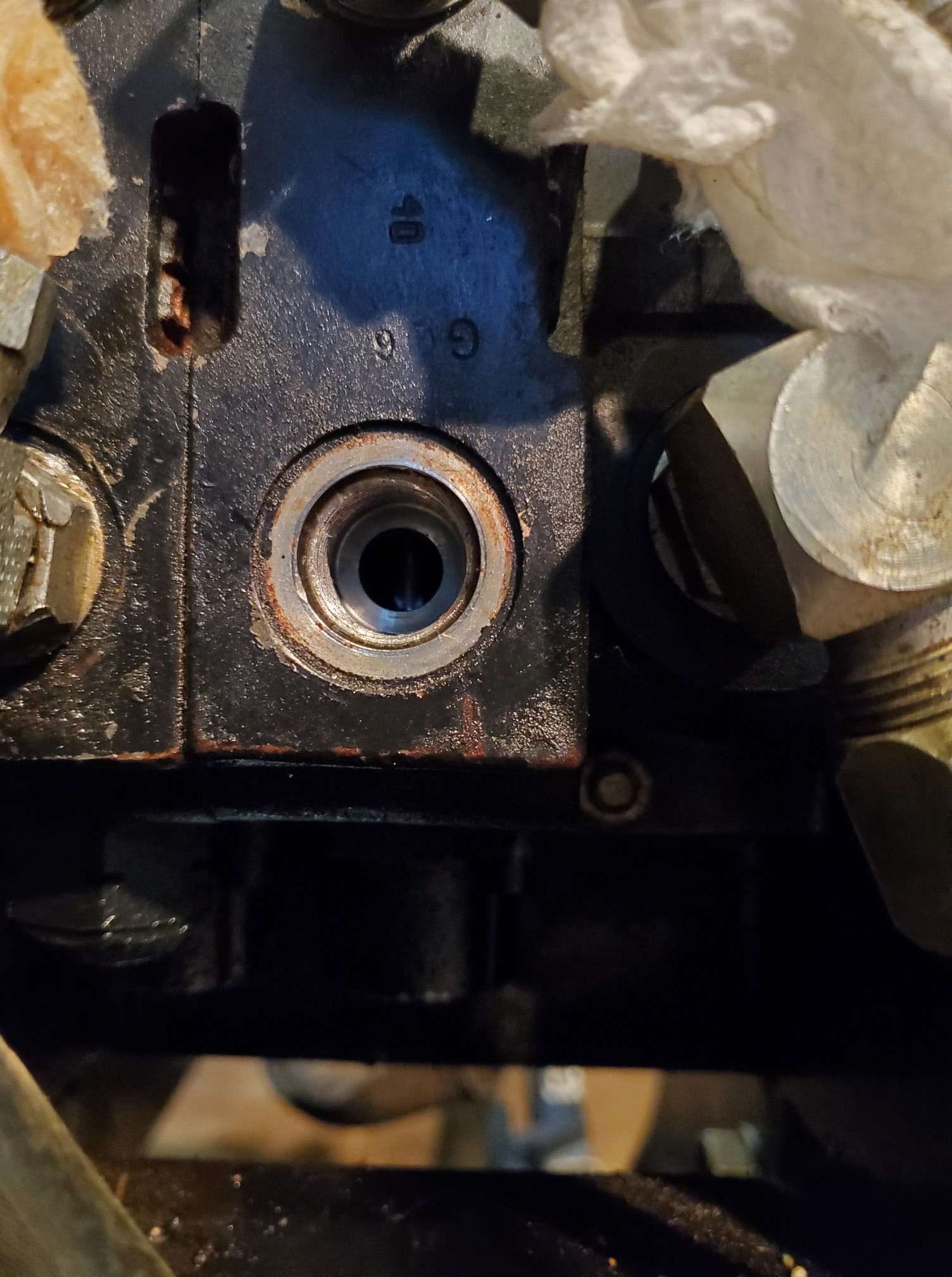

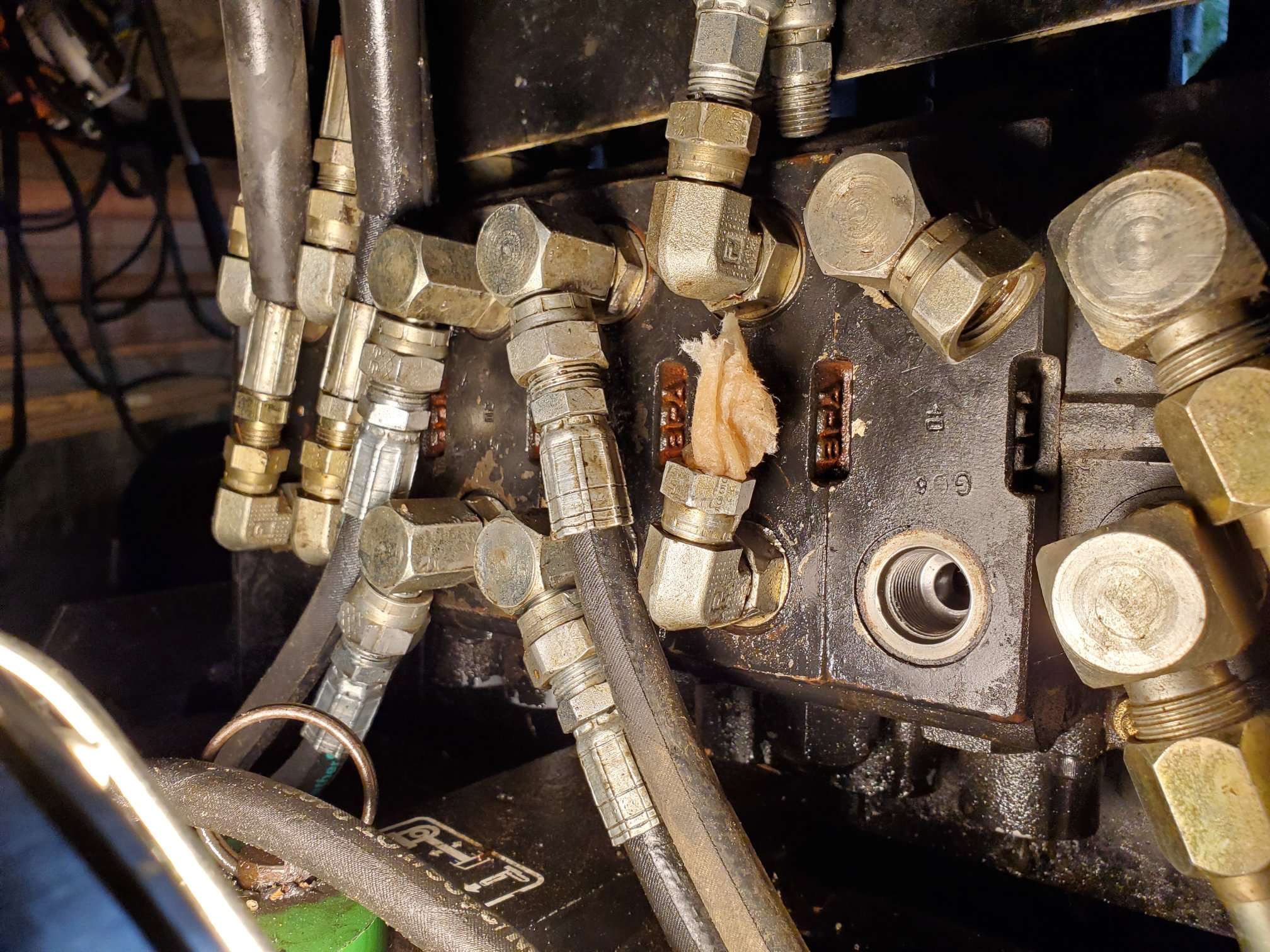

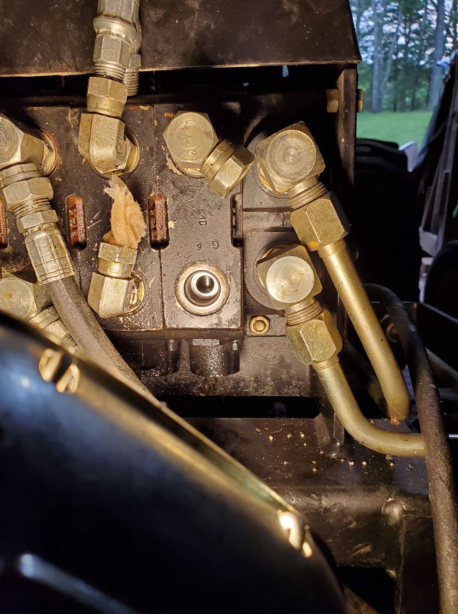

I am not sure if it is stock, looks like it belongs there. The initial problem was I could swing the bucket to one side without a problem but when I try to swing it back I got nothing. Here are a few pictures. 38C3C33B-5649-4D18-9773-365910955720.jpegF7113F9A-65C5-4DE9-BA34-EB7CD99C02DD.jpeg88690E6A-5E6D-4D2A-BC57-59C9CF8E149C.jpegE01D9639-3222-4914-AA13-B2D62AB0ECEC.jpeg
