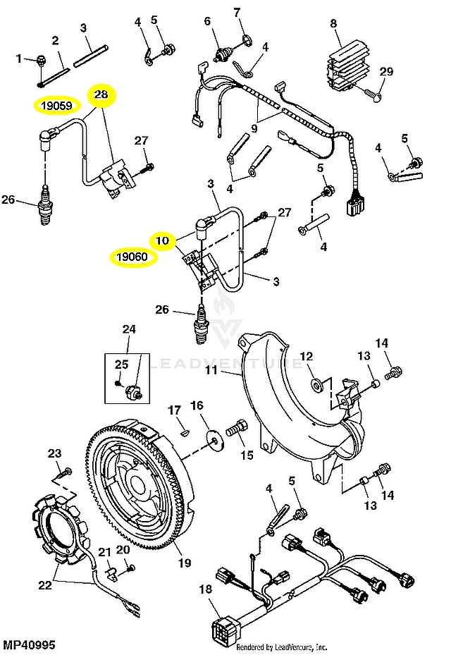

I think the coil on the left side as you sit in the tractor went bad. I'm trying to figure out the correct part number to replace it. On the deere parts diagram, there are 2 numbers AUC19059 and AUC19060. I ordered a replacement from Amazon (AUC19059) which didn't work. I figured they were the same on both sides but now I'm seeing discrepancy.
So which is cylinder 1, are the coils in fact different, and what part do I need for the left side as I sit in the seat but actually is a little further from the flywheel?
Thank you for helping clarify!

Neither part number connects to the x475. But both connect to models X7xx, like X739
But I think the left hand part is the AUC19060, by the looks of the parts as presented.

Did you use a parts manual to get the numbers? Engines can be oriented in any direction. Parts are typically shown from the flywheel side. The parts diagram below show the numbers 10 and 28 associated with the coils.

From what I have seen on the parts website, AUC19060 replaces M147359. And AUC19059 replaces M157358.
   / Deere x475 cylinder and coil
The coils are 1 and 10. From what I'm gathering, 10 is on the left side sitting on my tractor and is #2. The right side is slightly close to the flywheel so I think that's #1.

Ahh, you are right! On another schematic I saw the coils were 1 and 10. Apologies.
