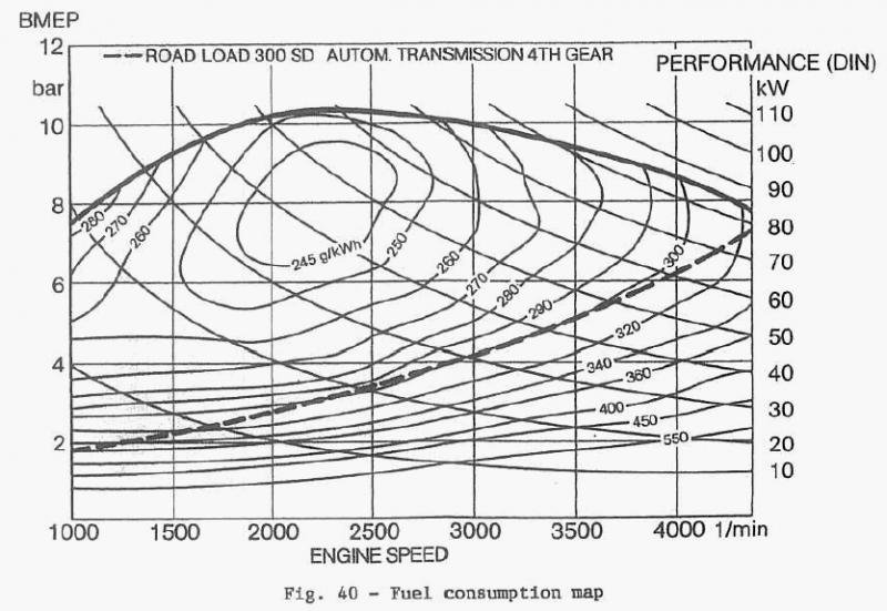

I mean, I know what you are saying. But that's old school thinking, we've solved the primary issues that led to your (valid) belief structure.
All engines and transmission combos are generally programmed with "downspeeding" in mind now. My F150 has a 10-speed transmission and tries to cruise down the road at under 1500rpm at all times. It will even run at just above 1000rpm at times. I generally let it - except on the highway I occasionally block 10th gear to avoiding it going high boost to maintain uphill speed.
Here's an example in the image below: Imagine needing a set amount of power to cruise down the road. Start on the right side of the BSFC plot. Let's choose an arbitrary power level, say 30 kW. As you can see, at high engine speed like 3500rpm, your engine efficiency performance would be roughly 350 grams of fuel per kW-hour. But if you upshift and now run that same 30kW load down at 2000rpm, your efficiency improves dramatically, now just consuming under 250 grams of fuel for the same kW-hour of work. The explanation behind this is pretty obvious, engines breathe better at higher loads, and internal frictional losses go up with engine speed. Running at lower rpm's is always more efficient. You just need to make sure you don't end up at the top line of 100% load, or induce excess vibrations, etc.

We work our old pre-emission tractors at a fast idle, usually 1000 to 1500 rpm.
It's very hard to find a utility tractor these days that is designed to run at a reasonable (low) RPM.
Most operating manuals say to run them close to full rated RPM.

Can I have some balsamic vinaigrette with that word salad?
