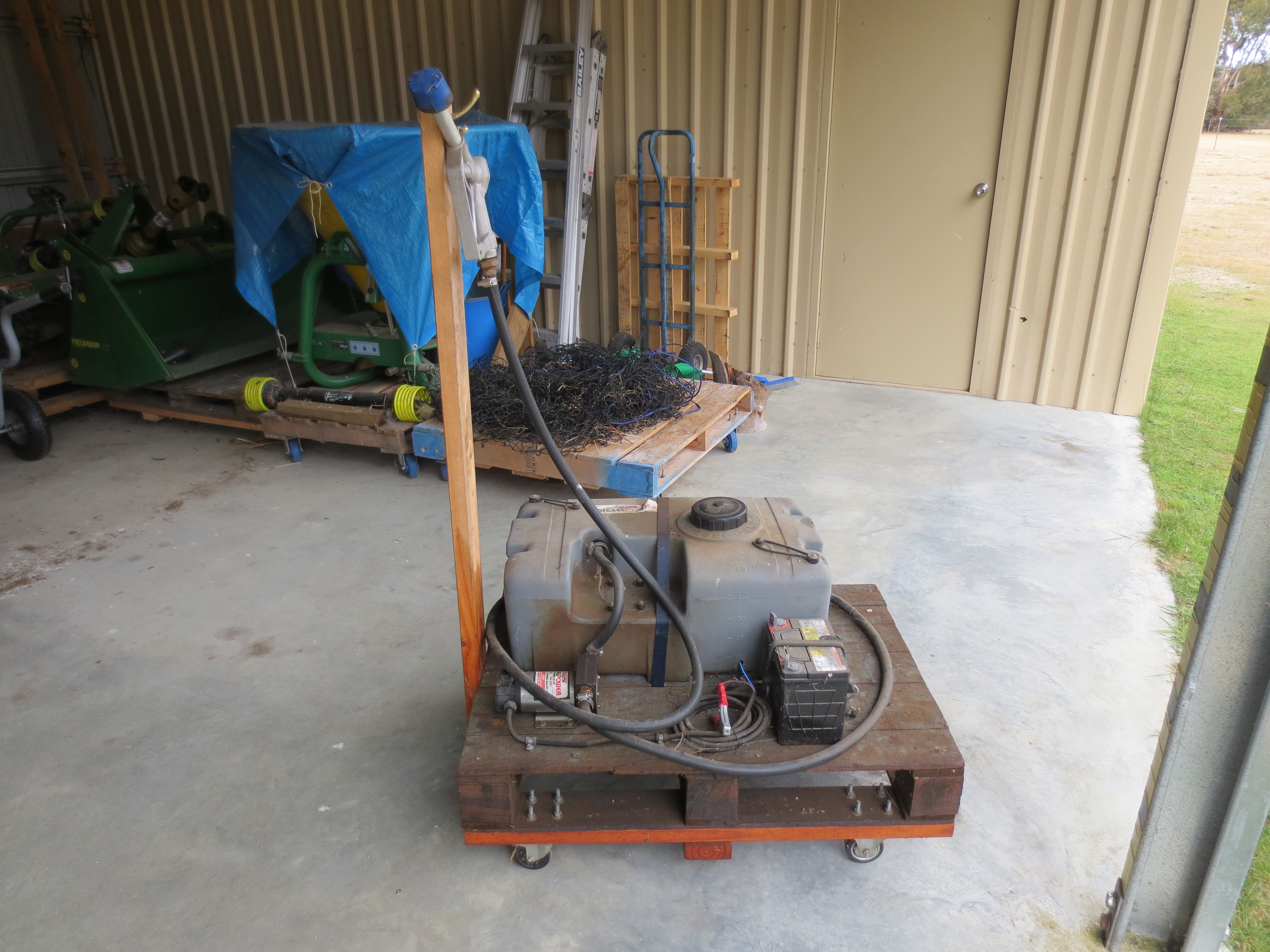

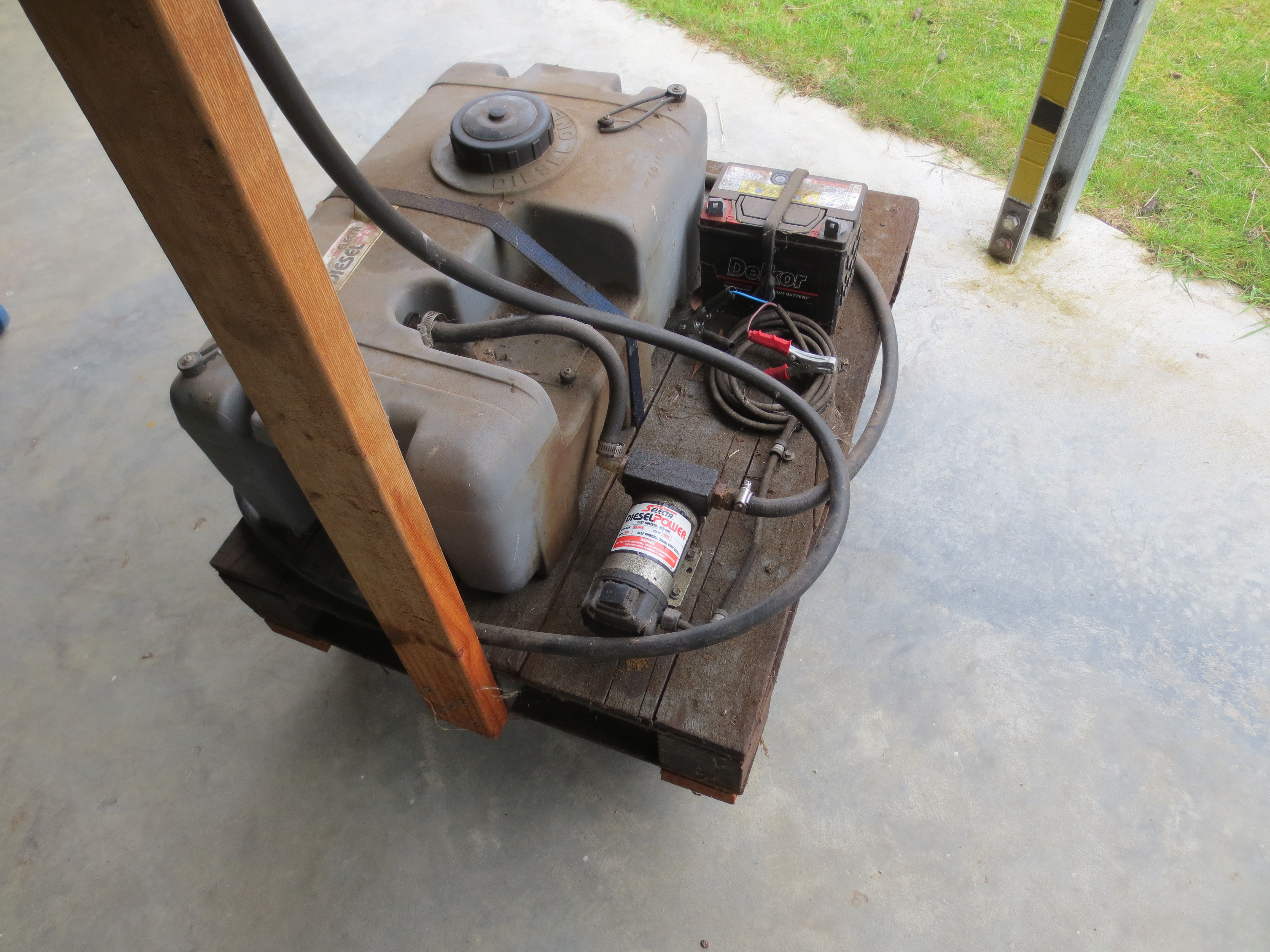

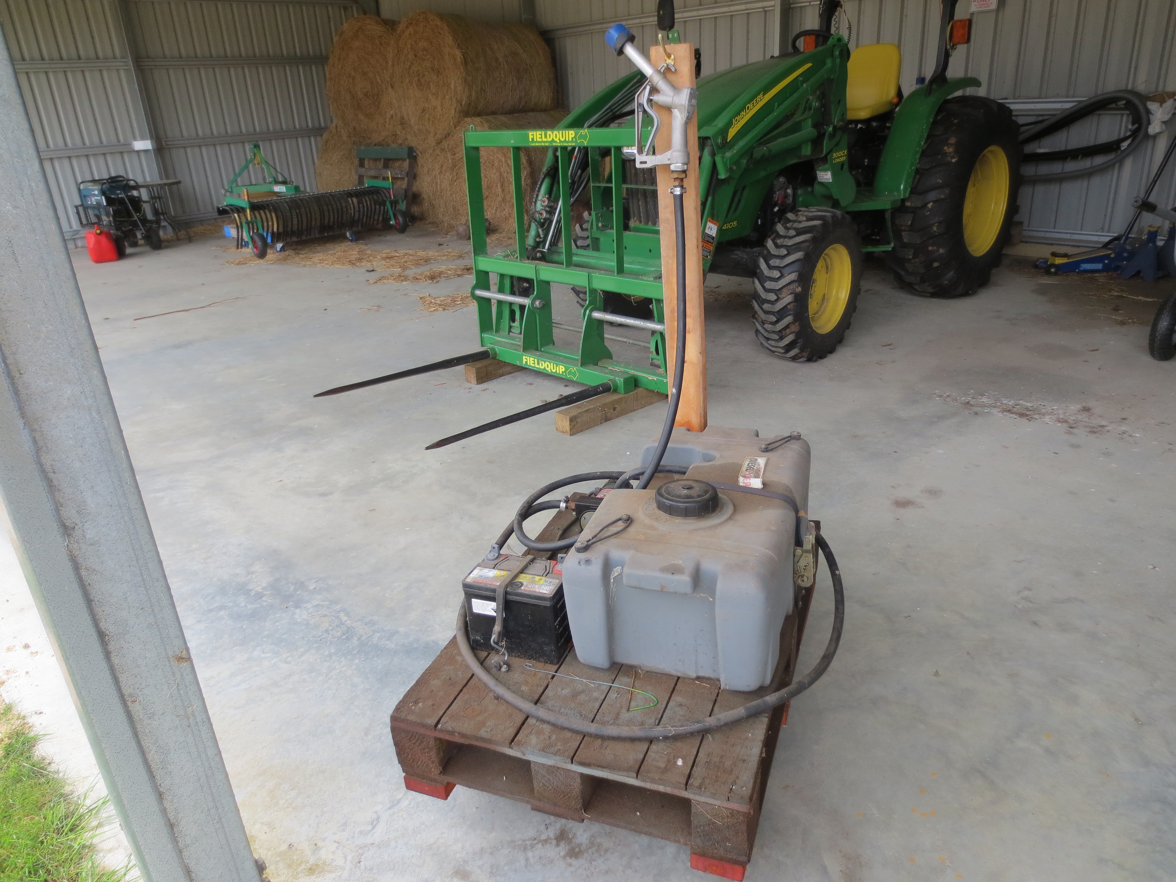

I've used a 100 litre (26 US Gallon) transfer tank since I bought my 4105, six years ago. It was included in the purchase deal, along with the implement 'package'.
I put it on a wheeled pallet and strapped its own 12V battery onto it. It works great and saves my back from hauling up a 20 litre jerry can to fill up the tractor (unless I'm 'in the field').
If you were to get that 26 Gallon tank, you could mount it on a pallet with ratchet straps and mount 4 lockable (roll/no-roll) pivotal wheels... that way you could lift it up, via pallet forks, into your ute bed.
