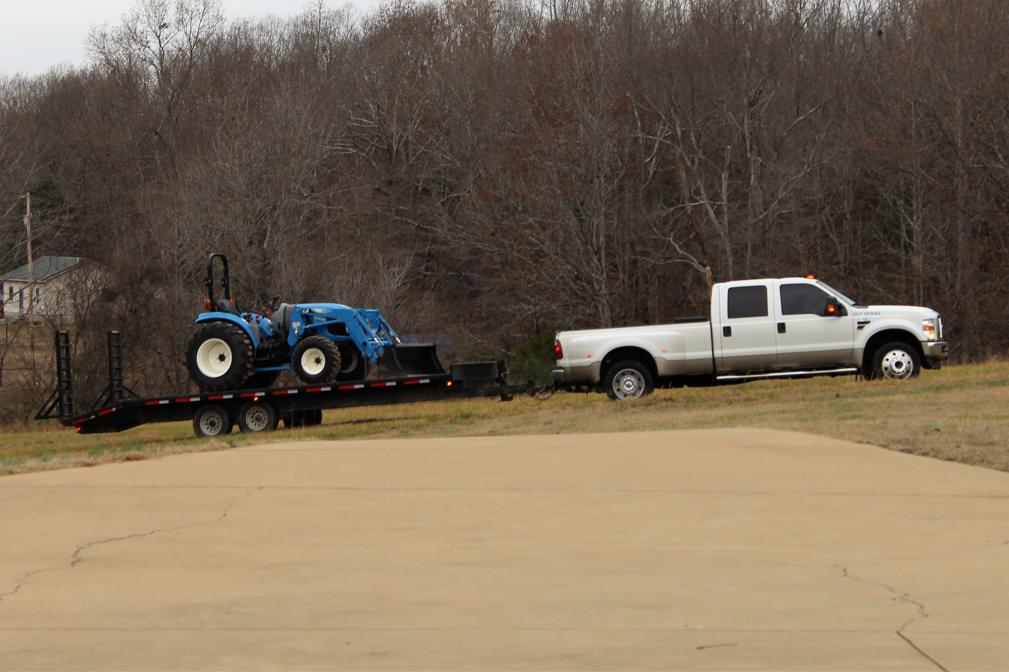

Happily took delivery of a XR4046 with loader yesterday. Plan on getting the 3rd function remote, grapple, bush hog, box blade for use on my 20 acres here and for deer plots off location (trailer) where we hunt. Looking forward to getting the property cleaned up around here. :thumbsup:

Looks like a nice rig;you have plenty of trailer too.
