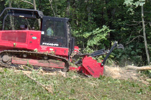

Landwise I sent you a PM about my machine that I will be selling. Anyone else who might be interested let me know. I know that this is not a sales board but if you guys do some homework you will know what I am selling. I can tell you now that it will do more work than two ASVs combined without the breakdowns.

I attached a little hint on the last post...hope you fellas can figure it out OK. I also know a finance company that is pretty sweet on the mulching business. They are back in Nashville TN (home for me). I am working in New Mexico right now and need a machine with loader arms to reach above the branches on the junipers. The branches are low to the ground and extend out about 8 feet from the trunk. The 140 will mow them like grass but the branches stay against the door glass and I can not see what I am cutting.
