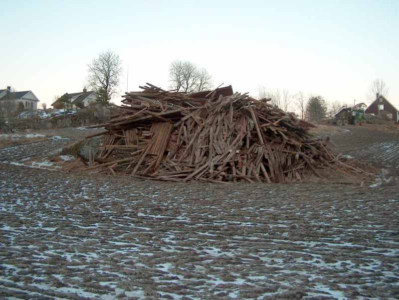

   / Demolishing a house...Best Option? #6
This is one way to do it!

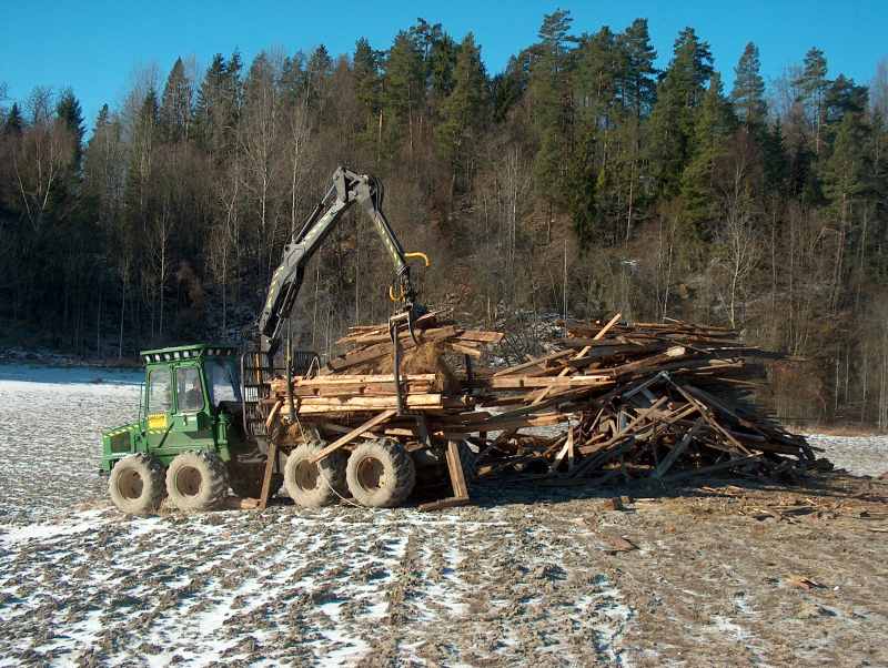

   / Demolishing a house...Best Option? #7
2

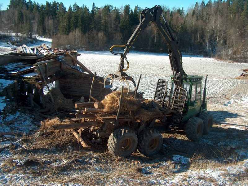

   / Demolishing a house...Best Option? #8
3

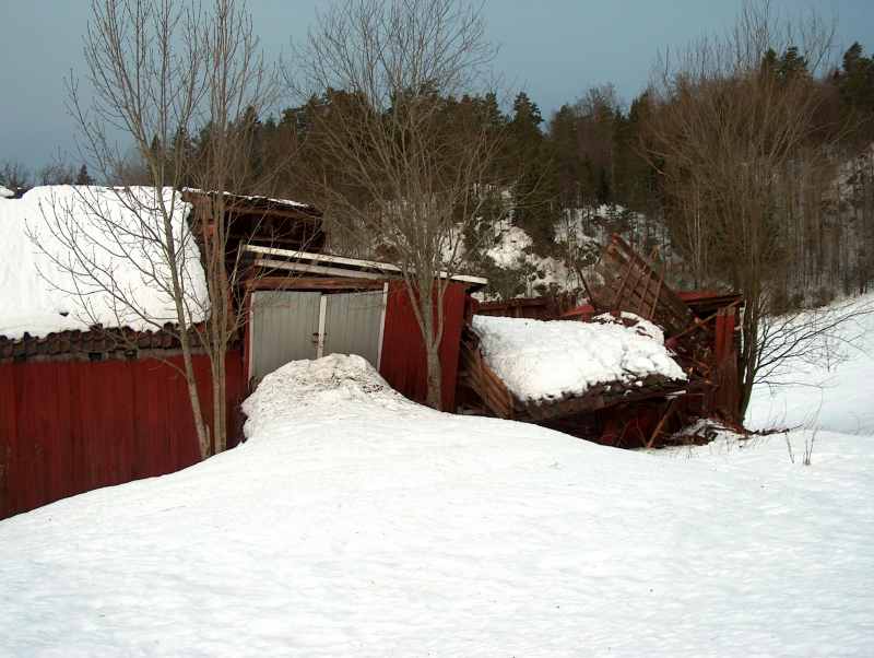

   / Demolishing a house...Best Option? #9
4

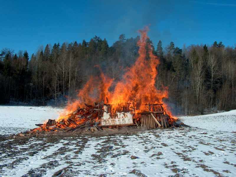

   / Demolishing a house...Best Option? #10
5
