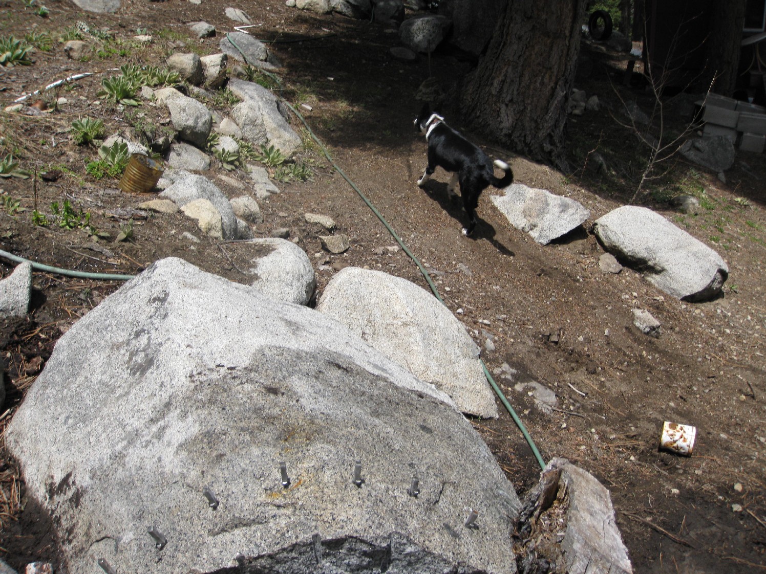

That is the information I needed. I'll get a Rotary Hammer for the job and order the Feathers and Wedges. I have been using hydraulic rams to move boulders this method will give a useful by product. I really appreciate and will make good use of the instructions and tips. I plan to pick up the drill motor today. Thankyou Richard
   / Demolition Hammer and Granite
#15
Take a look at this!
#16

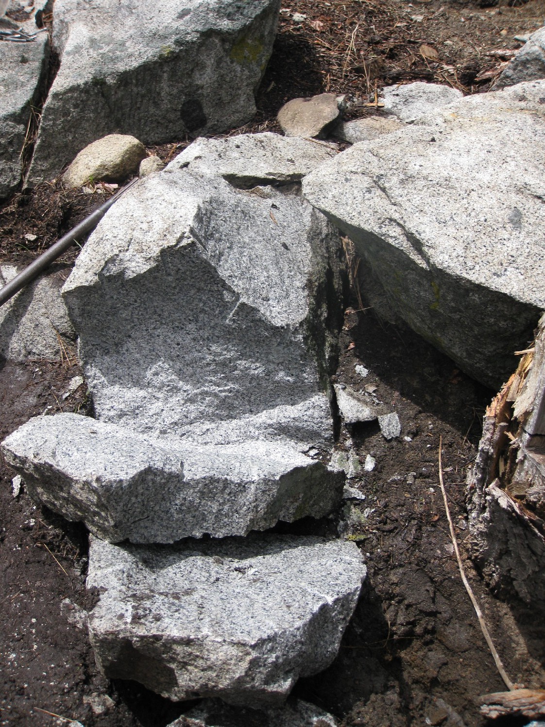

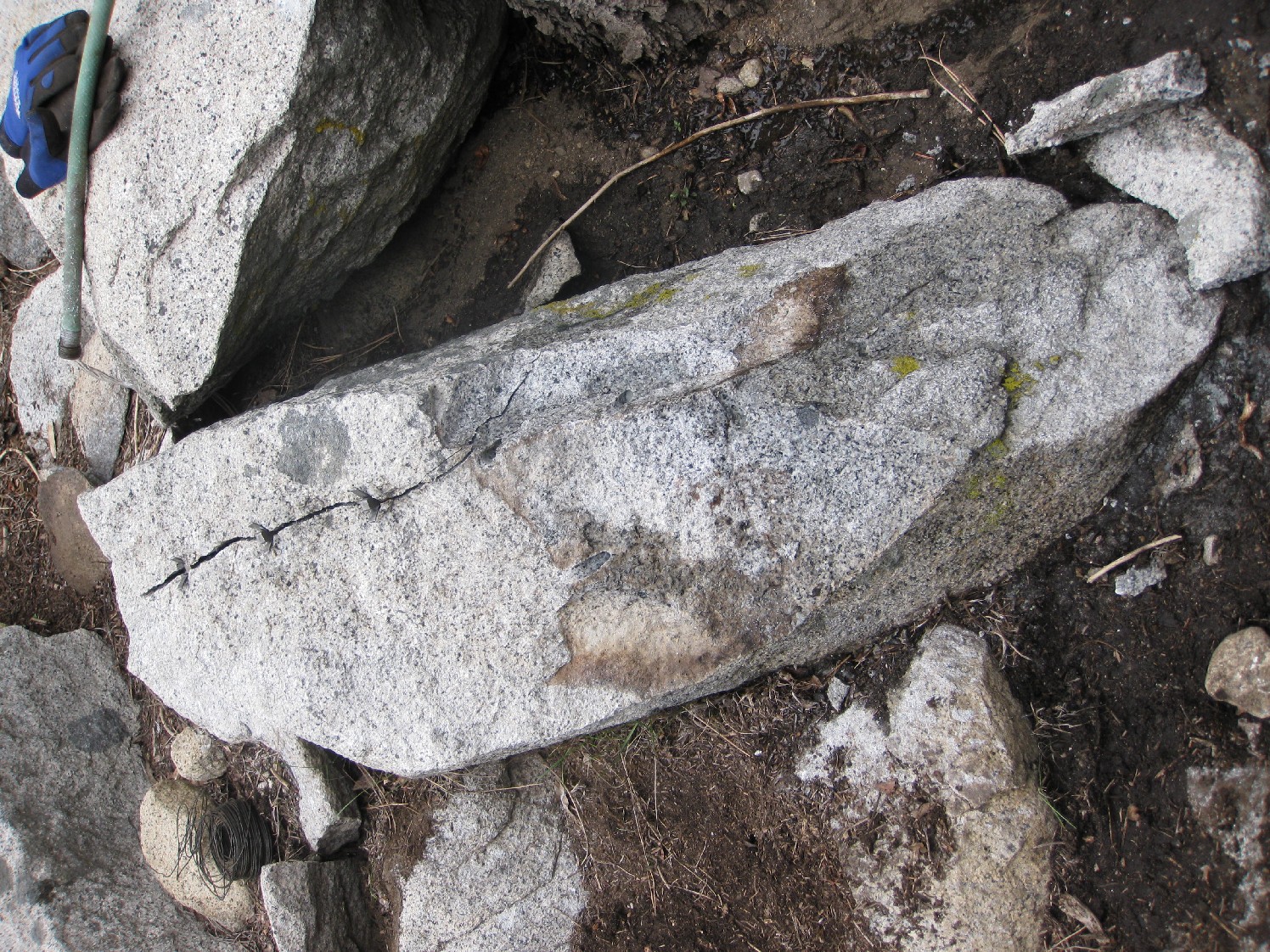

sliced them off like bread. Its thrilling when they split.

Glad things worked out for you.:thumbsup:
It is pleasing when the hammer stops ringing and goes thunk.:D
Now you are all set to give cobble granite sidewalks a go or?
