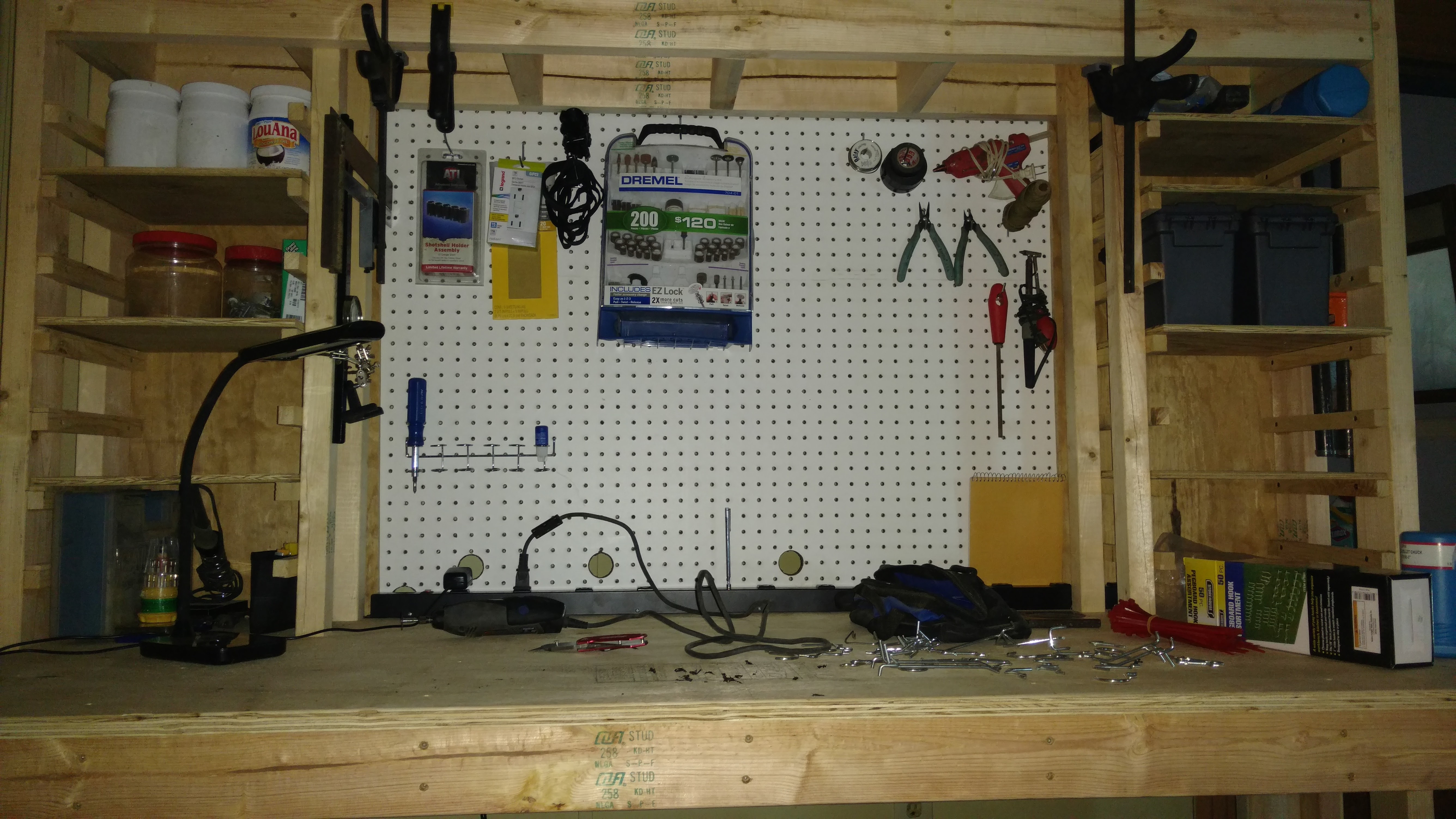

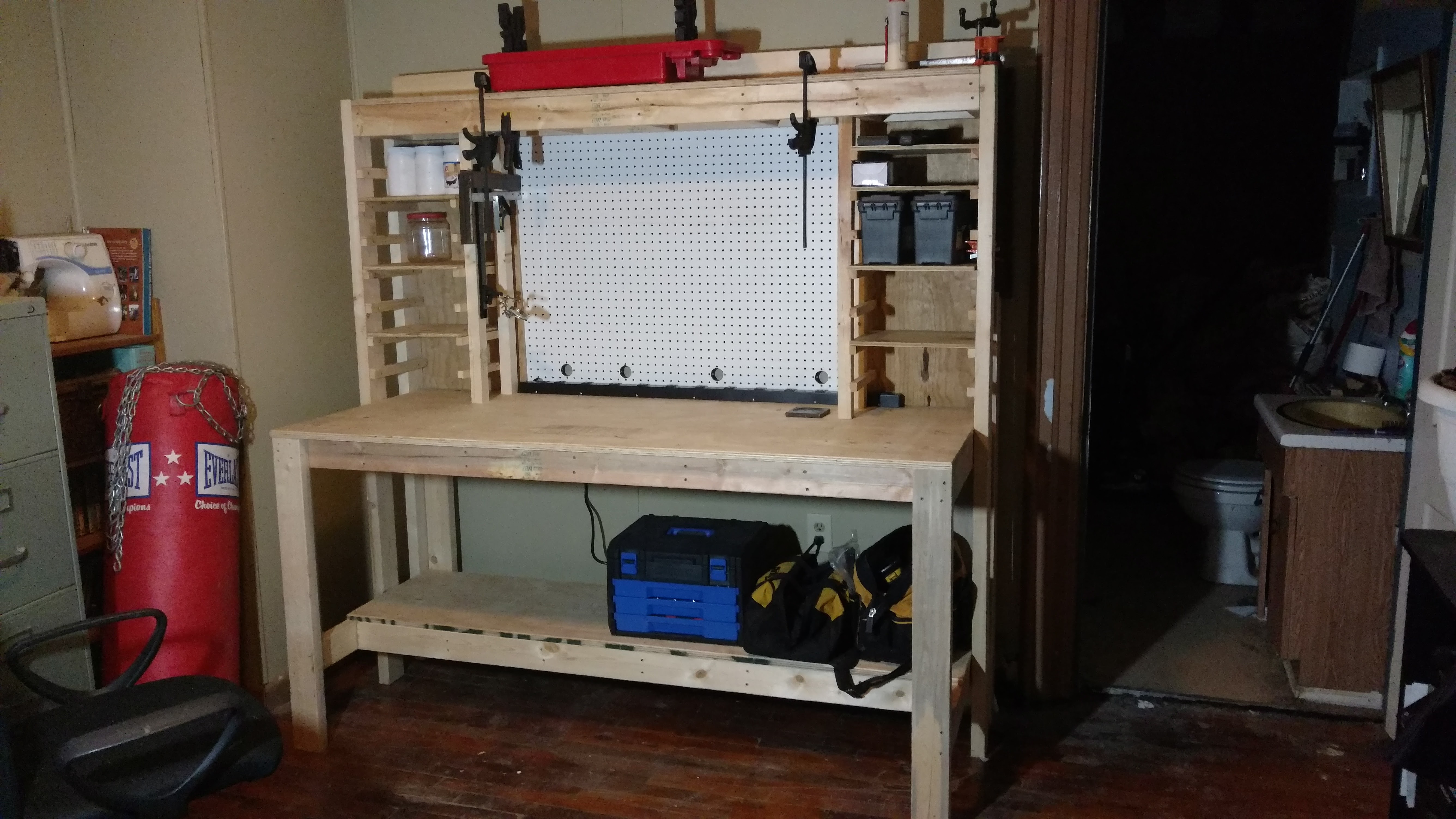

I found a pattern online for a 60"x 30" bench and it seems to work well for me so far. Still need to a reloading press or two and a vice, but I want make them interchangeable since they won't been needed all the time. This bench is in my office, so it'll be for lots of little projects in between work meetings (or when I just need to step away to clear my head). Not to mention my basement and barn work areas are not heated. Original design did not have the shelves. I added those and am still playing with organization and what tools/items I want to keep handy.
