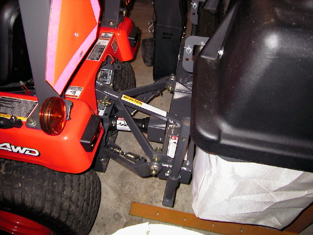

Mark,
I recently purchased the bagger for my BX2200 with a 54" deck. I've been meaning to write a review of it, but have been pretty busy. A poor excuse for not giving back to the board from which I have taken so much, so here goes.
My catcher fits the description that Jeff gave for the one he has on his B7500. Three bagger, gets it power from the rear PTO etc... Although it does use the three point hitch system it does not go up and down with raising and lowering the mower.
What you do is remove the lifting arms that attach the hydo actuator to the draw bars (if my three point lingo is off, forgive me). Now the draw bars simply act as pivot points. Remove your top link, connect the bagger to the draw bars (it has stands built in) and tip the whole thing forward. There is a "T" bar that engages into the ears where the top link goes.
It is s real bear to connect. And takes two people and coaxing from a mallet to get the top link pin in. I put mine on two months ago and have yet to take it off. I even mowed for a while without the grass tube connected as I bought the thing to pick up leaves, not grass.

OK, I took the time and the pictures!
Here is a picture of how the BX Bagger attaches to the 3pt. hitch. Notice the missing connecting bars that normally go from the actuator to the lift arms.

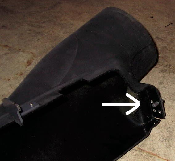

   / Describe the grass collection system #10
Here is a picture of the chute that mates to the 54" deck. The arrow points to a pin that mates to a hole that you need to drill in the deck.
