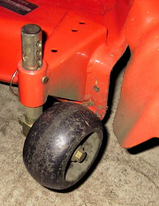

Here is a picture of the hole you need to drill in the deck. Instead of putting it where the instuctions tell you to. I would use the factory measurement for the vertical positioning...

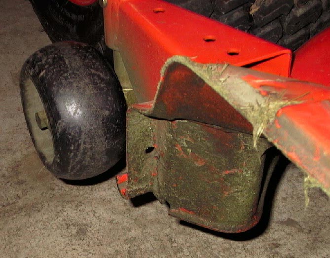

and base your horizontal positioning on where the hole will wind up on the inside. I didn't want to break the weld in the ridge where the two pieces of the deck meet on the inside. I think you can see that in this picture. FYI I was holding the deflector up with one hand when I took this picture.

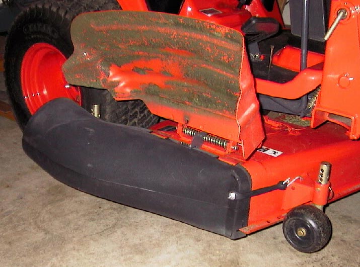

Here is a picture of the chute connected. It is held on with a rubber strap, the hook of which goes into an existing hole that you simply widen with the same bit used to drill the hole for the pin.
