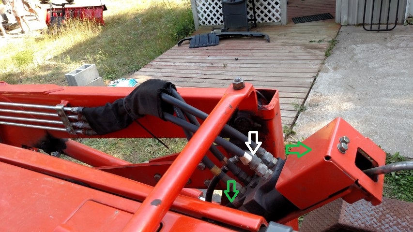

Now for the reason for the revival, my dad's L3710. Since there is a grapple (mine) available for borrowing, my dad suddenly wants hydraulics too. I figured he would go with a diverter like mine, and life would be simple.
Looking at his hydraulics though, I think there is an easier way.
See attached picture of the valve/hose area. I should be able to insert an open center, single spool, lever style "cylinder" valve. Right?
Either the green arrow or the white arrow hose must be going back to tank. As such, I could move it to the new valve, and make a short hose from the old valve to supply the new valve.
All that sound reasonable?
I'd like to mount it where the other green (was supposed to be a different color) arrow points.
A valve like this seems to fit the bill, but I wish the lever came out of it from the end, instead of from the top.
1 SPOOL 12 GPM WALVOIL SD5 CONTROL VALVE
Any ideas? Is my thinking correct on the hydraulics?

Your loader valve should have PB adapter installed to add another valve and the grapple valve should have PB also.
So your flow path should be like this, pump to loader valve, to grapple valve, to hyd blk and then to the rear, maybe remote, or 3pt, to tank.
All return/tank lines go to tank.
/ Design-your-own 3rd Function #28
...A valve like this seems to fit the bill, but I wish the lever came out of it from the end, instead of from the top...
The handle will thread in 90* from the shown position which makes it stick up...
I made my own extended handle that is easier to reach from the seat...

Is PB different than open center?
From everything JJ said, my original thought/plan sounds correct, but I'm thrown by the power beyond comments.
From this, it seems it's just a term for adding another circuit to the "pressure loop".

PB stands for power beyond and is used in open center hyd system to pass high pressure fluid to the next valve.
The tank line or return line can not handle the high pressure, so the PB adapter is used to safely pass the fluid downstream.
All open center valves should be in series and have PB except the last valve, and on most tractors, that is the 3pt.
The two lever auto valve you indicated is used to setup and do a complete cycle on the cyl/log. Once you set the levers, the cyl will extend fully and retract and then return to neutral.
