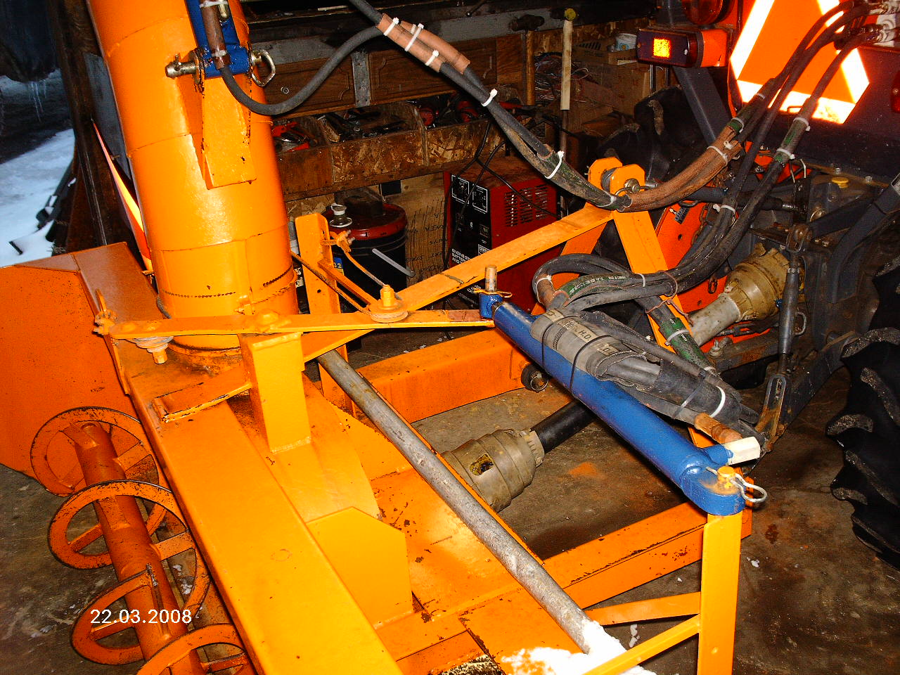

hello all,
I am trying to modify a three point rear mounted snowblower so that i can use hydraulic or electric power to rotate the chute instead of moving it manually. Does anyone have pictures of this type of mechanism on on a commercially built snow blower or have ideas about something they may have created themselves.
   / designing a mechanical means to turn a snow blower chute #2

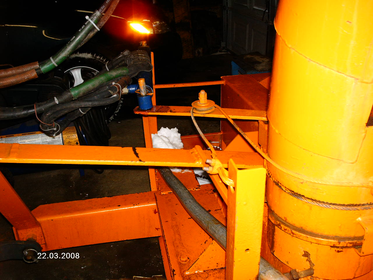

Here's my homemade hydraulic setup. I used a cylinder that I had laying around doing nothing. Works great!

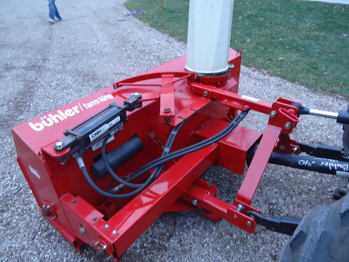

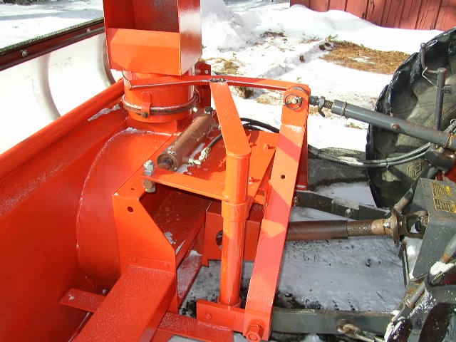

The left picture is one I made - the cable rides on a curved piece very close to the chute. The cable wraps around the chute with the ends tied off. Same idea as Farm King (Allied, Buhler) - right 2 pics. Cable length stays constant through the travel.

Thanks for the info. As someone who has done a lot of metalworking, you did a really nice job! good pictures also.
