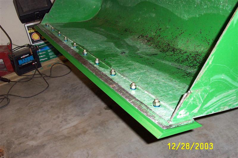

Well I got the cutting edge put on my 430 FEL bucket.
It wasn't quite as bad as I thought to drill the holes as
the steel is softer than I anticipated. I drilled 1/4 inch pilot
holes and then drilled the 1/2 inch holes. I ended up dulling
three 1/2 inch bits, one that I had and a third that I bought.
