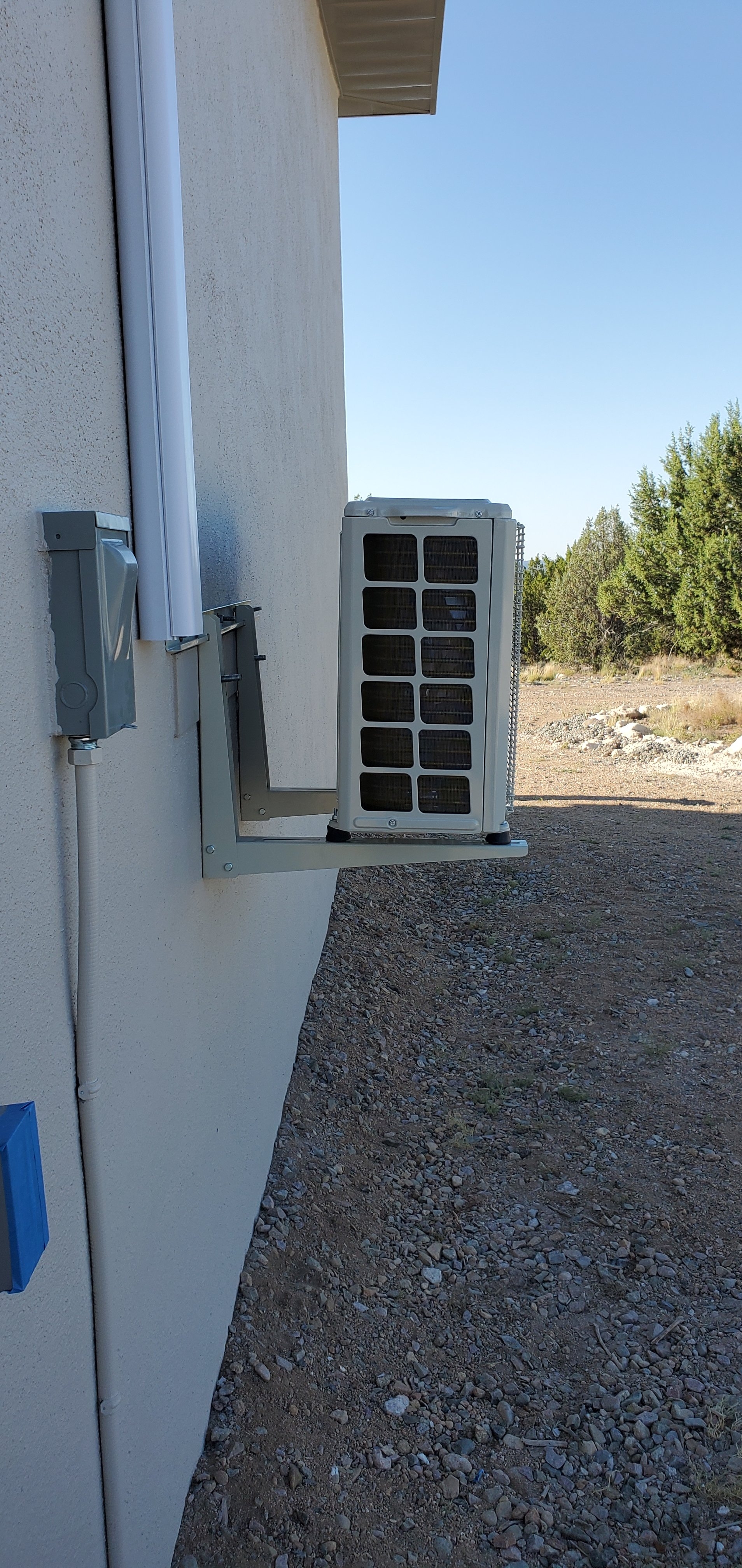

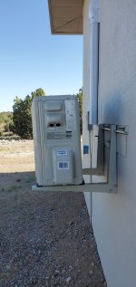

The mini was installed but the rubber bushings it sits on pits a slight tilt to the unit. I measured and it's about a 1/8 - 1/4 inch tilt. The AC guy said it's fine but just wondering if having a slight tilt will cause any issues?

I'm not an expert but I would level it. The crew that installed mine took great care make sure it was level. They used washers for shims under the rubber feet to get it level.

^ Mini split refrigerant lines rely on flare connections. All this is just my personal opinion, but I made sure my mini splits were installed to reduce the chance of vibrations loosing the flare connections so the refrigerant doesn't leak out. With your compressor visibly tilted like that, you'd want to be careful about not loosening, kinking or damaging the lines while trying to level the compressor. You may want to check whether the linesets are maybe a little too long causing the unit to be tilted and/or try to determine why else it is tilted (something related to the mounting brackets?) and how to correct this without causing a leak.

I double checked. The bracket is level and the lineset is not in the way. It's the rubber bushings and attachments points on the condenser that make it tilt.
I'll see if I can shim it level
   / Detached Garage - Ductless MiniSplit #27
It is ok if the concrete pad slopes, but not the actual unit itself. I think that you really, really want it level for the best compressor lifetimes.
I would shim the unit with something that won't move or compress, or buy different vibration isolators.

I got some metal U-shape shims at HF and got the compressor level. It's now less than 1/8th of an inch slope which is fine. Being it has rubber mounts, it changes by 1/8th of an inch with temperature, movement, etc.

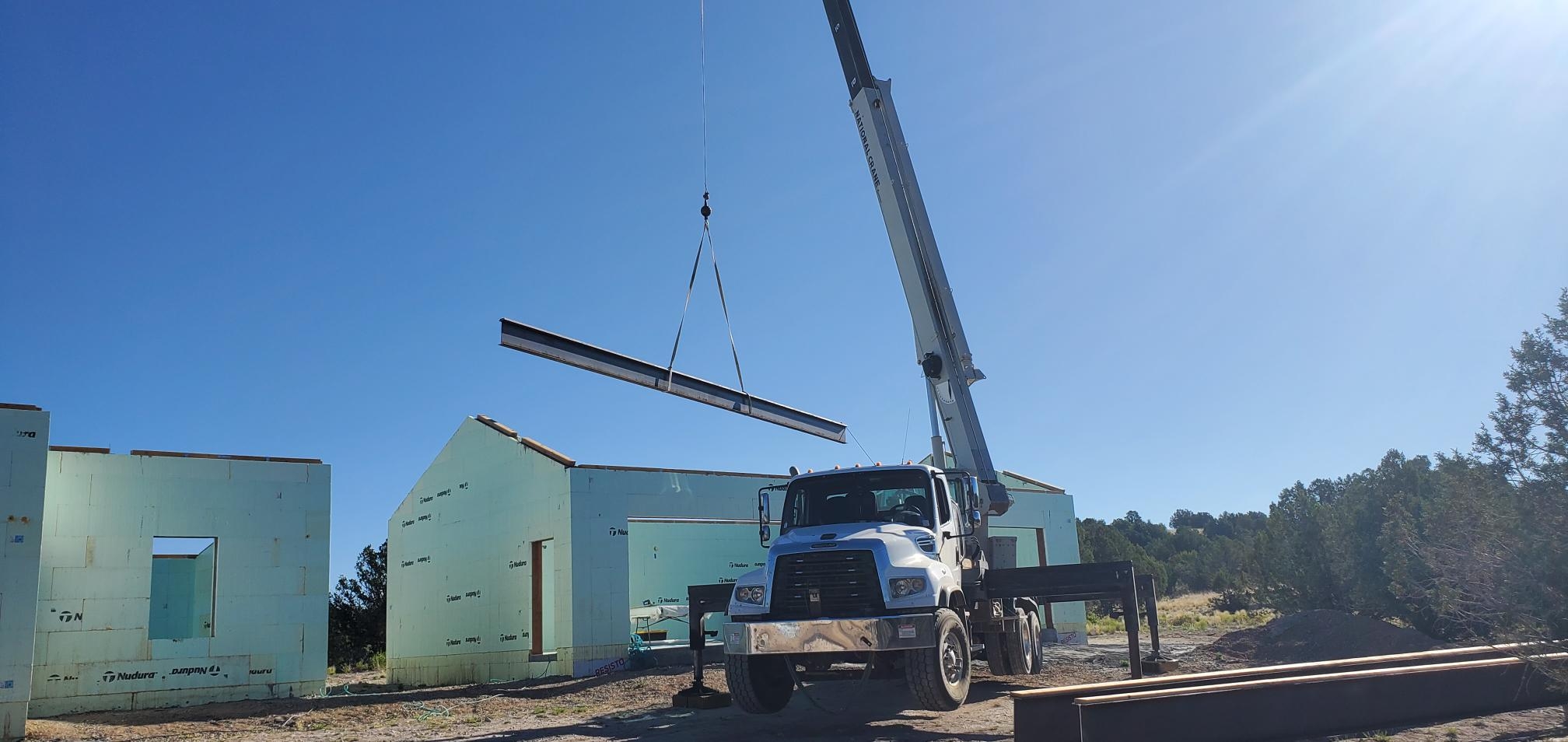

Span is 48 feet.
Beam is 21" tall x 6.50" wide with a thickness of 0.45 at the top and bottom plates and a web thickness of 0.35. Yield strength of 36,000 psi. The beams weighed 2,110 pounds per beam. Price was about the same at $2,200 per beam.
Steel plates were embedded into the wet concrete during the wall pour. The beams rest on these steel plates and were welded down to the steel plates.
View attachment 873926View attachment 873928
Why did you use these long beams instead of relatively short trusses running front-to-back? You'd still have the same clear span / open floorspace. Just trying to understand the construction philosophy. Thanks.
