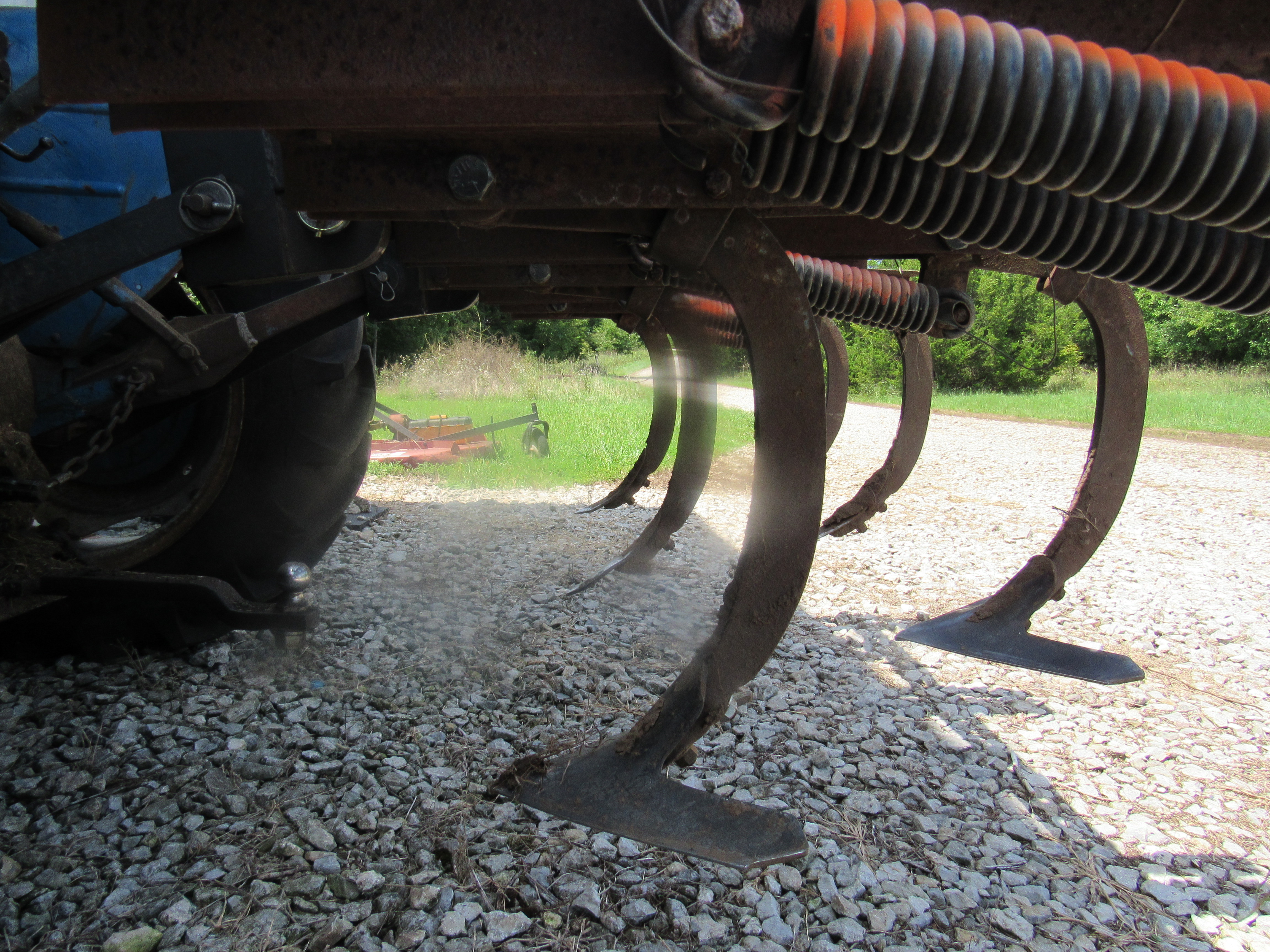

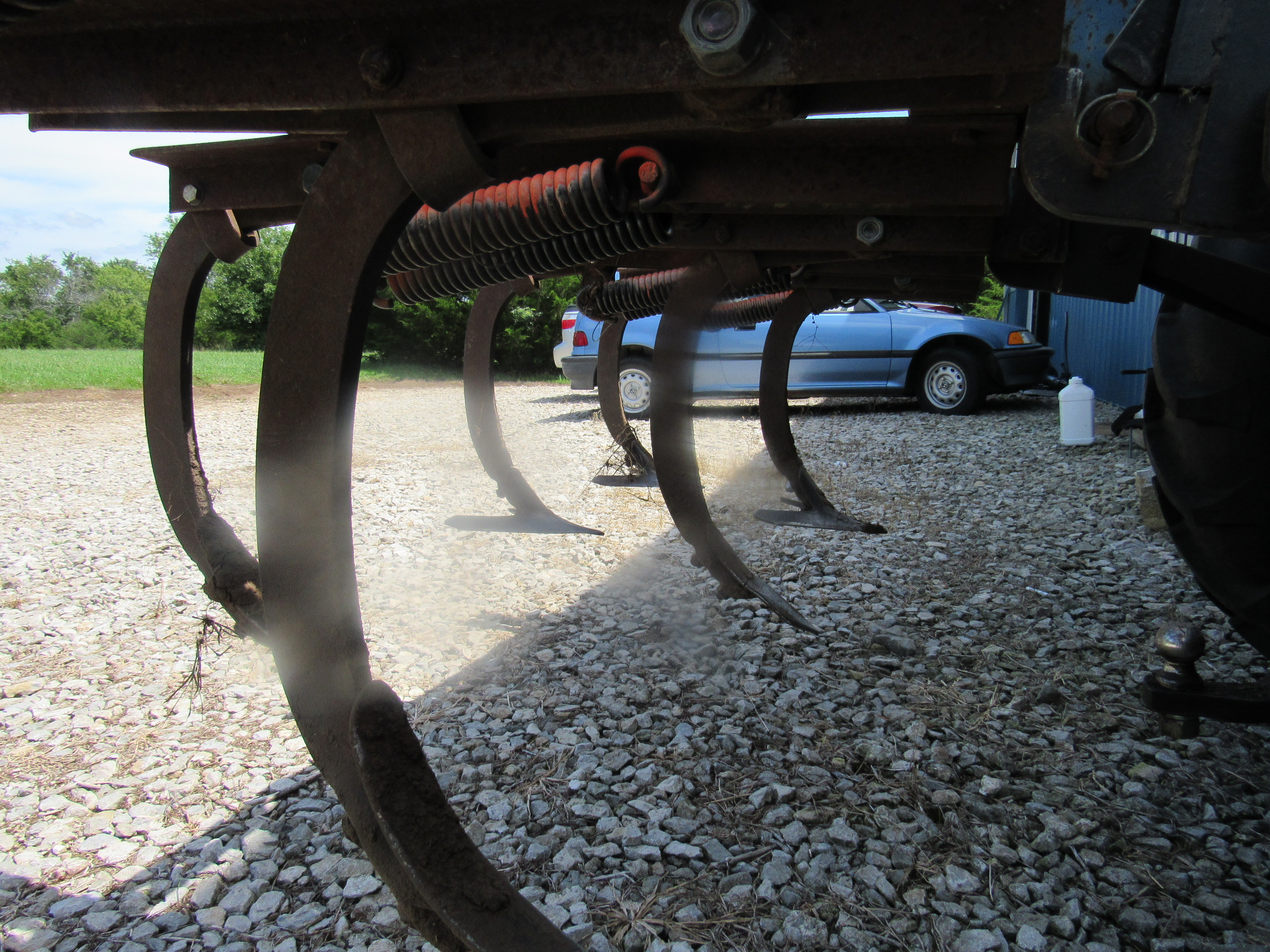

   / Determine SWEEPS for DIRT DOG 'ALL PURPOSE PLOW' / FIELD CULTIVATOR #17
IMG_0363.JPGIMG_0360.JPGIMG_0358.JPGIMG_0363.JPGIMG_0360.JPGIMG_0358.JPGIMG_0363.JPGIMG_0360.JPGIMG_0358.JPG
I found some 47 degree sweeps at Tractor Supply that matched up to my Fred Cain (I think) cultivator that I think would work on all these standard style cultivators. They are the 10 inch wide ones, about $7 a piece. The holes were about 2 inches apart but my unit has a round hole and a slot so its pretty adjustable. Worked pretty well on old food plots. I think it will save me a lot of time and effort getting food plots ready. Sorry about the multiple duplicate photos....
