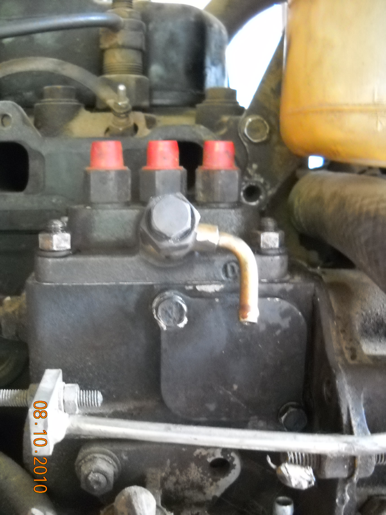

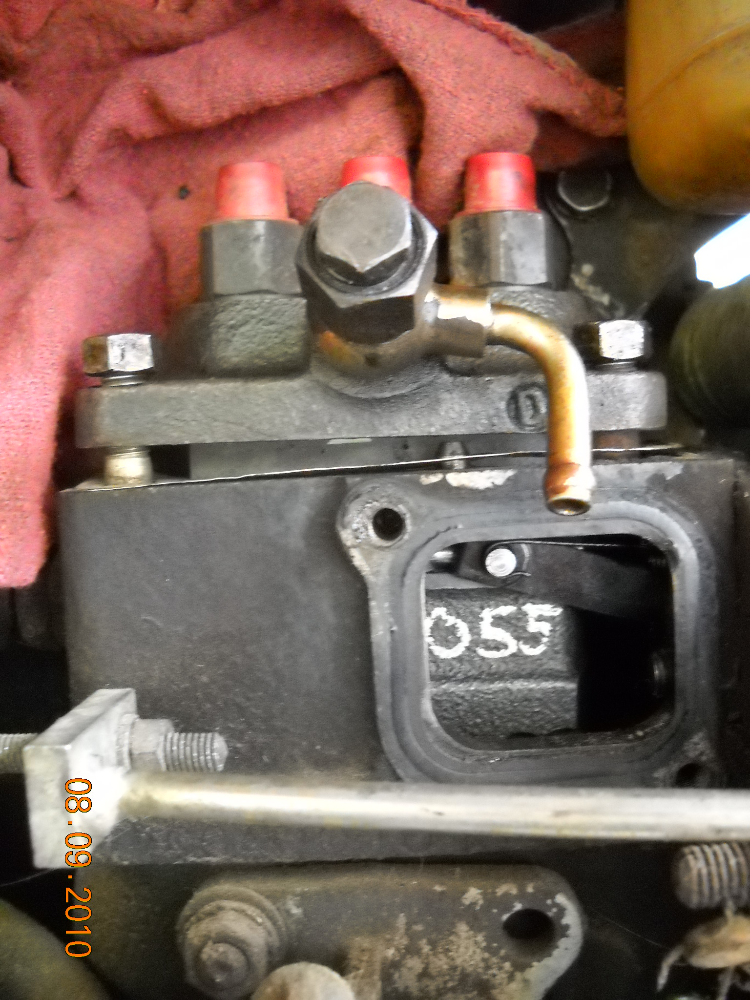

Any links on where to find the adjustment on that type of injection pump. The above links only offer very basic information, I already know engine building by calculating displacement, compression ratios and volumetric efficiency. I am a oil burner mechanic, gasfitter, plumber and locksmith so I just need some links to those actual parts. I agree, love that internet everytime I work on someones vehicle, the internet can tell you what is wrong and how to fix it without even looking at it. Just can't seem to find anything on the 5215. Thanks everybody, every little tidbit of info helps with the bigger picture.
   / deutz allis 5215, Don't laugh #10
Is this what your injection pump looks like? it is one of a kind. You cant put in a bigger one or even find another one with ease. I do have a source for a new one but it costs some $600. Plus you have to send in the old pump or you add $100 to that. Just speaking from experiences with my fuel injection pump.
